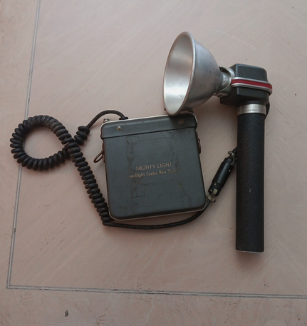

Excerpt from Arthur Lubow's biography of Diane Arbus: "Arbus had borrowed, probably in 1964, a Mighty Lite hand-held flash from the photographer Larry Fink, another former student of Model; she kept it for the rest of her life.
So not only can we confirm the Might Lite, we now know where she got it from 🙂.
... and we have a real good idea of where it is currently. See Post #8.
At the head of this article is a photo of Larry Fink with a Mamiya TLR and the same type of flash unit, possibly the exact same one. https://www.vanityfair.com/style/2023/11/a-fond-farewell-to-photographer-larry-fink
It's a little melancholy or something, one imagines him lending the flash to his fellow-student (Fink would have been beginning his career, he was quite a bit younger than Arbus), getting it back after her untimely death, and holding onto it for 40 years until donating it to the Met, perhaps while trimming down his own possessions.
One of the Mighty Lights on Ebay had a GN chart taped to it. GN for ISO 125 was 160
