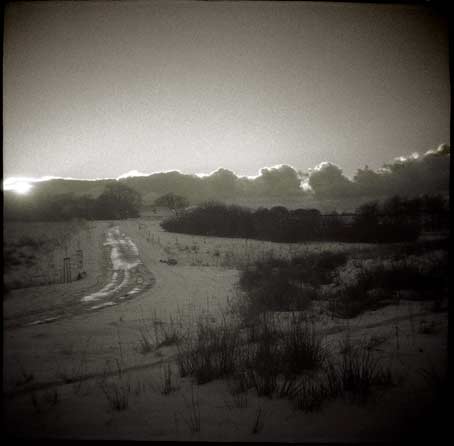

the attached image was taken a winter day, using Ilford 3200 rated as about 12500iso..
I had an orange filter in front of the lens..
developed in Rodinal 1:25 for about 18min..
DIANA RULES!

Man, that's gorgeous shot... I got butterflies in my stomach! :surprised:
