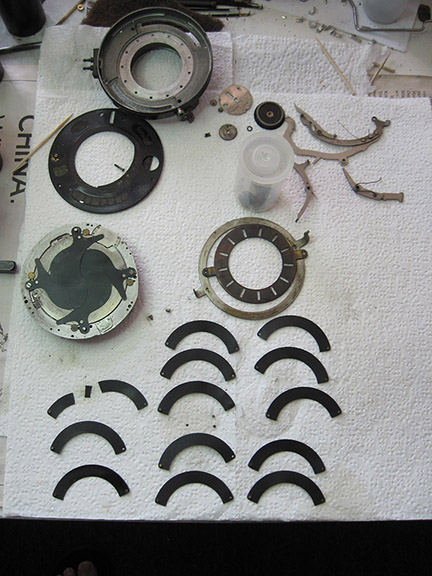

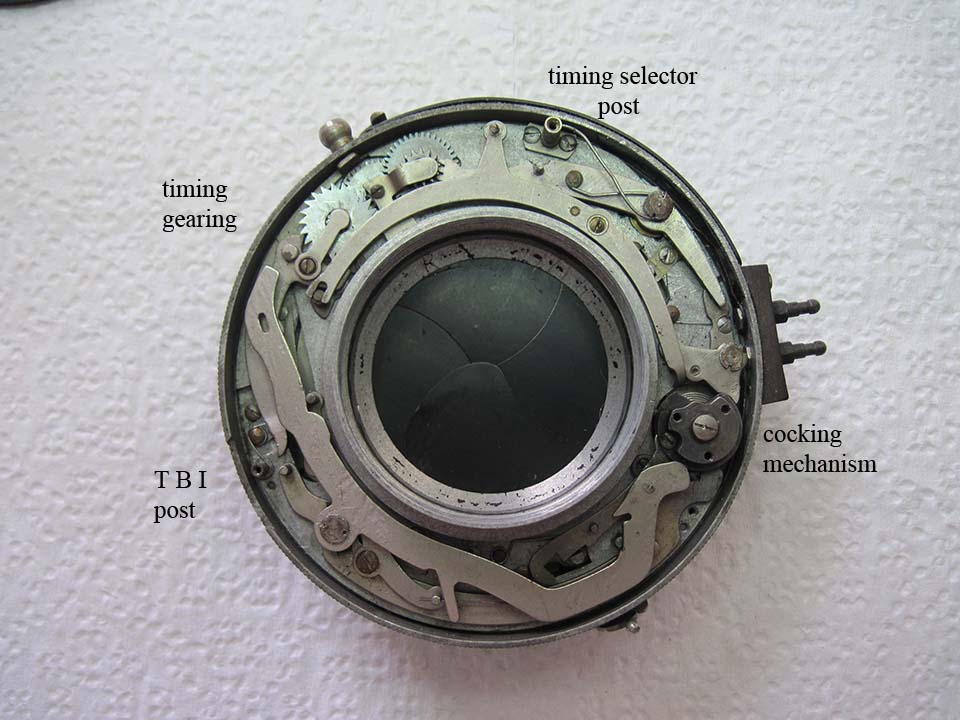

I have serviced a few Compur shutters. Start by putting the shutter in a released state, speed at its fastest position, and the IBT selector at T. Remove the cocking lever screws and the cocking lever. Remove the speed dial screw. Carefully lift off the speed dial cover then the various plates under it paying close attention to the position and order of the plates. Remove the IBT selector and wave washer. Pay attention to position of the washers. Remove the screws holding the front cover on then remove the cover. Remove the springs and levers from inside the shutter as needed to insure through cleaning and removal of the main plate from the case. The main case screws are on the back of the shutter case.
Take pictures as you go both before and after removing a part.
This poor shutter had a broken aperture blade. Blades are lacquered paper and had swollen causing binding.

Shutterfinger,
Wow, those are some great pictures of the shutter taken apart. Plenty of fun inside there for sure.
Looks like I can use the information to try this on my own. A great project and worth it to get this camera working properly.
