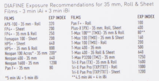

New emlustiona are thinner, which means you do get the speed increase that we did in the 70s and early 80s. My old box of Dianfine recommends Trix at 2400, the new data sheet is 1600, while Tax 400 a very thin emulsion 500. Delta 400 is 320.
loccdor
Jan 12, 2024
1,595
USA
From the current product

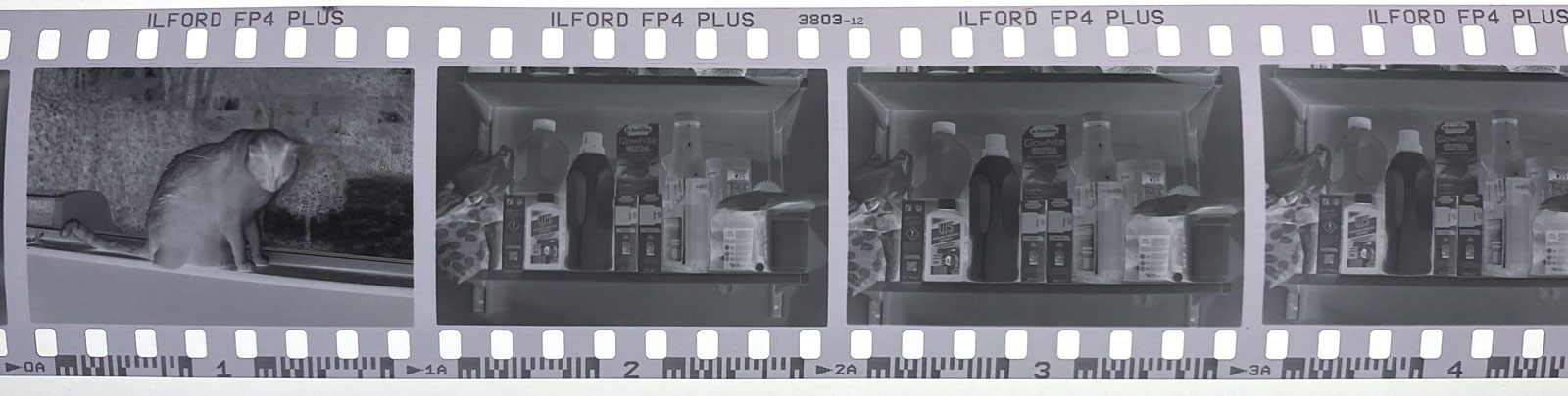

While not intended to be an exact Diafine replacement, if you are looking to mix up something that works better than the Anchell recipe and is a two bath, this formula of mine works quite well and does give a speed boost on some films (e.g. Silvermax 100 works great at 200).
Example:
