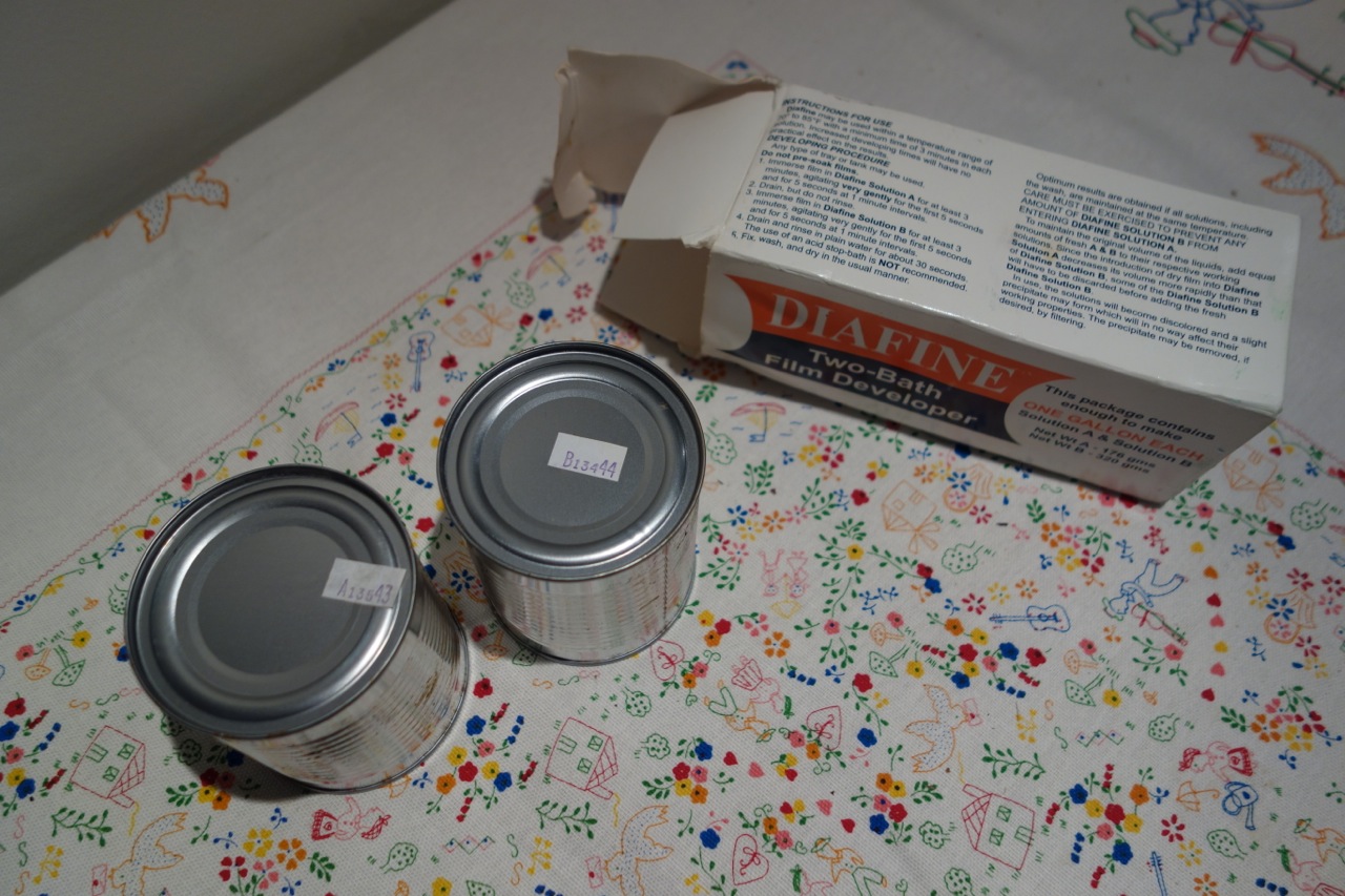

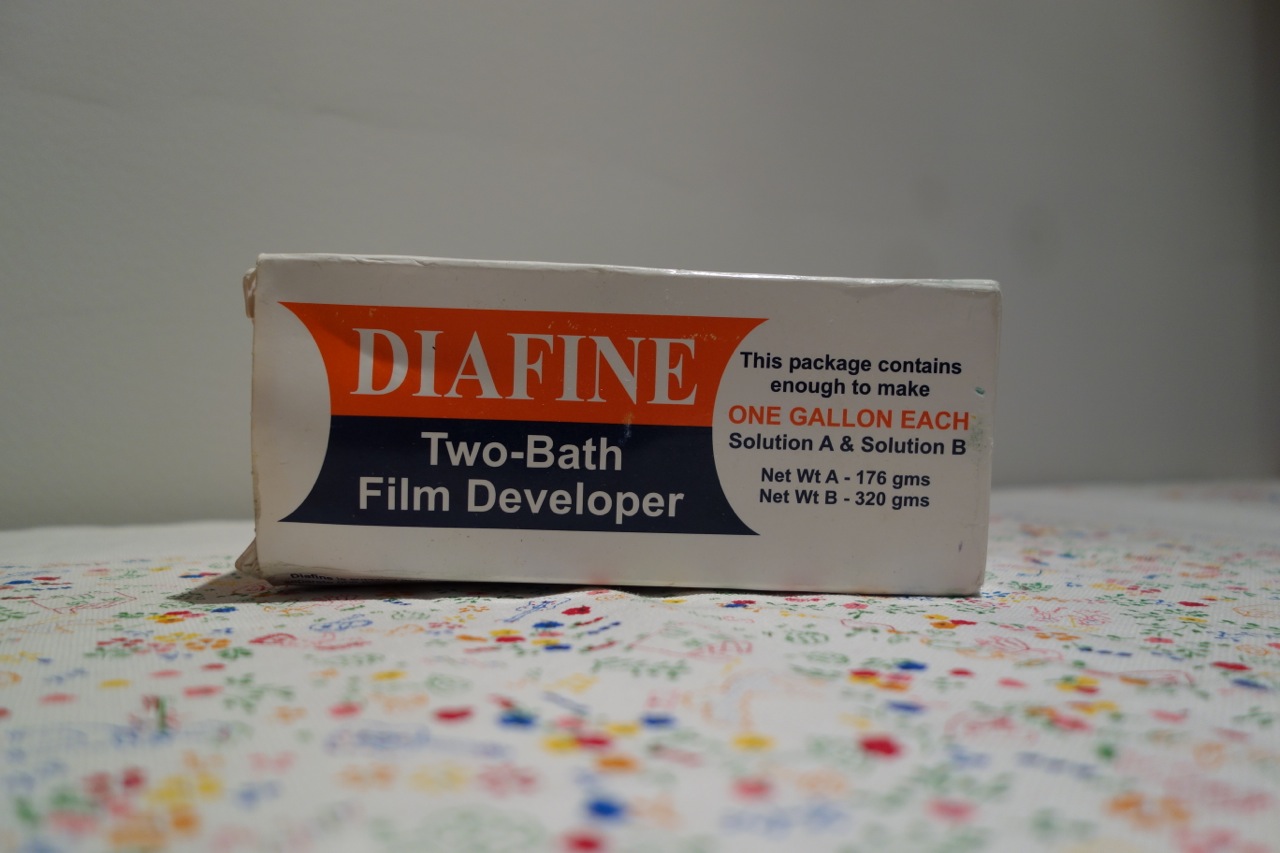

I'm cleaning out the basement and am getting rid of everything I no longer use!
A box of Diafine, enough for 1 gallon of each solution. The box is a bit rough, but the cans are unopened.
Make me an offer and we'll work out shipping based on your location - item weight is 600g. Local pickup (Montreal, Canada) can be arranged.
