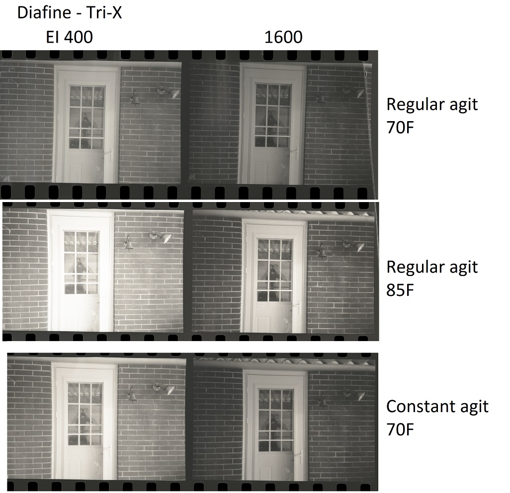

Thanks. It's been three years since I asked that question, and I've learned a few things about Diafine since then. Mainly that 70F is not the same as 85F when it comes to developing. I shot a roll of Tri-X in 120 at box speed or a stop under, and I developed it in Diafine at 85F. I got twelve black squares. I'm guessing that it may not respond as dramatically to three degree increments like other developers (why else would they put it out there unqualified?), but it does respond differently to the extremes in that range.

Huh. I've never run it at 85, but I've run it from barely 70 to high 70s, like 78 or so in summer, with no noticeable difference. I do extend the time a bit if I'm near the bottom of the range, because you basically can't over develop (well, I have never been able to anyway, but I never ran it at 85...) it just seems to go to completion for me.
I did some tests a while back. I was curious how Diafine responded to temperature and agitation. I took several frames of the same scene in the same light using manual exposure, and cut the film into three strips. One, I developed at 70F with agitation at one minute intervals (per the instructions); the second I developed at 85F with the same agitation; the third at 70F with constant agitation (both baths). Results are below, scanned in one pass with no scanner corrections enabled.
The only reason I was interested in using Diafine at 85F was that it corrected some issues I was having at the time with randomly appearing airbells. Room temperature is certainly more convenient (it's how I use it now) and I don't fret over a few degrees one way or the other the way I would with other developers.
Well that's interesting. I'm not sure what it means; it seems like the 85deg sample is the best one though like I said....I'm not sure.

Well it seems that it may make a bit more difference than some of us thought, but still far less than in a regular developer.
I am almost always between 72F and 78F though and within that range I really don't notice any difference.
