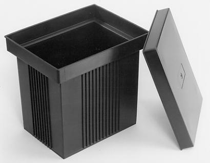

I have a friend who runs a small drug discovery company and has a proper lab. He can mix me up whatever developer I want using magnetic stirrers etc, from bulk chemicals, which will make some developers very cheap for me.
I have 3 x 70mm backs for my blad, and 500ft of Double-X Aerial film and 600ft of Plus-X Aerial film. I havn't got my 70mm reels yet, so I havn't had a chance to play. However, I will need new tanks as I've just got a tiny 35mm paterson tank.
Since the film is high contrast and old style (1969 formulation) Kodak, I'm thinking Diafine is going to do a good job of this. My plan is to use 7 or 15 litre Kodak style square tubs (3F or 7F), and lower my reels and sheets on racks into this. Since I've read that Diafine basically lasts forever, and my chemical costs are cheap, I was thinking just to leave these 15L tubs filled with Part A, Part B and Fixer. Even maybe putting in 3 deep tanks (82cm) as part of the sink.
However, my question is, how long do these chemicals keep and do they need vacuum sealing to keep. Or will just the lids on top suffice?

Diafine B is basically just an alkali solution, so I think there's every reason to expect it would last until the end of the world. The A solution with the developing agents does fail eventually, but there seems to be a fair amount of variation. Mine has generally lasted on the order of a year, but I've seen people say they were still using a batch successfully that was 5+ years old. I think basically everyone keeps it in bottles that are at least close to airtight; your "semi-open-air" proposal might be the first of its kind.

part A is absorbed by the film at the rate of a bout an oz for every 120 roll of film -- I would have no problem with the way you are describing your setup --- water for stop would be fine also -- you may want to plan for 5 baths. A, B, a water stop/rinse, fixer, and then another water with flowing water for a final rinse. after that, a quick run through photo-flow and hang to dry.

Ok, that sounds like a good idea. I guess topping up the Part A each time would help keep i alive? Also, wont the film be hard after fixer though, so I could just have a general water cascading bath as part of the sink that could be used for paper as well?
