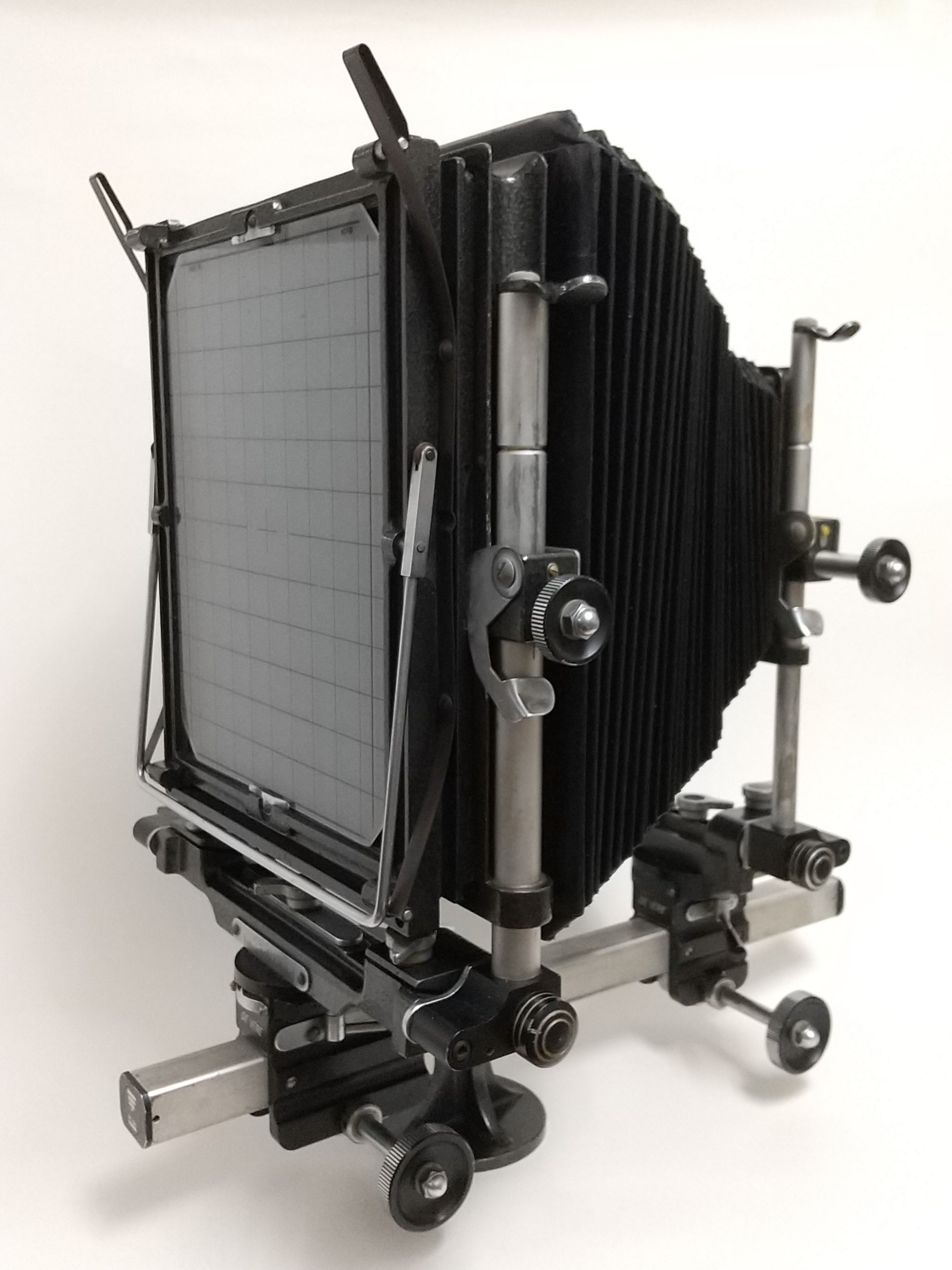

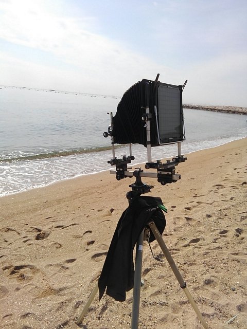

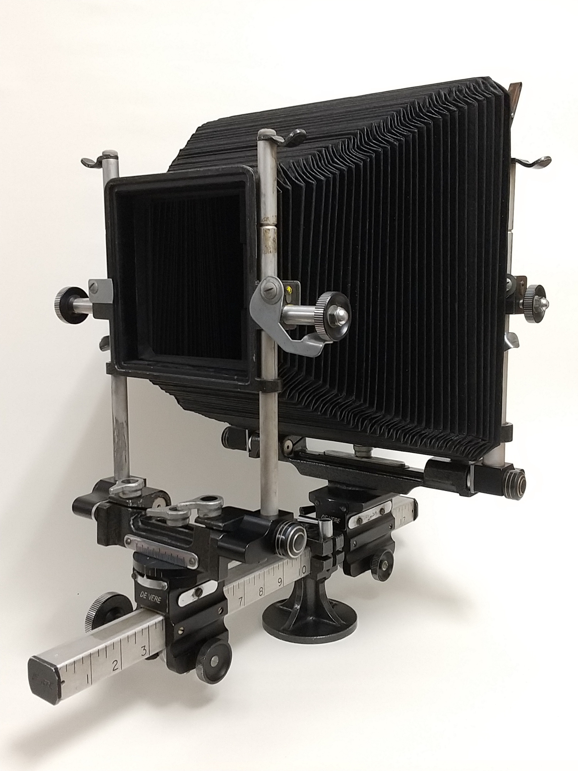

It looks like the conversation here is over, but I'll leave this image here for future explorers who will search for "De Vere Devon" like I am right now.
Its features are "heavy," "stiff bellows," and "difficulty in purchasing special parts."

... lens panels almost impossible to obtain but not too bad to make (2 mm thick, 140 x 140 mm, totally flat with no light-trapping).
Sounds like a Sinar/Horseman lens board would fit right into this lens standard.
Just an observation...
Taurabon
Jul 24, 2025
4
Osaka, Japan
I have tried it, but the SINAR board was about 1/32" thicker than the standard and I couldn't use it. I think it will be fine if I use a trimmer to thin out the locking parts on the left and right sides of the board surface, but I haven't done that yet.
