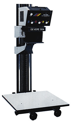

Marcos, if you saw a picture of the heads, would you be able to tell me which one was which?

The first one is newer version. I can't really tell from the picture (too small), but I think it is a DE VERE 504 DICHROMAT MKIV BENCH ENLARGER, that uses only one lamp. It needs the same light mixing boxes as the varicontrast that I have (for multigrade paper). In these models the lamp is in the front of the head, not in one side.
The second one is an older model (it could be a dichromat II or I). I have never seen this before in person. It looks like the dichromat III in the way that they have a filtering system in one side, instead of in the front of the head. The ones I own have only one lamp and the blower in the head, so they don´t need that cooling tube connected to the power supply.
If you like, and it is of any help to you, I could try to send you some pictures of my De Vere heads with their light boxes, so that you can see the differences. That could be later today.

Marcos, thanks for the help. Some pictures would be great.
The older one is the one I own and has 2 lamps in the side of the head. I bought the newer head for 15 British pounds and was just wondering if the mixing boxes were interchangeable, as it does not have one. It sounds as though they may not match.
