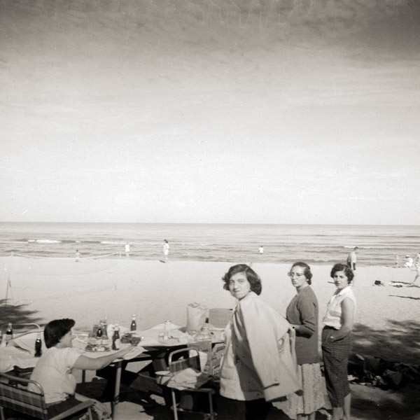

I have developed rolls of film from the 1960s, and while the results are, as expected, less than ideal, I was able to get pictures from all frames.
My recommendation is for HC-110 developer, which seems to be very good at minimizing fog of all kinds in the film. I recommend using Dilution B, because the shorter the time the film is in the developer, the better it is. I would probably start with one roll at 4 minutes to see what happens.
Plus-X will likely be a lot less fogged than the Tri-X. Higher speed films react more to cosmic radiation due to their higher sensitivity.
Attached picture is from a roll of Verichrome Pan that I found in an old Zeiss Ikon belonging to a friend of mine. His dad shot the pictures. I scanned the negatives and ended up doing a LOT of cleaning and digital repair, but I think the effort was well invested.
