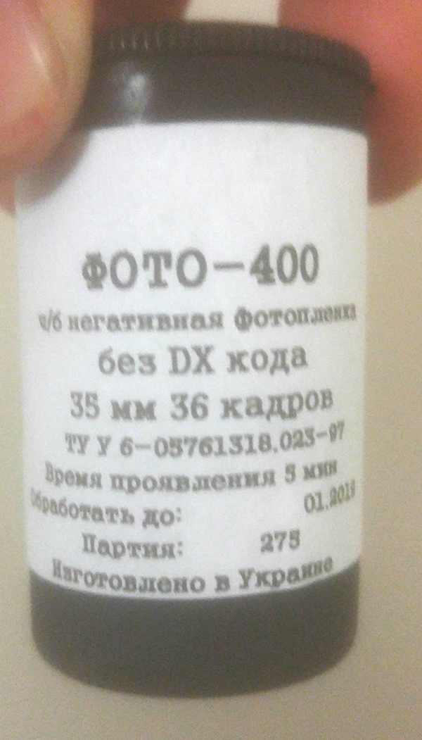

A friend of mine got hold of an old Soviet film stock called Svema Photo 400. I think it is today made by a small company in Ukraine that took over in the 90's (it's fresh film, not expired). I can however not find the development time needed for HC-110B.
Can anybody more experienced deduce an approximate development time based on times available with other developers?
Thanks a lot!

Svema closed down long time ago, but supposedly Astrum took over since 1995. Technically the film I have is "Astrum Photo 400", not Svema. I've never used Kentmere, but this film does not look like any film I've seen in the west. It has a different color and is a lot thinner and flimsier.
Here (link) are development times using D-76 and ID-11. I was thinking that more experienced people might based on this get an approximate time for HC-110B. I could also try something random and see what happens.
