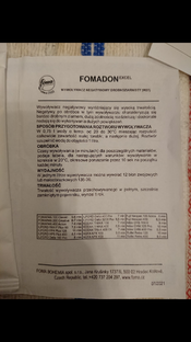

It's not in the developers you listed, but on Foma's fomadon excel (Xtol clone) package Agfa APX 100 is listed at 9.5min.
I'm reasonably sure it's for the old original APX as there's other discontinued film in the sheet, such as rollei retro 100.
