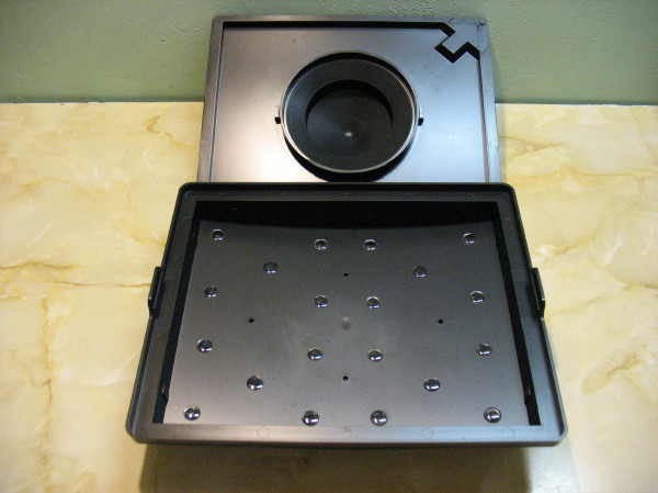

I'll also tick the Paterson Orbital box, I use 150ml of chemistry for 4 sheets of 5x4. Slow to process 10x8 with only one sheet at a time.
I've also a Jobo 3005 expert drum, this will process up to 5 sheets of 10x8.
