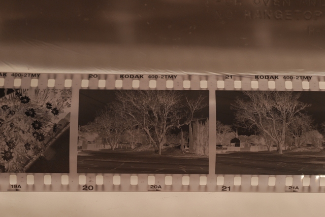

I have a very strange symptom occurring intermittently when developing 35mm film, and wondering if this group can provide some ideas on what the problem might be.
I develop two rolls of film (Kodak TMY400) at a time, using steel reels in an inversion tank. One roll of film comes out fine, and the other roll has (what looks like light) streaks along both edges of the film, emanating from the four corners of the sprocket holes. In many of the frames, the streaks extend into the image, and on the image it looks like stalagmites and stalactites encroaching towards the middle of the frame.
This occurs along the entire length of the roll, from frame 1 to frame 24.
The image itself appears fine: good density, contrast, etc.
I used D76 1:1, kodafix solution, and agitate 5 inversions every 30 seconds.
I fill the tank to the top, so the problem is not insufficient solution. For the most recent occurrence, the roll at the bottom of the tank shows the symptoms; the roll at the top turned out fine.
I am suspecting a light leak in the camera, but cannot understand where the leak could be occurring from.
Any ideas? Thanks in advance for your comments.

Hi,
I would suggest letting the group know what camera was used. Someone may have experienced it before, and it certainly looks like fogging.
Development will only produce density where there has been exposure to light, so i don't think it's your processing that's to blame.
Because of the regularity of the fogging, it looks as though the light is either refracting internally at the pressure plate or getting fogged near the sprocket drive.
I've seen similar fogging when a bright source is placed at the edge of the frame, and the light was intense enough to "bleed" outside the shutter frame and into the rebate. Yours doesn't show any of that.
Does the fogging appear in the areas not exposed during a shoot? IE, on the leader or tail?

I'm with Marcus Antonious (g). It lookss to me like a mechanical cause. Did I read someplace long ago that physical pressure can make the halides more developable?
Mark Antony
Mar 27, 2007
789
East Anglia,
Anscojohn, yes kodak did lots of tests 'straining' ag to make it more developable. I have seen this thousands of times as a Lab owner. Like I said it can be caused by winding in the wrong direction (opposite of the arrow) and also by some tongue extractors like the Noritsu which automatically winds the film to catch it in between metal tongues.
If we had a 'tight' film we'd normally open it in the dark-bag and load it in a cassette, I trained my staff to write 'possible pressure marks' on the bags if films were tight (you can feel this by turning the spool) and you would often find it was from re-winding backwards.
They are called pressure marks and can sometimes happen on 120 film as 'half moon' marks, you can test this by taking an unexposed piece of film and folding it in the dark, loading in the tank and processing-same marks.

I've had it happen too. It happened a lot for a while then went away. I don't know what caused it. It wasn't my camera, happened with different bodies. I thought at first it was outdated film, because it happened first with outdated Tmax 3200, but it has since happened with fresh tmax3200 and some 400 films. I have been processing film since I was 15, and NEVER saw this until 2 years ago. It has only happened once in the last 6 months. I have no idea why. Agitation has been consistant.
David A. Goldfarb
Sep 7, 2002
19,974
Honolulu, HI
Bromide drag?
Causes: insufficient agitation or tank filled to the brim providing insufficent empty space for the chemicals to agitate.
Yup. That's what it looks like, but the pattern is a little odd. Normally the streaks are at somewhat of an angle, rather than straight up and down like these. 5 inversions every 30 seconds during development should be sufficient, but maybe you need a little more air space at the top of the tank to agitate effectively.

Thanks very much for all the responses and the great ideas. I think Mark and John may have hit the nail on the head: rewind in the wrong direction. But I'm not even a lefty (maybe in mind only).
The embarrassing part is I don't recall 100% what direction I rewind the film crank, even though the arrow is right there! I have a sneaky suspicion that I sometimes don't even think about the direction, and turn the crank clockwise, which is opposite from the arrow. If that is true, would that explain the marks?
As to another question: yes, the effect of the mark reaches into the image, so that at the top and bottom of the frame you will see slivers of light reaching toward the middle. They only enter about 10% into the frame, but it destroys the sky scenes.
I did think it was agitation at first too, but I do 5 full inversions (bottom to top and back, with a twist) every 30 seconds. And I also thought it may have to do with insufficient developer in the tank, so when inserting developer I make sure I see some small pool of liquid in the opening of the lid when the tank is flat
If the rewind is the cause, I would be extremely happy, even though I'm also feeling a bit silly right now.

Looks like a bad rewind
Hi everyone,
All great tips, and much appreciated.
I shot a quick roll of XP2 just to see if I sense any differences when I rewind. It felt sufficiently different that I think that's what I must have done....rewound in the wrong direction for the rolls that showed those symptoms. I'm going to go with this conclusion unless the symptoms appear again, and I'll be sure to resurrect this thread if it does. BTW the shots came out just fine.

In my 20+ years as a lab owner I've seen this fault loads of times. Your films show the classic symptoms of being wound inside out. It can't be a processing fault as faults aren't that regular, and I've seen it on dip and dunk, roller transport and tank handlines.
Back in the 1980's I had a client who was also having this problem, we were sure it wasn't the processor (Fuji FP 250) and he was sure it must be us. I asked for the help of Brian Drage Agfa engineer who explained what happens when you re-wind backwards.
We were able to purposely generate the fault by winding backwards, in fact we asked the client to re wind in front of us and could see he was winding against the arrow and was left handed.
He never had the fault again.
