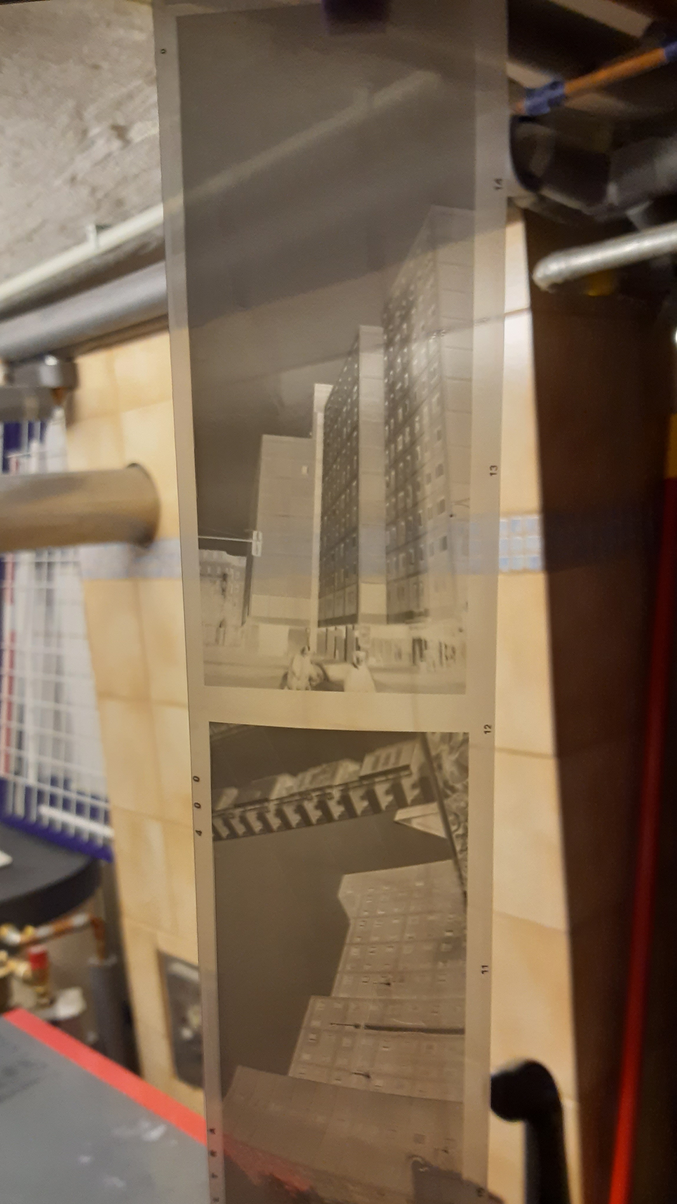

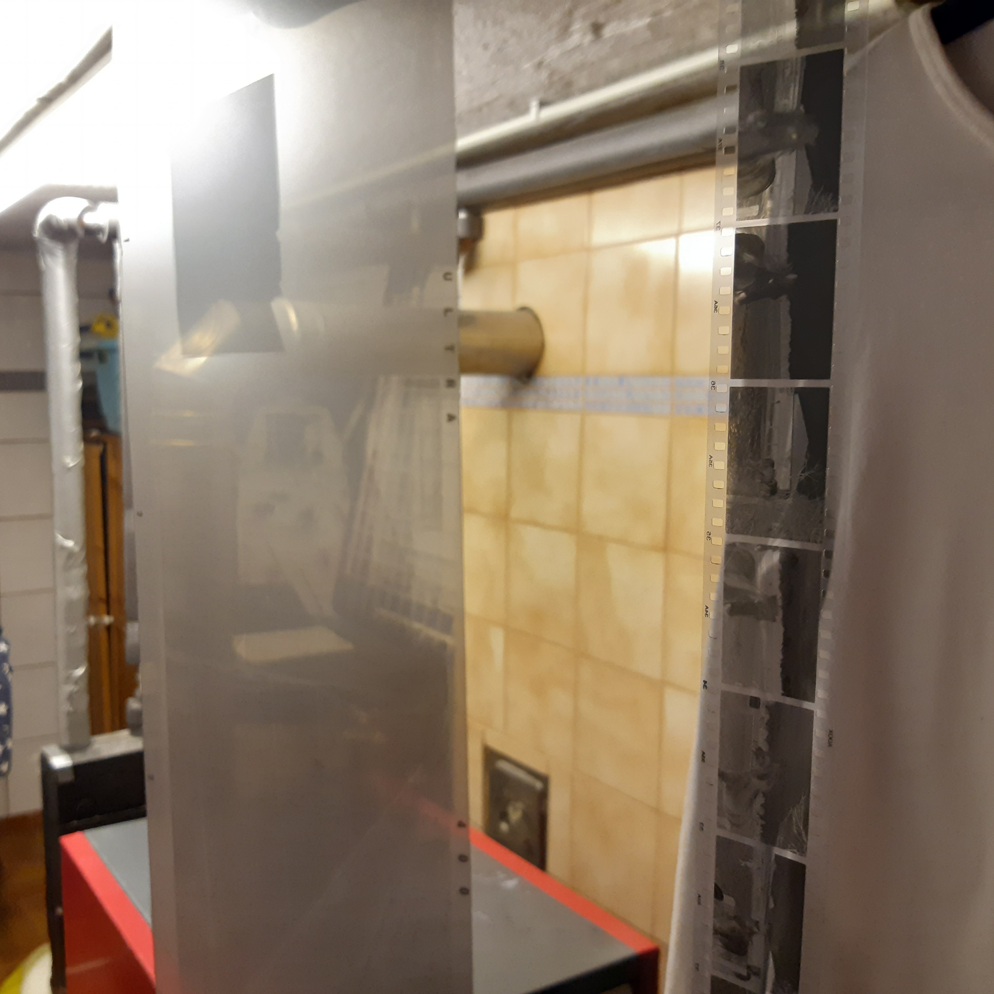

I developed two rolls but the 120 (shoot with a Holga120Pan, Fomapan 400) looks foggy. Is this just underexposure or what's going on? The 35mm roll (HR50) from a different camera looks fine.

Factory inscriptions along the edge of the film indicate that the film has been developed correctly. This is an exposure issue.

But if it's an exposure issue shouldn't the film borders be clear? Light leaks look different. The entire roll is fogged evenly.

I can't see what's on the tape. The only thing I see is that the film is developed correctly. There is no film backlight. There is a problem with insufficient exposure and possibly with rewinding the frame, I can’t say more precisely because I don’t see

There is some base fog, is it an in-date film? Could it have been through an airport and have X Ray fog? Otherwise, it looks grossly underexposed. The 35mm beside it looks good, so I don't think your developing technique is bad.

On the picture is the best frame of the roll, maybe that helps.

The edge print looks good, so I think the developing is fine; it's underexposed.

I would say that it needs more in-camera exposure. The high level of fog makes me wonder whether there has been some light leak - possibly at the reel loading and/or development stage.

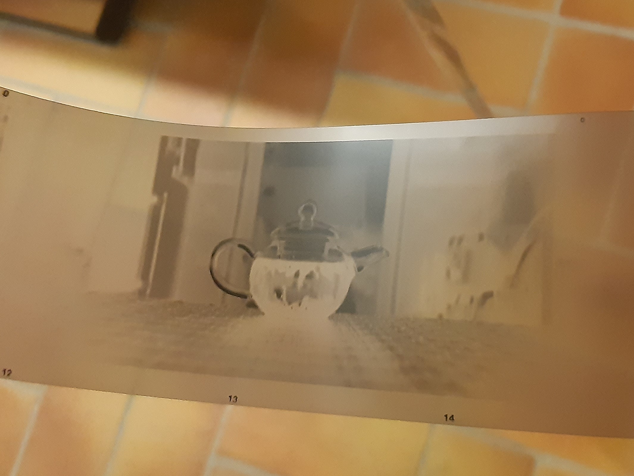

2. roll looks very good! Base is clear.
Things I tried:
1. All pictures were taken on a very bright day. Probably overexposed by +1 or +2 stops
2. I tried to tighten the roll in camera.
3. I used Rodinal 1+25 with a development time of 5,5 min instead of 1+50 and 11min.

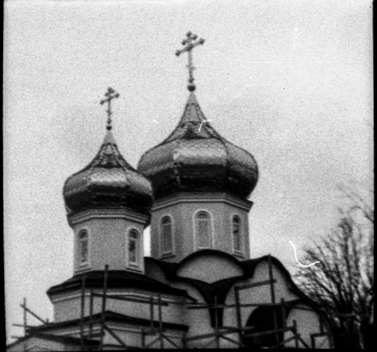

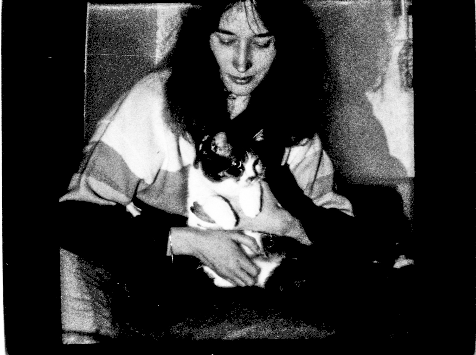

Congratulations! This is true. Your camera loves a lot of light. I will show an example of Diana Baby's camera. She is funny, very small and interesting, but she can really shoot. I took a photo of my daughter, I held Diana in one hand, and in the second I gave a flash of the usual Point and Shoot
