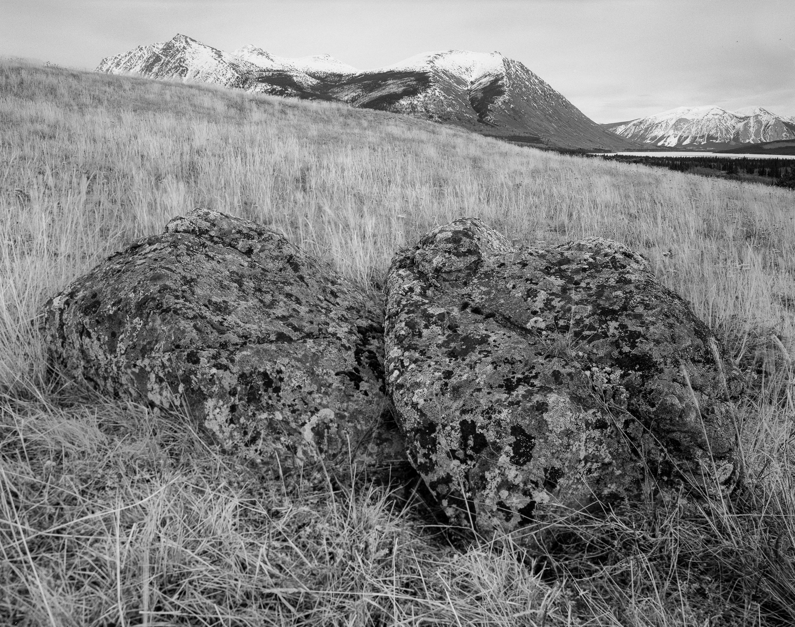

I finally got a chance to shoot some more of this film, 24 sheets of it this weekend actually!
As mentioned above I got really thin negs shooting at ISO 100 and developing in Pyrocat-MC. Seems like most people are shooting it at at half speed or lower so I went with ISO 50. I looked up a Plus-X datasheet and went with HC-110 1:31 (Dilution B) developed for 5 minutes in a Jobo Expert Drum. The negatives are drying now and they look great.
adelorenzo
Mar 10, 2012
1,421
Whitehorse, Yukon
Tried ID-11 at 1:1 for 8 minutes, exposing at ISO 50 again. Negatives will print nicely but less density than what I got with HC-110. I'm thinking 8 minutes ID-11 stock will be the way to go.
Also I noticed that the Atomic-X sheets are slightly smaller than my Ilford sheet films. This has caused me problems with some of my older Graflex holders.
