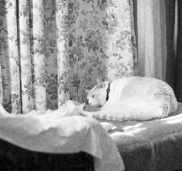

I'm getting issues with my recently developed roll of film (Aviphot) and getting some weird dots/granularity. I thought it was some kind of reticulation since there was a temperature difference between the developer and stop bath (water) or even with the fixed.
Yesterday I put all 3 liquids (developer, water for stop bath and fixer) at the same temperature and still get the same issue.
Detail:
It is more evident on clear/white areas
My last guess is either the film itself or the fixed. Dumping the fixer today an preparing new one and make a new test. I discard it as a fixer issue since I also developed some 4x5 and it was ok.
Film stock is Aviphot by the way. I had developed some rolls from the same 70mm roll without issues so not sure it is the film stock.
Any idea what this is about?

To my eye, those resemble the spots you'll get if the film was still cold when unsealed and moisture condensed on the emulsion. This will dissolve some of the sensitizing dyes, which will then redeposit where the droplets last existed, producing spots like what we see in the tight crop above.

Thanks Donald. You may have a point there. I usually remove the 70mm roll from the refrigerator 2 hours or so before cutting but I may skipped the last time I rolled 120 film. Also, it is much warmer and I have the a/c on in the room I reroll.
It would make sense that 4x5 film don't have the issue (even though the same chemistry was used) since I have the 24mmx74mts at a cool room temperature (the same room I cut film on) before cutting since there is no room for them on the
freezer.
I will take the 70mm roll from freezer two hours before cutting and see if it improves.

Yes, it doesn’t look like reticulation to me.
Yeah didn't look like that to me either. Last time I got reticulation was on the 80's if my memory serve me right (probably Plus X or Panotomic) and didn't look like that, but that was the only think I could imagine given I used the same chemistry with 4x5 and didn't had the issue.

Rolled a new 120 from the same 70 mm roll and it display the same marks, Even though 70 mm has been at room temperature for hours. Maybe moisture affected the whole roll?
Got a second 70mm rolls that has been out of refrigerator since the morning. It is still unopened so hope I get a good roll. Also just to discard any fixer issues, will prepare a new batch as well. Hope for the best

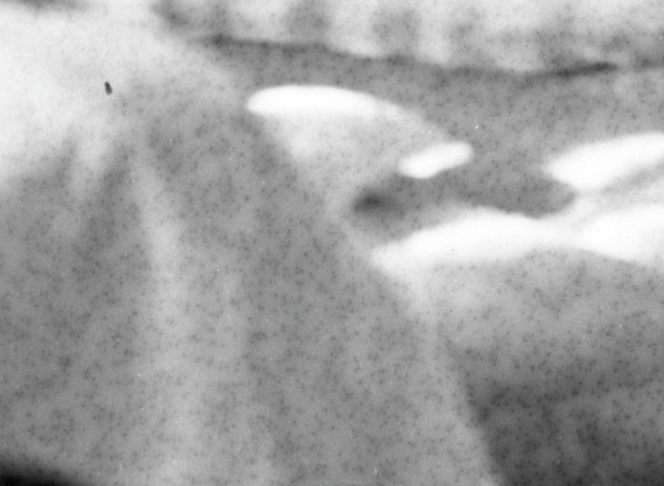

I guess I got a lemon on the current roll. Like Raghu said, probably this one roll was badly stored and got damaged, probably by humidity.
Will recover the backing paper and try the next roll.

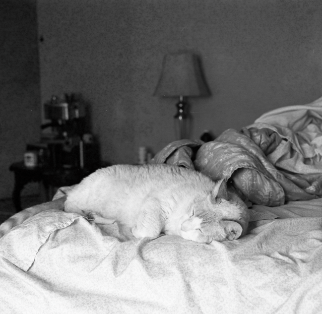

By the way, this is yesterday test:
Close up

I'm afraid this is the same issue. Testing the unopened 70mm I have. I bought several rolls from the same guy on India and didnt had any problems before. Hopefully this unopened one is fine.
