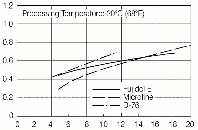

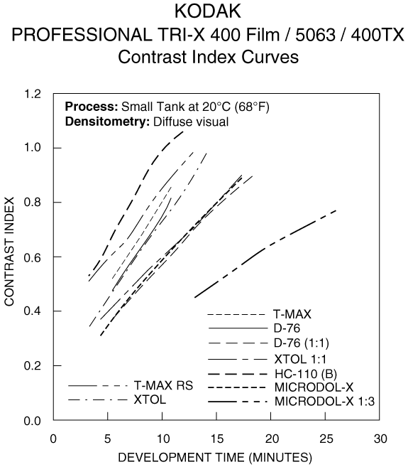

Here are a couple of development time vs. gamma/CI charts. One for Acros and one for Tri-X, taken from manufacturers' data sheets. You can see that rate of change with time varies by developer and isn't necessarily linear. Films obviously vary as well. You might use this kind of data as a starting point, looking for similarities between the developer you choose and those with published data if you don't use a listed developer, but each combination is unique, as is your agitation, use of a pre-soak or not, etc.
Any general guidelines you get are just that, useful as starting points, but unlikely to be a perfect comprehensive answer unless specific to a particular combination of film and developer. In any case there's enough leeway in the whole process that a generic adjusment will probably get you close enough to cover any missed attempts with choice of paper grade, developer, etc.
I've recently used g3data (Dead Link Removed) to extract a series of X,Y data points from curves like these and run regressions on them in a spreadsheet to get a second or third order polynomial expression for the curves. The point of this was to find how well a regression on a set of 3 or 4 observations of gamma for my own tests might predict good times for a specific gamma within the normal range. The answer is "probably much more accurately than necessary".
