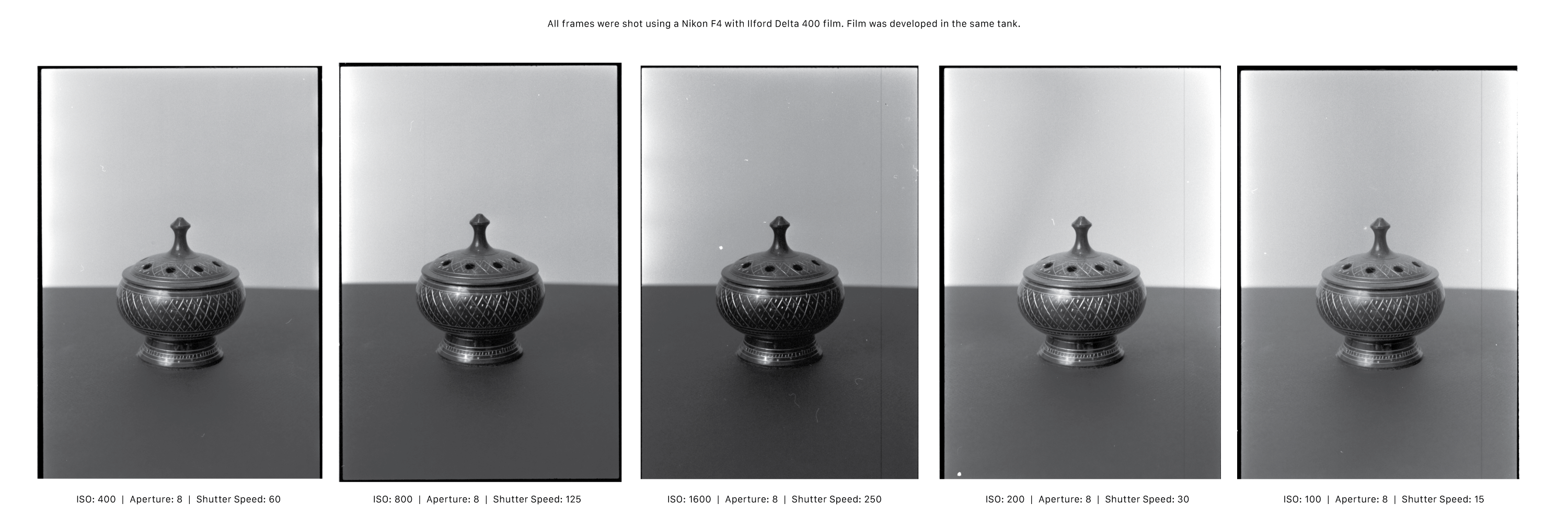

Need some help understanding a few things.
1. Why there's a thin black line on the right side of the last three frames?
2. I did semi-stand development for 50 minutes and agitated every 10 minutes for 5 seconds. Then i did a normal stop, and fix. I did a washaid and wetting agent to finish the process. That helped a ton, but I would like to know if I can get the negatives even cleaner.
3. Are the white halo on the sides of the image caused by stand development? The background was white but had some distance from the light used.

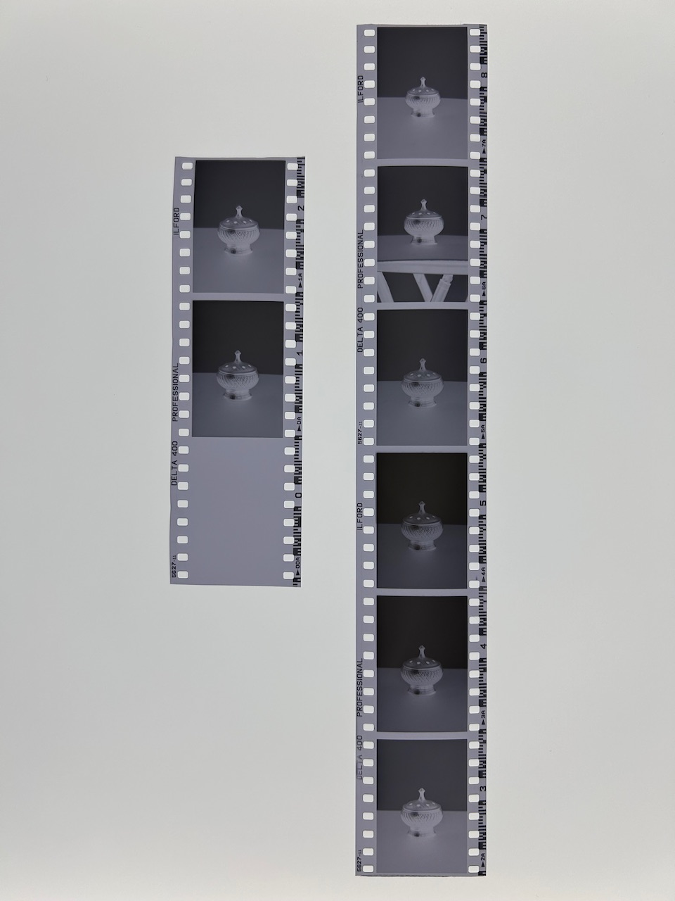

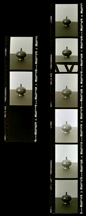

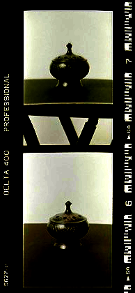

Here are the negatives. I don’t see that line so it’s clearly coming from my scanner. I also don’t see the dust spots.

The dust. But this might be a problem from my scanner that another person pointed out. Looking at the negatives I don’t see the dust marks that are showing up after I scan. how can I tell if my film is underfixed? Here are the negatives for reference.
i use the washaid to reduce the final rinse time. So to correct what I originally mentioned for my steps: washaid, final rinse, wetting agent.
The image in the centre (1600), aside from showing density variation artefacts like the other ones, shows bromide drag artefacts on the left border: you can see a repetitive pattern of uneven density whose spacing is compatible with the sprocket holes of 35mm film.
Bromide drag is a by-product of reduced or insufficient agitation techniques. Bromide forming during the development process slows down the development where bromide collects. Bromide will collect in or around sprocket holes and run down the surface of the film causing the streaks that you see in the middle frame.
The above is not the effect of scanning: I know of no scanner sensor that can produce the patterns in the centre image. It's the effect of your development decisions. You didn't say what you're using to develop. If you're using Rodinal, my personal experience is that it works much better for 99% of the scenes I photograph diluted 1:50 and correctly, and regularly inverted once per minute. You only have to do it for 7-10 minutes, it is not a lot of work, and you'll be rewarded by negatives free of bromide drag and nasty (IMO) border density gradients like the above.
EDIT - I have now seen your negatives: the density effects you experience are being exacerbated by the fact that your negatives are overdeveloped for scanning. Your dynamic range is extremely low, and the scanner software will (unless you defeat it) try to expand that compressed signal and stretch it to utilise as much of the available bit space as possible. This means that existing density differences in uniform regions of the negative will be more noticeable in the scanned positive.
So - if you plan on avoiding the above - on top of moving away from stand/semistand and using 1:50 dilution and regular gentle inversions, also work on optimising your development time to achieve lower highlight density than you see here: all that density is not needed and it's in fact holding you back, if your purpose is scanning
Light bleed along sprocket holes in a poorly designed (or missing) film holder & mask could very well produce similar results. Indeed, the density variations along the edges are so pronounced, and also present on both sides of the 200 & 100 EI samples, that I find it hard to believe the agitation scheme is the only factor responsible for these defects.
Note furthermore that the density variations seem to be less pronounced in the negative film strip if you invert it. Resolution and bit depth are a bit limited, but the problem seems less pronounced even if you adjust contrast for individual frames.
I don't rule out mode of development as a contributing factor, but it does not appear to be the sole factor responsible for the density variations.
I'm talking about this pattern, present on one side only of the 1600EI sample, and definitely not present on both sides of the 200 and 100 EI shots.
I have scanned film for more than 20 years as my sole film film photography output, using a large variety of holders, whether custom-made, 3D printed, original, and I have never seen a holder produce the above. But there's always opportunities to learn something new, who knows.
Still, I maintain this is textbook bromide drag, caused by insufficient agitation, and exacerbated by suboptimal development time (overdevelopment) for scanning.
I know. Look at the other illustration; despite its low resolution, it's clear that the density variations in several frames are different. This suggests that whatever scanning method was used, did in fact affect the outcome. This isn't to say that bromide drag did not play a role, but we'd have to exclude the measurement errors first.
And having looked at the film strips some more, I suspect that lighting conditions also played a role; see e.g. here:
Note how higher negative density on the right side of frame #6 suddenly disappears in #7. Had this been due to a development problem related to stand development, it would (1) be limited to one edge of the film (which seems to be the case, along the left edge) and (2) it wouldn't have cut out suddenly from one frame to the next.
Again, I'm not saying agitation wasn't a factor. But there's so much going on with these scans that you'd have to clean up the methodology some more before it becomes clear which problem is caused by which factor.
