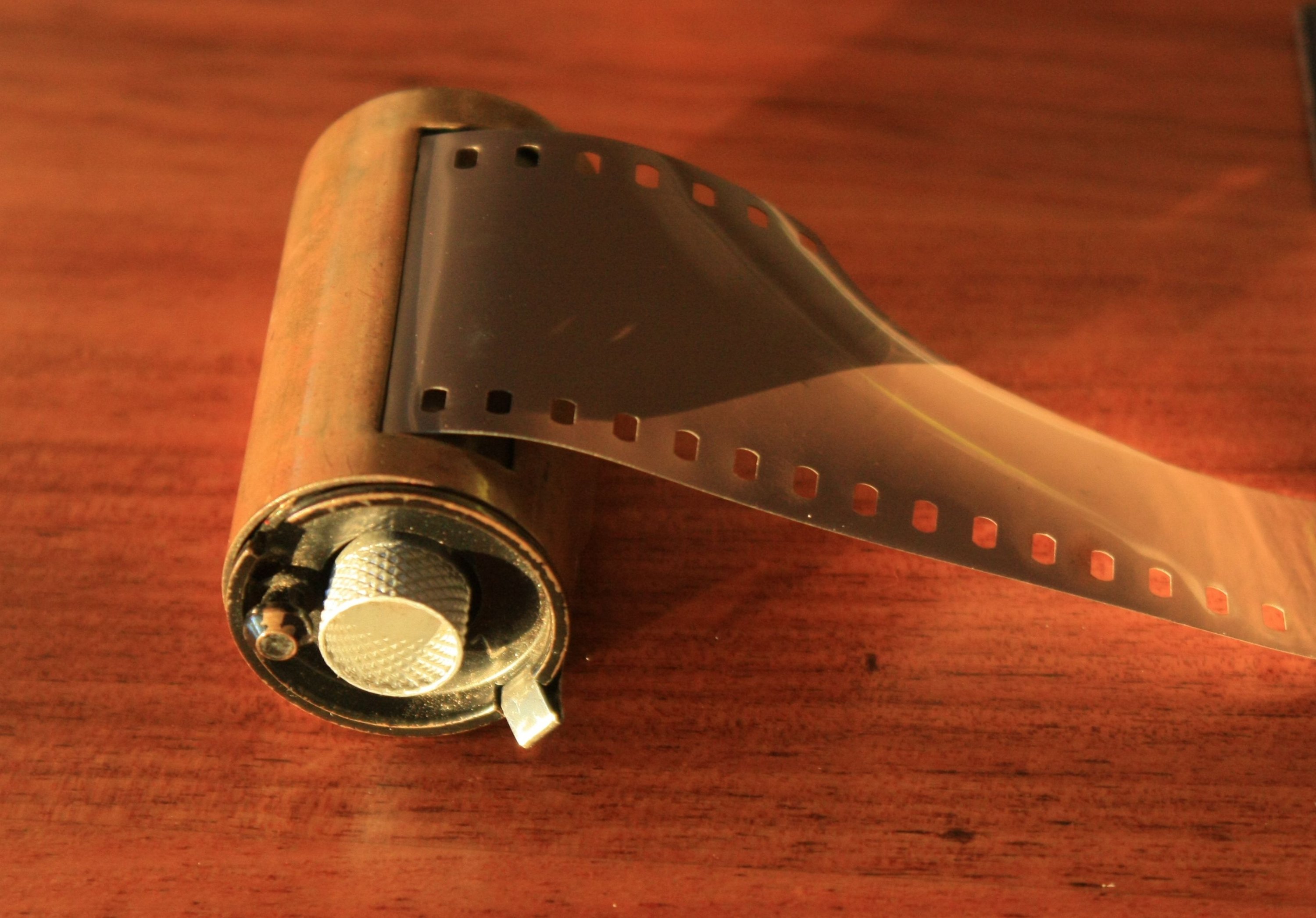

Here is a picture.
Nitroplait
Jul 13, 2020
880
Europe (EU)
OK. I am almost sure it is a FILCA - only useable in the Barnack Leicas. They are easier to identify from the other end - if it say Ernst Leitz Wetzlar is a FILCA if it says Ernst Leitz GmbH Wetzlar it is a IXMOO.
If you happen to have one of each next to each other, the slightly shorter one is a IXMOO.
The IXMOO cassettes are useable in both Barnack's and M's up until early M6 models in the second half of the 1980's.
The very bright silver center spool does not look original, Those I own are all black.
I doubt that these were ever sold pre-loaded, the cartridge itself was rather expensive and Kodak had introduced the single use cassette already in 1934, which would also fit into Leica and Contax cameras.
I have heard that you at some point could buy precut filmstrips which you could roll onto the FILCA-IXMOO in your darkroom, but I have never seen anything like that during the 50+ years I have been interested in photography, therefore my guess would be that it is black and white rolled at home.
To be certain, you can drop a little piece of the film-end into fixer; it should clear up and the color of the film-base should tell you if it is color (magenta), slide film(clear) or B&W (greyish).
For development of long expired films, I have only experience with HC110 which is said to be a good choice for film with expectations of a lot of base-fog.
I have only developed film of known types - I have never been so lucky to find a FILCA cassette forgotten in a camera - thus I just took a known HC110 formular for the given film and added 25% time - that has always given me printable results - if the film was exposed, that is :smile:

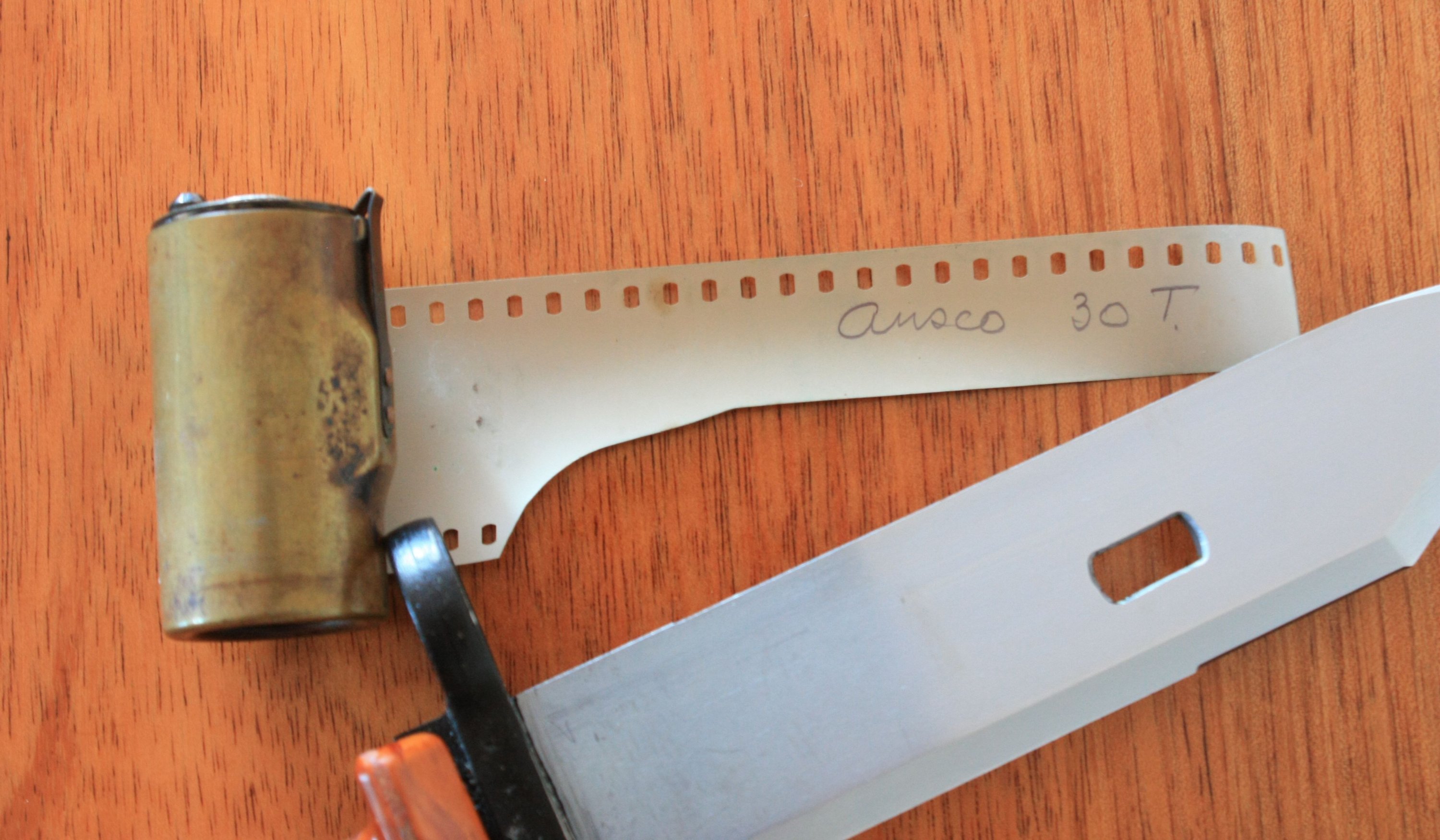

I had three Leica cassettes with film and did some strip-tests (in HC-110 dilution B at 18 degrees Celsius for 6-7 minutes) today. Here are the results:
  • One contained BW film which was exposed to light and came out completely black (I developed the rest of the film, just in case).
  • The second could be either slide or BW as the base is clear with a bit of bluish tint. I developed about 10 cm of that film that was inside the cassette and it appears to be unexposed.
  • The third film is still a bit of a mystery. The strip that I developed was too short and came out completely black . I discovered "Ansco 30 T." written in pencil on the leader.
I could not find any information on "Ansco 30 T" film in old Ansco/Agfa catalogues. The closest would be Ansco Anscochrome (slide) film in which case 30 would be its ASA speed and T would probably mean "Tungsten".

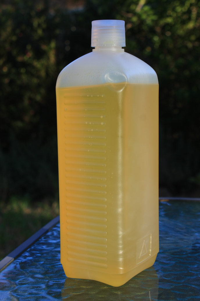

It looks more like the one made in Germany but the label is different. It is not easy to pour. Pouring it out of 10 ml graduated cylinder is a bit of a task.

After this quick digression into developers let's get back to the main subject of our discussion. I did the "fixer test" (dipping the test strips in Ilford Rapid fixer 1+4 for about 5 min at 18 °C) and the film base for the two remaining films looks like that:
Sample #2 is the film with "Ansco 30 T." written in pencil on the leader. Sample #3 is the other film found in a FILCA cassette with a sticker which has "50" written in pen (ASA speed?). Ignore the darker areas on the sample, it touched the column in the tank and was not "fixed" properly. For comparison, there's also a piece of Kodak TMAX-100 from 1980's developed in HC-110. Sample #3 seems to be BW but I am not sure about #2. It looks darker and somewhat warmer.
The plan is to reload the rest of the two films into 35 mm cassettes and shoot them rating at EI 25-12 if not lower. Then develop #2 in C41 (if I ever get a kit given I am in lockdown in Down Under) and #3 in HC-110. What do you think?
