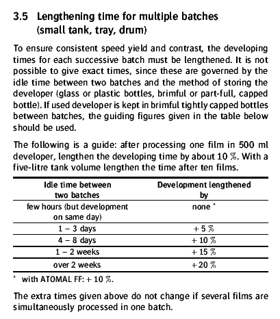

Here is what Agfa said about extending the development time to compensate for partially used developer.
When you are using such a potent developer, it isn't sound to shorten the times below 5 minutes. better to increase the dilution. Rodinal Special is excellent at 1+31, but you'll have to work out your own development time.

Frank: thanks .... I am using 1:15 because that is what the instructions suggest (this is Rodinal Special now) but I do realise that a weaker dilution has advantages in that it extends the developing time so it's longer than five minutes so it would probably be better if I did that.
On the reuse thing: I am not talking about using the developer, putting it in a container for a few days and using it again. I mean, do one roll of film, pour out the developer into a container, then use it five minutes later for another roll. It seems from the comments though that this is not a great idea. So thank you all for that ..... I guess I will be going through more developer than I thought but then if I dilute more this won't be so much of an issue.
