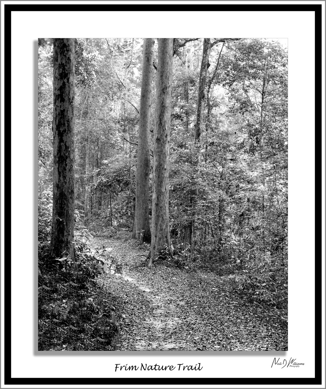

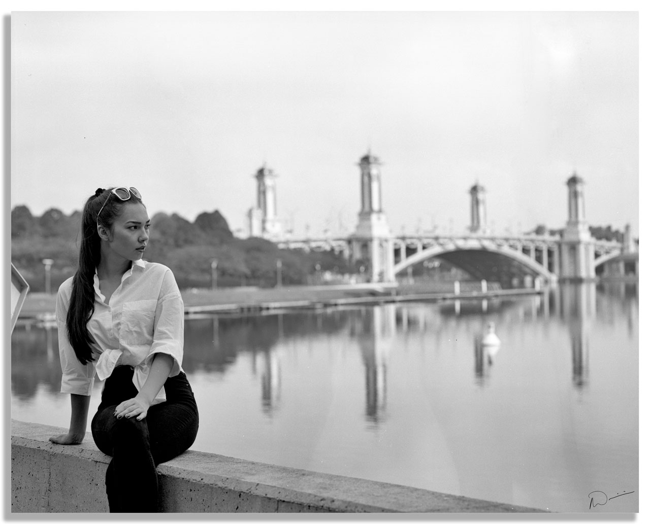

Hi I'm back
So this is what I do. When I am using my Chamonix 8x10 if I am taking a picture of a landscape for instance I look at the scene in front of me and find the brightest spot (usually the sky) and meter that. I then look for the darkest spot (something in deep shadow) and meter that. I then get another 4 meter readings of various areas in the scene and meter those as well. After I have all those meter readings I use the average function on my Sekonic 758 DR and take that as my settings for the picture....................
When I am shooting a person, a flower or anything near to me I just use the meter in incident mode and go with that setting.................Looking at my results I am defiantly getting better and yet to have any complete disasters except for a few light leeks that were operator error :smile: :smile:
Here is one of each both shot with 8x10 and Ilford HP5+ developed in LC29 developing speed reduced by 15% due to constant agitation in drums;
pentaxuser
May 9, 2005
19,662
Daventry, No
These negatives do not look like a disaster. So is the negative you say you need to try and recover in post 3 not one of these? If it is not one of these two negatives then show us it to demonstrate what is wrong or are you saying that you have now solved your problem and the thread can be effectively closed i.e. you do not need any more help?
