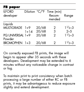

Can anyone give me the times to develope FB paper in Ilford Multigrade paper developer. Ilford Ilfostop and Ilford rapid fixer? Thank you!
At normal dilutions & 20°C/68°F , typical time for FB paper is 2 minutes as a starting point. As they say, YMMV. It's of course tied to your negative and exposure. I use Ansco 130 and LPD and frequently develop past 2 minutes..."to completion" as they say. But it depends on the highlights. 2min with the products you've mentioned would be a good target.

Here is the Ilford datasheet for the developer - the answer is on page 3: https://www.ilfordphoto.com/amfile/file/download/file/1828/product/709/
Thanks for the datasheet but I'm looking for times to use. Here is my dilutions for each one I'm using. Ilford Multigrade Paper Developer 1+9 Ilford Ilfostop 1+19. Ilford Rapid Fixer 1+4. If you can just tell me the develope stop and fix time for each with FB paper that would help. No further explanation but times. I'm a basic beginner. Thank you!
This is directly from page 3 of that datasheet that I linked to, and it both answers your question, and gives you some additional useful information:

The picture of the table that I last included clearly shows the times for FB paper and Multigrade developer. Is it difficult for you to see it? If so, it may be a challenge to do this over the internet.
That table recommends a range of 1.5 - 3 minutes for FB paper and 1 + 9 dilution Multigrade developer. If you need a single target time, the table recommends two minutes for that dilution and paper.

You only gave me time for Ilford Multigrade Paper Developer. Times for Ilford Ilfostop and Ilford Rapid Fixer please. All I need are those two times and I'll leave you be!

I can't seem to find Ilford's instructions for FB development, so I've followed Kodak's instead, using nearly identical chemicals:
Kodak Times:
Stop (Ilfostop or Kodak Indicator Stop; citric-acid based): 15 seconds
Fix (Kodafix, Kodak Rapid Fix or Ilford Rapid Fix, mixed to paper-strength 1:7): 5 - 10 minutes for FB
Strictly a personal recommendation:
Hypo Clear (1:3) for 8 minutes after Fix (rinse briefly in-between if possible), then wash for 30-45 minutes.
Multiple checks with Residual Hypo test found no trace of fix remaining.
EDIT: Found Ilford's FB Instructions:
Stop
ILFOSTOP 1+19, 10 seconds
ILFOSTOP PRO 1+19, 10 seconds
Fix
ILFORD RAPID 1+4, 1 minute
FIXER 1+9, 2 minutes
HYPAM 1+4, 1 minute
HYPAM 1+9, 2 minutes
Powder ILFOFIX II, 3 minutes
