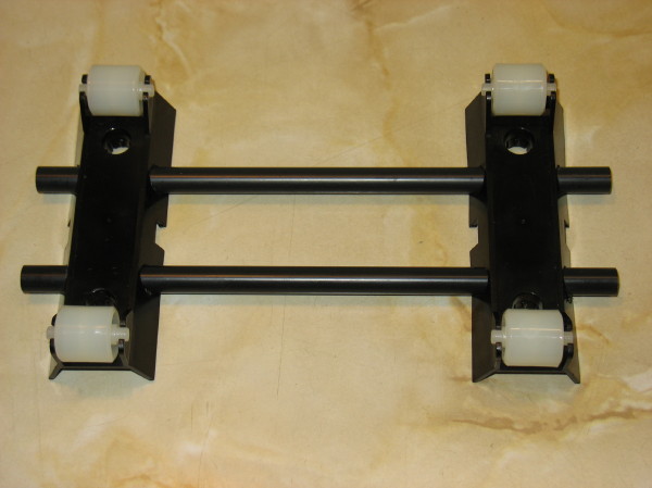

When using the Jobo Expert 3005 and 2830 drums I use the 1509 manual roller base (pic. attached). Certainly not as sophisticated as their CPP-2 processor but a lot cheaper and does the job just fine. Although it does get monotonous rolling the drum for minutes on end:sad: .A motorised roller like the ones mentioned by Lee would be a great help.
The roller wheels have adjustable positions to accommodate the various drums. In this picture they are set for the 2800 drums.
