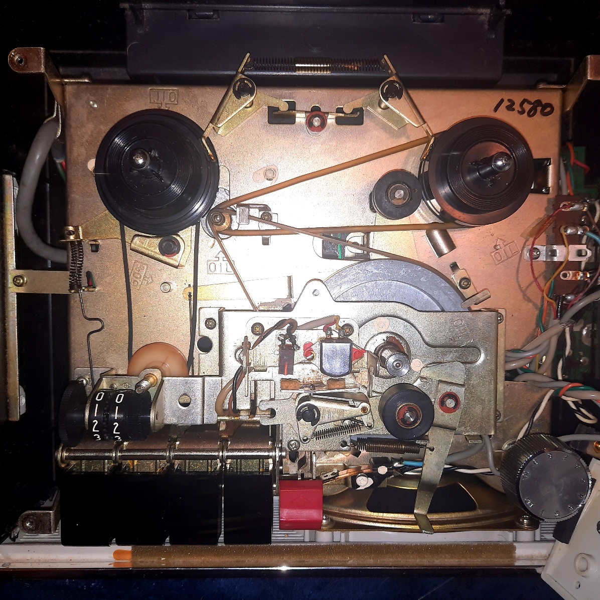

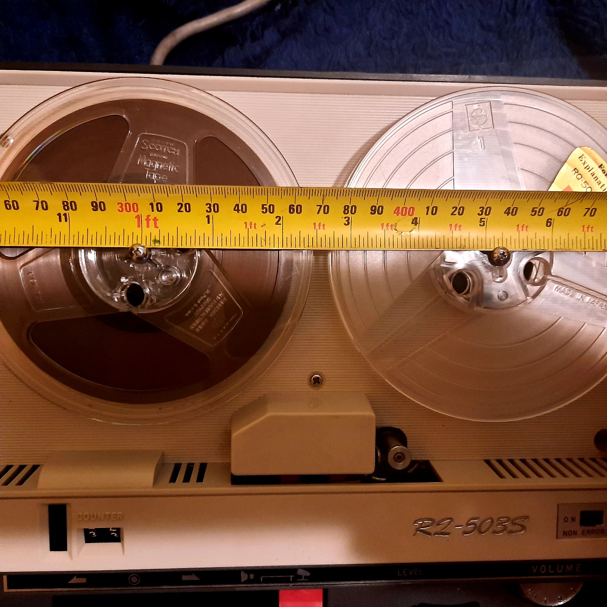

I wonder if you could modify an old reel to reel tape recorder to run the spindles. This one takes 5" reels and spindle is 5.25" apart. If you could slow the forwards and rewind it would only be a mater of switching from one to the other or rig up an auto switch if you are really clever.
Actually you would only need to run a belt from each reel spindle. Maybe DC model would be easier to slow down.
View attachment 263403 View attachment 263404

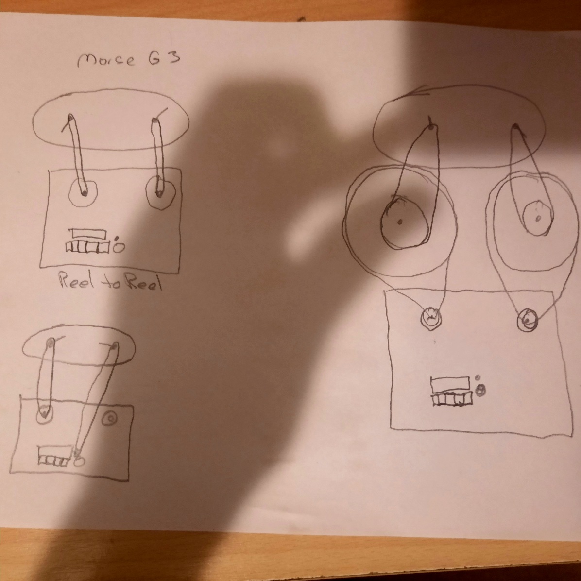

Sorry, need to explain better. I was just thinking of making it a little more easier to wind using a motor pulley system.
If you run direct from spindle to spindle you have the left reel going clock wise on rewind and the right spindle going anti clockwise in forwards. Only one motor running in direction at a time. But it will be too fast. You could use a second pulley as in the next picture this can be made to size to get correct speed, like the way a belt drive record player works.
The third option is to connect one to rewind and one to the capstan on play side of reel to reel, which still runs too fast at 1.5'/ sec, but would be easier to slow down with a pulley wheel.
Actually can't see it being much of a change to make my own morse style tank which I can then easily perfect the pulley system.
Same can be done with drill type motor or something else.
