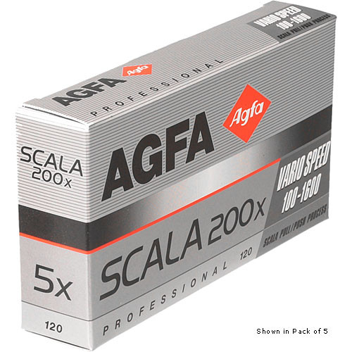

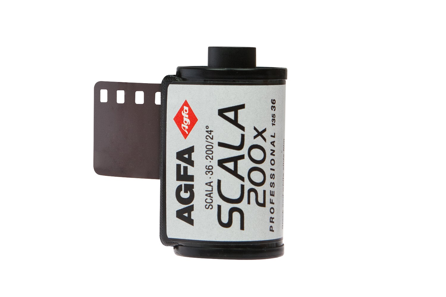

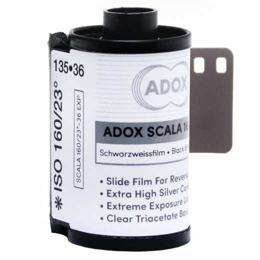

It's a "remake" of the excellent B&W slide film "Agfa Scala 200", that needed special developing. I haven't tried "Adox Scala 160" yet, but if it is as good as the Agfa Scala, then I can recommend it.
This new Scala can be home developed as a positive film, but there are still some labs that will do this:
See: http://www.adox.de/Photo/adox-scala/
adox_scala_160-new-001.jpg Agfa_Scala_200-film-001.jpg Agfa_Scala_200-doos-001.jpg

No, it's not a new film. It is Silvermax 100 with a different label. Adox is quite open about it. They created Silvermax as a Scala replacement, but, if I read and remember correctly, couldn't name it Scala right away. That is why it has a transparent Acetate base.
Since Silvermax as a negative film is ISO 100 there were misunderstandings, apparently, when using it for reversal. In the Scala process it is an ISO 160 film and selling it in cans with Scala 160 on it makes sure that consumers and labs expose and develop it correctly. I read Adox writing all this somewhere last year.
It has been available in this new packaging at Foto Impex for quite some time, now. Same price as Silvermax (as it is the same film).
