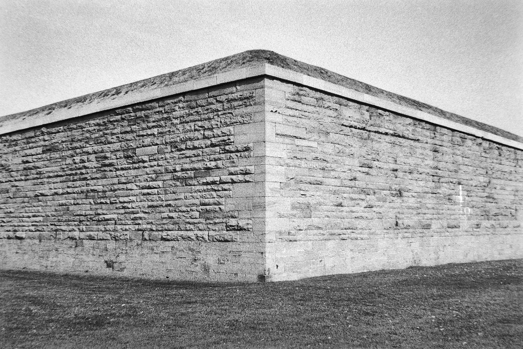

I went through this with a bunch of rolls i shot in the late 70s and early 80s. Expect a lot of base fog and grain. I tried several developers (Rodinol, caffenol, HC-110, pyrocat-hd). Rodinal semi-stand developing works great if you don't mind a lot of grain. It's convenient because time and temp are not super critical. If I were doing it again, I would try Xtol, which is a great developer for most any film, plus it results in much finer grain than Rodinal, and it has a relatively low toxicity. Dilute the stock 1:1 or 1:2 and use it as a one shot developer. D-76 is probably a good choice also. I prefer to just use 2-3 exchanges of tap water at developing temp (usually 20C) instead of a stop bath, and fix with TF-4 (available from Photographers Formulary), which washes out very quickly. I then do a final rinse with distilled water with a couple of drops of PhotoFlo or an equivalent. Let hang and drip dry.
This shot was from the early 80s and developed in 2018. It's TriX developed in caffenol for 75 minutes with a couple of inversions every 30 minutes
Fort Ontario by Michael Teresko, on Flickr
