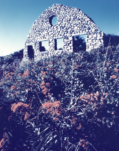

re: RA-4 reversal processing
The result is a typically high contrast image in need of contrast masking with a visible mottle in the background. I have tried it without much success.

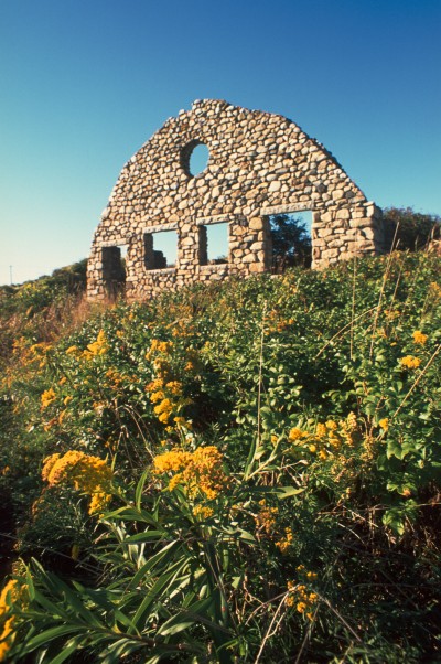

I've tried it a few times, but I'm far from an expert. My success has varied. Some photos seem to produce reasonable results, depending on what you're after; others don't. I'm attaching one of my better results, along with a scan of the original slide. Note that this particular print doesn't suffer from the mottling that's often mentioned as a problem with this process; however, I have seen that mottling in other prints I've tried. I made this print using Fuji CA paper. I'd need to check my notes on processing chemicals; however, the B&W developer was probably either E-72 or DS-14.
The original slide was Velvia 50. Obviously the color accuracy of the print isn't that great. As I recall, when I adjusted for better accuracy in the stones or vegetation, the sky went completely wonky. Since I was just playing with the process, I didn't try all that hard. Nonetheless, I've got this print hung on my wall along with its opposite twin -- a print made from the slide on RA-4 paper with normal RA-4 processing, hence a negative. The sky looks like a Martian sky in that one. I think they make a nice pair; they sort of grew on me after I'd made them both.
