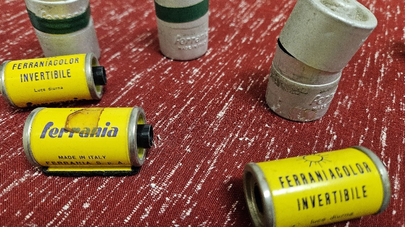

I got given these old rolls of ferraniacolour film here, dated 1959.
I see a note scribbled on a piece of paper that reads cn16 process.
Any chance of being able to develop this film and recover the images?
Would c41 chemistry develop this older film?
Also have an older roll of ektachrome that uses the e2 process.

These films were found in an old shed prior to demolition, i doubt storage conditions were good.
I believe Ferraniacolor is a negative film?
Not too sure if there is much point trying to recover colour images in the ektachrome, apparently the dye couplers were unstable on this early iteration.
So it sounds like the ferrania film has the highest chance of getting results.
That's interesting that it's potentially possible to develop as black and white and recover colour images afterwards.

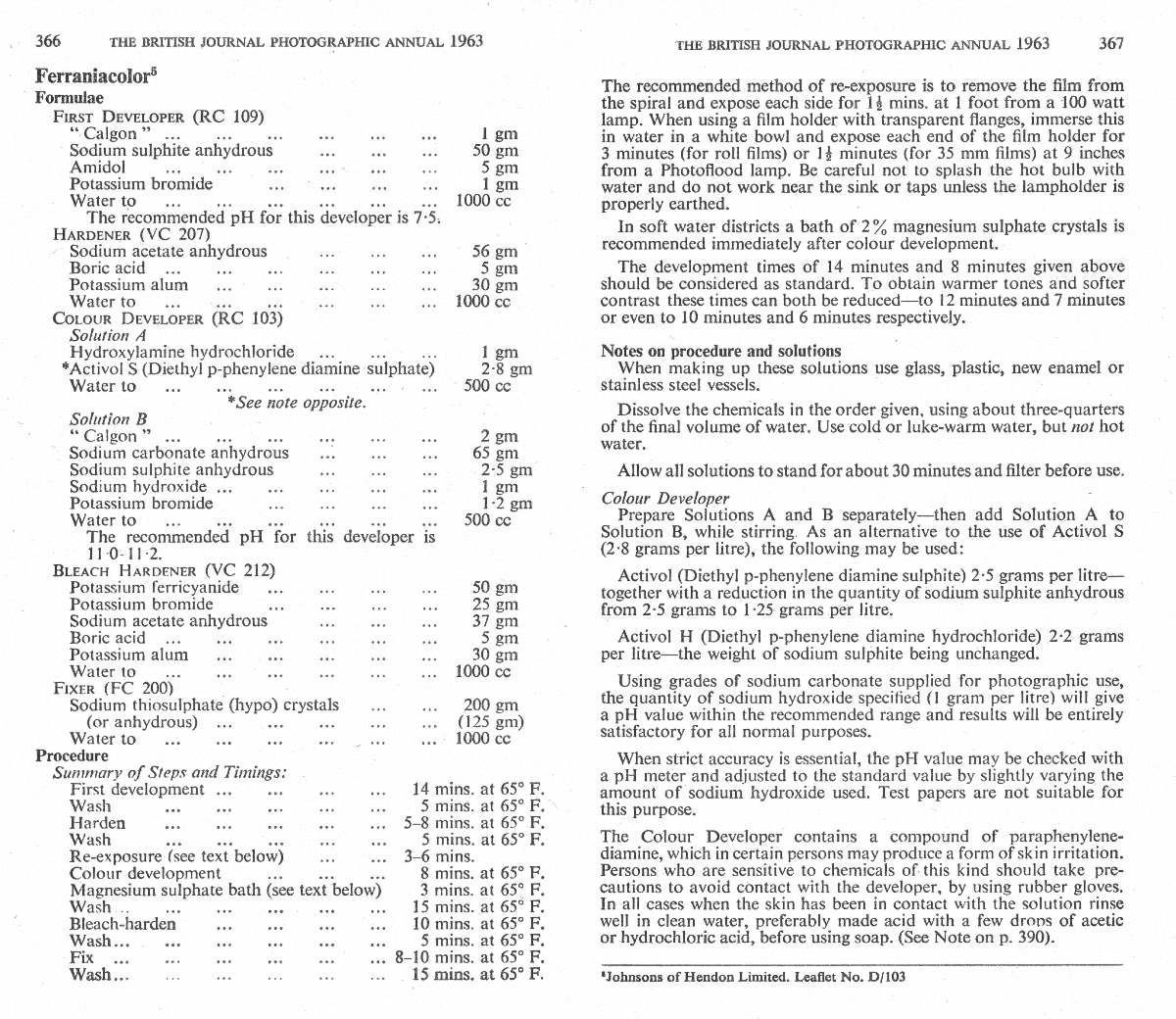

Ferrania CN16 was likely an imitator of early Agfa. I recommend a formula from the The British Journal of Photography.
Color Developer: 75g potassium carbonate or 50g sodium carbonate, 2.5g potassium bromide, 2g anhydrous sodium sulfite, 1.2ghydroxylamine hydrochloride, 3.2g T22 (TSS, CD1) or 6g T32, diluted to 1000ml. 18 °C 8 min.
note: Unlike Kodak C22, it does not use benzyl alcohol. 4g CD4 may also work(the dye hues may shift, but who cares?).
Use a magnesium sulfate bath for hardening(!), potassium ferricyanide bleach(!), and sodium thiosulfate for fixing. This method is suitable for old Ferraniacolor, Agfa CN14, and CN17(their CN17 means 17 Din).

also, it's interesting to see Amidol used in the first developer in the above Ferrania reversal process.

Yezishu
Dec 21, 2024
77
Hong Kong
Ion is right, it's great to have someone who has actually worked with old film.
The key point is to use gentle low-temperature processing and multiple hardening.
Then appropriate developer should work for reversal or black-and-white development. Amidol was used at that time as a high-activity, high-contrast developer.
