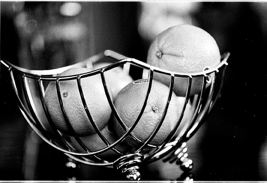

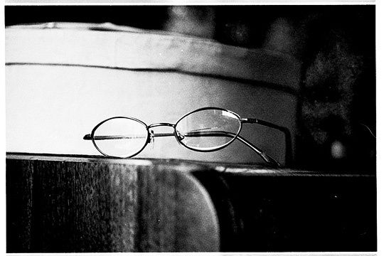

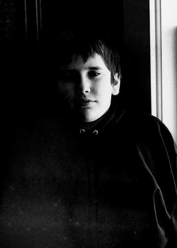

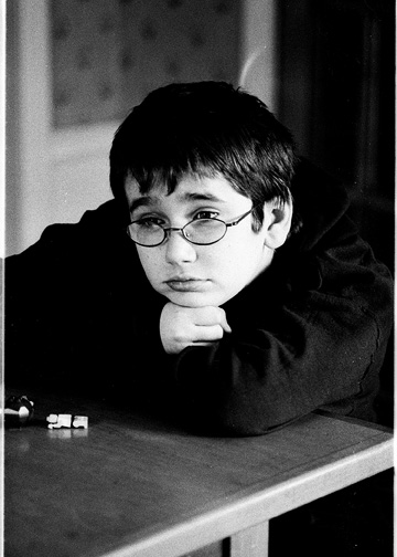

Here are some samples of the negs. Not very good! I tried to shoot in contrasty light to get an idea about development time. Not much detail in the shadow area. I'm thinking I should decrease development to get more detail? or do I increase. The development time was 7 minutes. Thanks again for all of your guidance.
Nancy

Be sure to check the negatives before drawing any conclusions. If you've scanned the negatives and if your scanner software works the way mine does (I use VueScan), the scan should extract detail from both the shadow and the highlight areas pretty well. You might be able to get more detail out of the shadows by increased processing, but that runs the risk of blowing highlight detail. You'll really need to look at the negatives, and ideally compare them to properly developed ones, to know if additional processing is in order.
Some of the lack of shadow detail in your photos might be due to the fact that you pushed by a fair amount. Push processing doesn't turn your ISO 400 film into an ISO 1250 film; it just makes it easier to print the underexposed film. For your next roll, I recommend shooting at box speed, or possibly even a bit under that. (Many people find that many films work better when exposed at 1/3 to 1 stop under the rated speed, or sometimes even less than that.)
Lack of shadow detail can also be caused by excessive contrast in the original scene. Film doesn't have an infinite dynamic range, after all. Some of those sample shots do look like they're pushing matters on this score.
One unrelated comment: I noticed a few flaws related to handling. In the first photo, there's a light curly thing that looks like it's sprouting from the boy's head. This can be caused by film buckling as it's loaded. I'm not sure of specific film-loading techniques to avoid this, but I know that I had a few such marks in some of my early rolls but none after the first few. The second photo has what looks like fingerprints. Be careful not to touch the negatives, especially on the emulsion side. Lint-free cotton gloves can help prevent such marks.
The trick in contrasty situations is to overexpose and to underdevelop. Try EI200 and 20% reduction in development as a starter.
