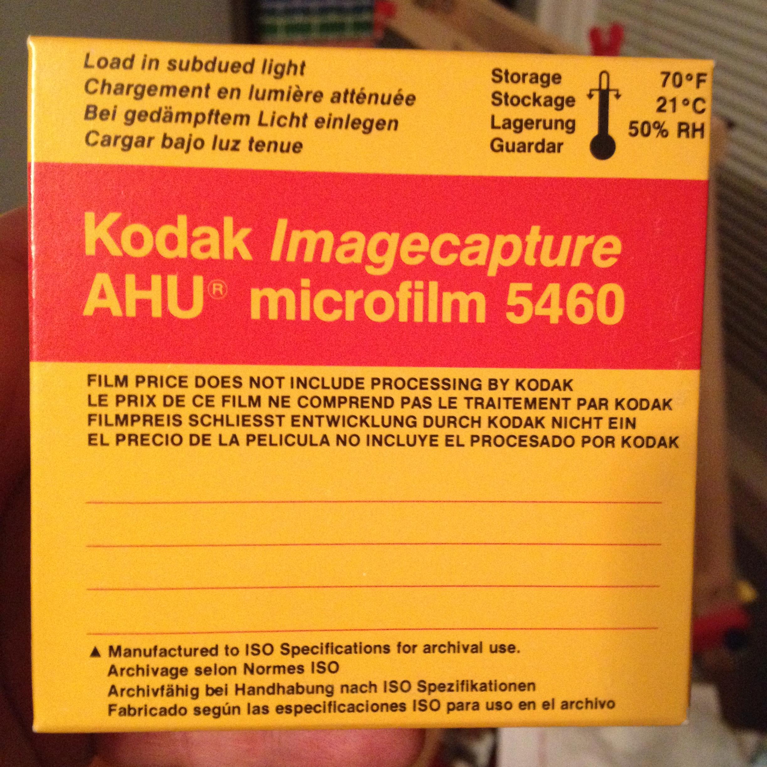

Microfilm rating and use
Hello APUG,
I have been gifted 400' of this film, "Kodak Imagecapture AHU Microfilm 5460." This film is long expired (1986), but has been stored well. Can anyone tell me if it might be useable for regular pictorial shooting, what a general ISO range might be, and which chemicals would be best for processing?
Thanks for your help!
- rwreich

The 5 in the 4 digit code indicates that it is 35mm. It probably isn't perforated like most microfilms so you may need a camera that can handle it. I would test it and treat it as copy/ ortho litho film and shoot it at a very slow speed.
Truzi
Mar 18, 2012
2,625
I have some copy microfilm that is only about 5 years old. I find using it with an EI ("ISO") of 3 to 6 seems to work. Someone may give you a better EI range, and you may find a spec sheet online with some information.
You probably won't get good continuous tones, as the film was not made for pictorial use. That said, it can be fun, and you can get some interesting pictures. I have a friend at work that just loves the results.
Your film is much older, but was probably very low ISO as well, so it has probably aged gracefully.
My Sears KS-2 (Ricoh XR-7) can handle it without the perfs. Flatness is not an issue (the pressure plate helps with that), but the frame spacing can be a bit inconsistent without perforations. However, the frames don't overlap. Since it was given to you, and you have 400 feet, just try some. Sacrifice a bit to test in your camera with the back open so you can see if it advances well. If your camera can handle it, load up a cassette and try it. Bracket your photos, perhaps from EI of 3, 6, 12 and 24 to start. Develop, and go from there.

A brief search on this film indicated that it is not perforated. This is usually the case with microfilm. It could be slit for Minolta 16 cameras or for Minox cameras. Other than that I see no real use for it.

Hi,
I've attached the datasheet for the successors to the 5460 film that you have. Since you are calling it Kodak and not Recordak it must mean that the film was from the 80s. This is an extremely fine film that has medium contrast, not high contrast like a lithe product but now low like a proffessional black and white film. The ASA speed is down at about 1. It should work fine in low contrast developers like Rodinal or HC110. It should make some very good pictures if treated right. If it has been frozen all this time I would expect it to be still good.
By the way, this film is still produced for the archives and preservation folks as Imagelink 114NXHU and is available from Eastman Park Micrographics or their distributors who took over this business from Kodak in 2011.
