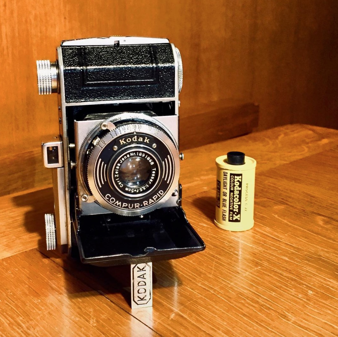

Hi guys,
This Christmas I found the Kodak Retina of my grandfather (I think...). The camera had a roll of Kodacolor X that I would like to process it. Do you think it may develop well in B&W Pyrocat HD? I only make B&W and Pyrocat is my favorite developer. If not I have Ansco130 or maybe somewhere D-76...
The camera, in very good condition, I suppose is a Kodak Retina type 126 with a Carl Zeiss Tessar 1:3.5, 5cm. Am I correct?
Cheers,
Ferru

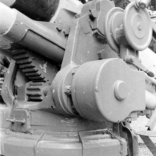

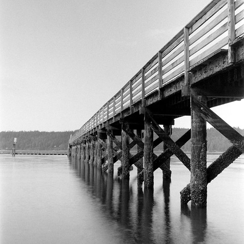

I got good results developing it in beer, it’s similar to a caffenol recipe so that may work as well. The film below was expired in 1973, I cut the exposure index in half for every decade out of date. I have also had good results developing old color films is Rodinal, semi-stand 1:100 for an hour.
The Recipe:
Beer (cheap Lager, I used Fosters) - 12oz
Sodium Carbonate (Arm & Hammer Washing Soda) - 2.75 Tsp
Ascorbic Acid Powder (Vitamin C) - 1.25 Tsp
Salt (Morton's Iodized Table Salt) - 1/4 Tsp
Developed at 20 degrees C for 20 minutes. Agitate first 30 seconds then 15 seconds every minute. Normal fix.
Warning - Add the Ascorbic Acid after the Sodium Carbonate to avoid a foam explosion.
