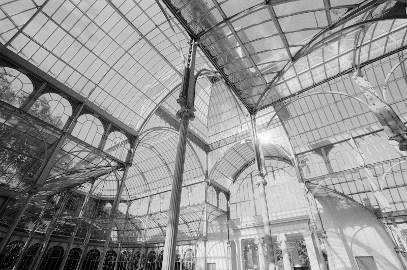

RPX400, 35mm Instant Mytol 1+1 12 minutes, manual agitation (Paterson tank)
RPX400 35mm Pyrocat HD 1+1+200 minimal agitation; 3 cycles at 20 minute intervals
RPX400 35mm Pyrocat HD 1+1+100 15 minutes rotation in Jobo
RPX400 35mm Instant Mytol 1+0 8 minutes rotation Jobo
All scans with Minolta Scan Dual IV at 3200dpi. Images are sharpened with USM for crisp grain (not necessarily image detail).
As you can see, the first example of the glass greenhouse in the El Retiro park in Madrid is pretty darn grainy. The cause here is mostly because it's a very dense negative. Variations in development also give some variation, but it's much more subtle.
If you're optimizing for grain, you need to nail exposure. This IMO is really the main thing. With development you can nudge things left or right a little, but the main impact (given a particular film) is how you meter the scene.
RPX400 as such is not a super-fine grain film, but it's quite alright; HP5+ definitely has an edge on it in this respect as well as effective film speed.
Of course how you scan (or print) and post-process makes a huge difference, too. I could have presented the above as almost grainless, buttery smooth images if I had scanned them with my flatbed at 1600 dpi.

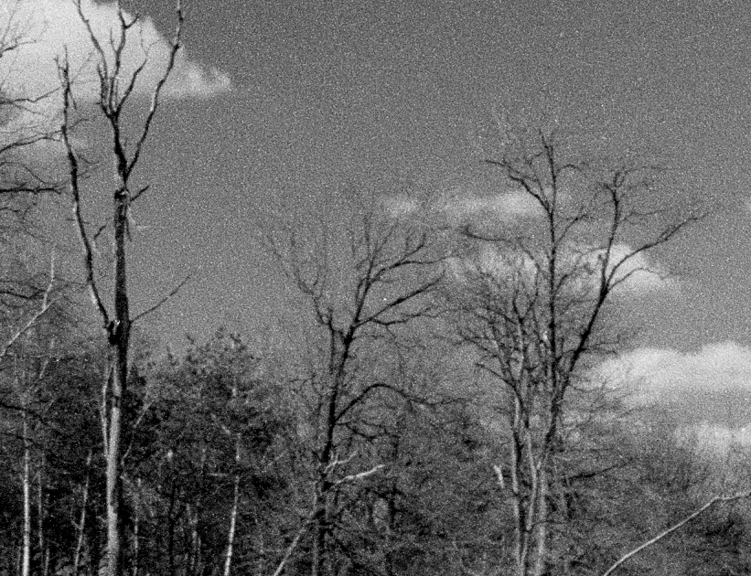

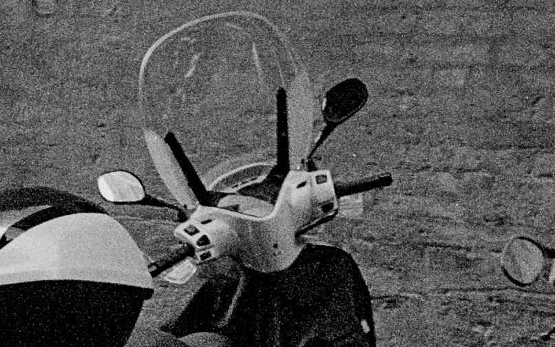

For me, overdevelopment is not such an issue, but overexposure. I had much better results at ISO 800 than at box speed. Development in Adox XT-3, 1+1, 16 Min. with Ilford agitation.

IDK the cause as it can be several but you have lots of blocked up shadows as well as blown out highlights in the example you posted. Maybe the print is different. The digital version I would personally consider highly problematic if it were my work.
