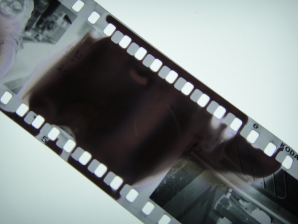

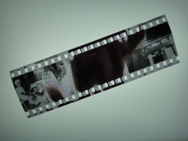

So I managed to mangle a film pretty badly (buckled edges) when it got jammed on a plastic reel, so I took it off and loaded it onto a Hewes and then developed it
Then...this happened
What happened here?
Looks like developer didnt even go near that spot
There is no other damage on other parts of the film
The first few frames show some undeveloped spots on the rebate area too

The film ended up overlapping itself - if two sections of film are stuck together, the chemicals cannot get to the emulsion.
Every developing reel depends on the integrity of the edges of the film - if you have buckled edges it is difficult to ensure that each part of the film is in a separate part of the reel's spiral.
I would recommend re-fixing and re-washing the damaged portion. That will remove any undeveloped emulsion.
Looks like the film was misloaded, and this portion was touching another. Happens easily once a film is mangled or buckled. Part of the learning curve. We've all done it....
It does look like the film was touching another part of the roll, and chemicals couldn't get to it.

Well, I threw that clip back into fixer and wow, there's some detail left in that frame on the left! Washed and is drying right now
Thanks
I literally had thrown this in the trash and dug it back out
