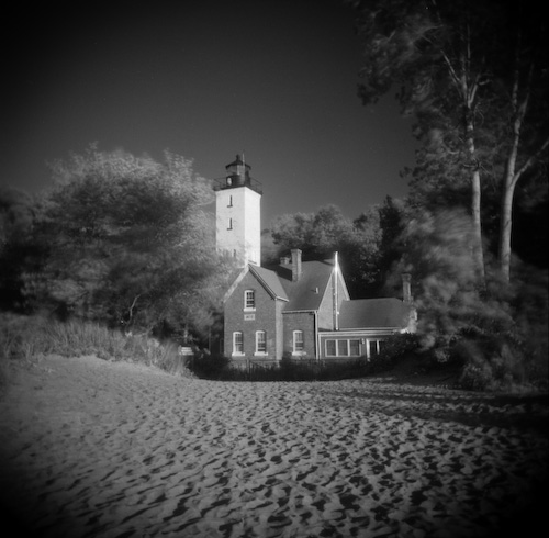

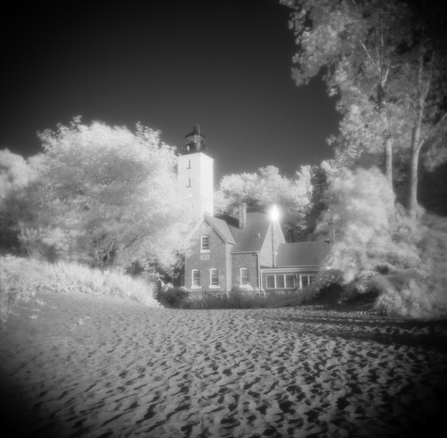

FWIW here are some side by side examples of shooting Efke IR820 with a Hoya R72 and with a regular Red #25 filter
first the Hoya R72
and then the Red #25
both were shot in full sun, on medium format film with a cheapy Holga Camera exposure was around 1 second. They were developed with Diafine, but I have also had great luck with semi-stand 1:200 Rodinal. I have also never had any issues developing many hundreds of rolls of IR film using plastic tanks either Patterson, or the generic AP brand that Freestyle sells under their house "Arista" brand.
