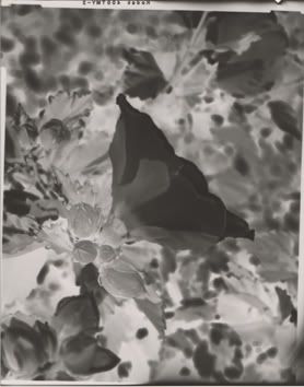

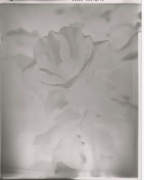

Alrighty guys,
I processed a few sheets of film yesterday, and before I started I took the temperature of the water I was using. It was about 70 degrees, and that's after I let it run for a few minutes. So at a temperature of 70 degrees, according to Kodak's HC-110 information page that should take about seven minutes with continuous agitation. However, the negative turned out extremely thin. :sad:
So I tried using a shorter developer time. To experiment I used a development time of four minutes at the same temperature, because this stuff seems to develop my TMAX rather quickly. The negative has some density now, sooo yeah. I'm thinking that this is all because of the temperature of the chemistry. I'm also upset that there are light leaks in my holders.
I scanned them for you to see. Top one was developed for four minutes and the bottom one was seven minutes.

To start, you are loading the film into the film holders incorrectly..
What Greg points out makes sense. The top shot, which is denser, has the words 400 TMY-2 mirror-image but the thin negative has it "right-reading". Meanwhile the shadows from the film holder look about the same. This implies your thinner negative was put into the film holder with the back facing frontwards.
Use the notches as your guide when you are feeling your way in the dark. Make sure the emulsion faces the front of the camera when you load it!

It doesn't make much sense either. I've been thinking about that all day and to MattKing I did not switch the scans. I'll talk to my instructor in regards to the bellows factor and try to clear that up. In the meantime I'm going to avoid photographing flowers and try something else.
I've been loading the film with the notch in the bottom left corner, as seen if it were portrait orientation. So the reason why the film info is backwards is due to my scanning it. It's nothing fancy, just a flatbed Epson scanner that was merely to show illustrate my concerns.
