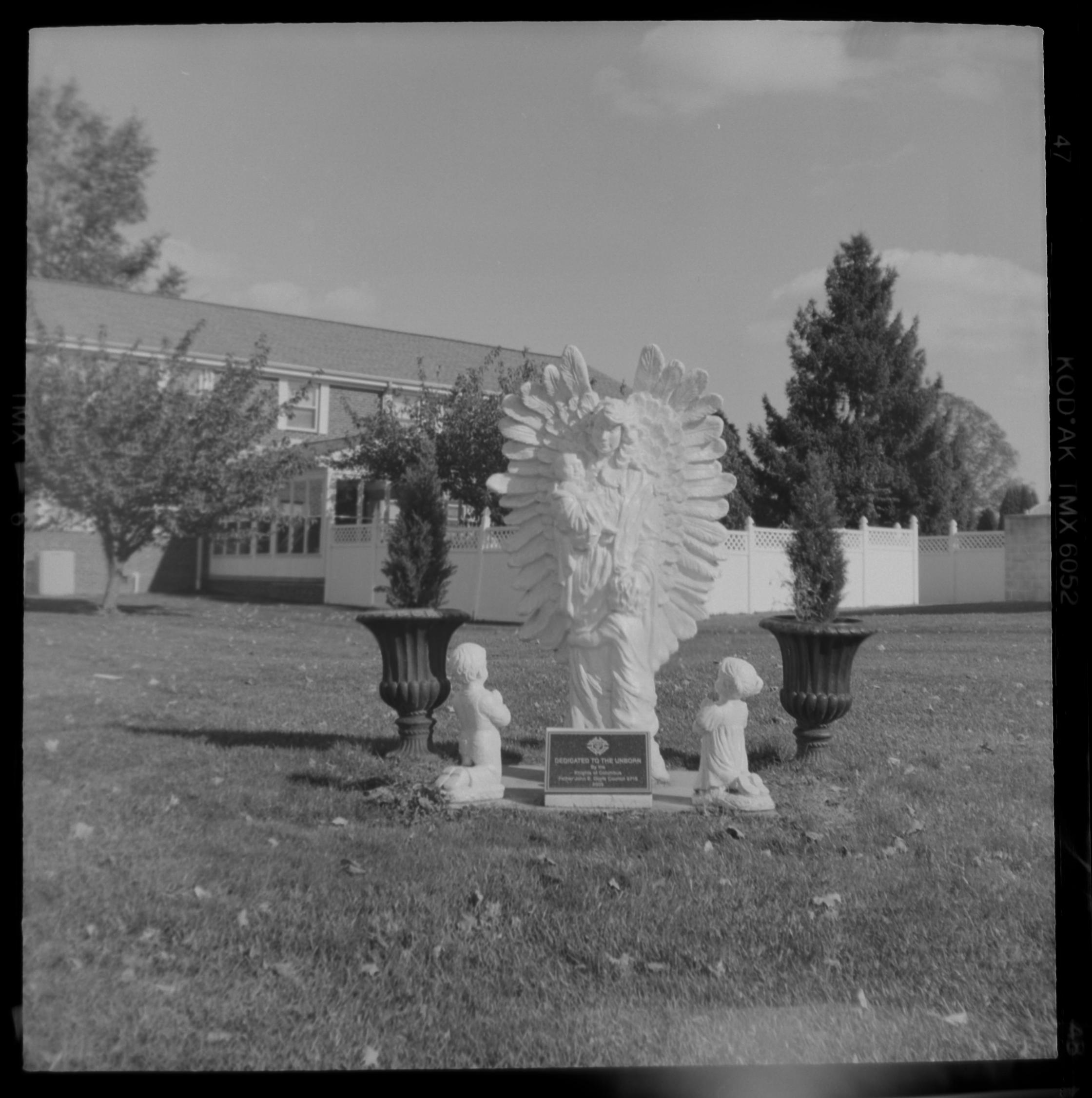

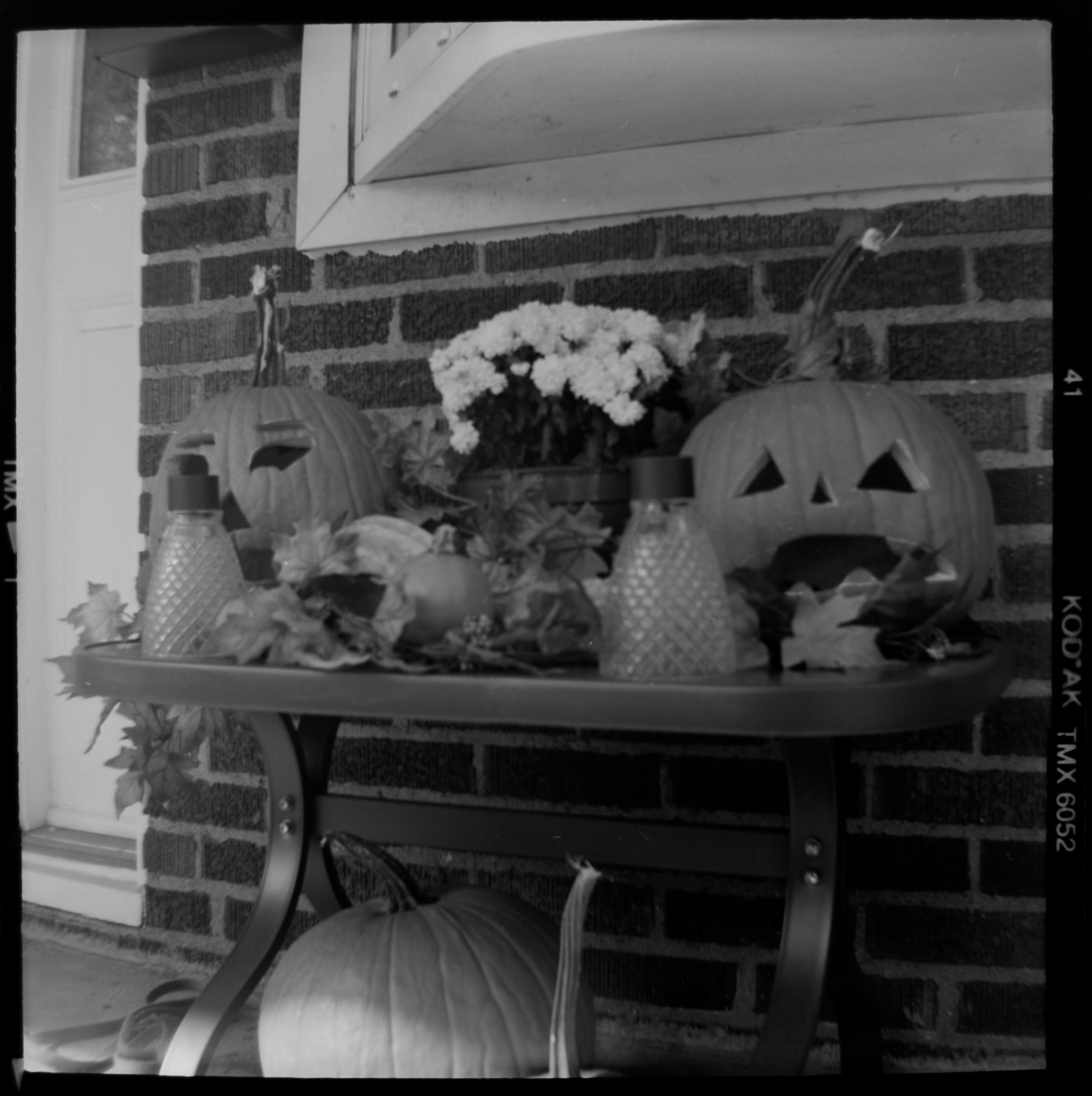

Here are a few of the pictures I developed. D-76 for the recommended time. All photos taken with a Kodak Brownie Hawkeye Flash model. Not bad considering how expired the film is and the age and condition of the camera. I picked up the Brownie for 50¢ USD.

How bad was the base fog compared to new film?

I didn't notice any fogging. Because the Brownie only has one shutter speed some of the images were overexposed and some underexposed, which i expected. I'll load the next roll in my C33 so i can get a few more accurate exposures but i think they'll be just fine. Most of the feedback i got when inquiring what to expect was that it would develop ok, and it did. I want to see how it prints, but my darkroom is not setup yet. I believe they will print well also.
