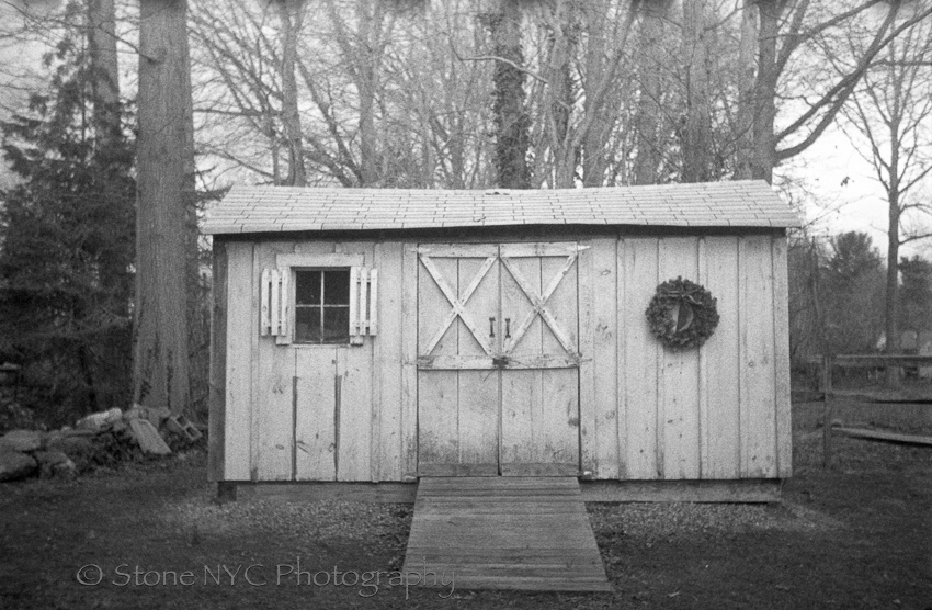

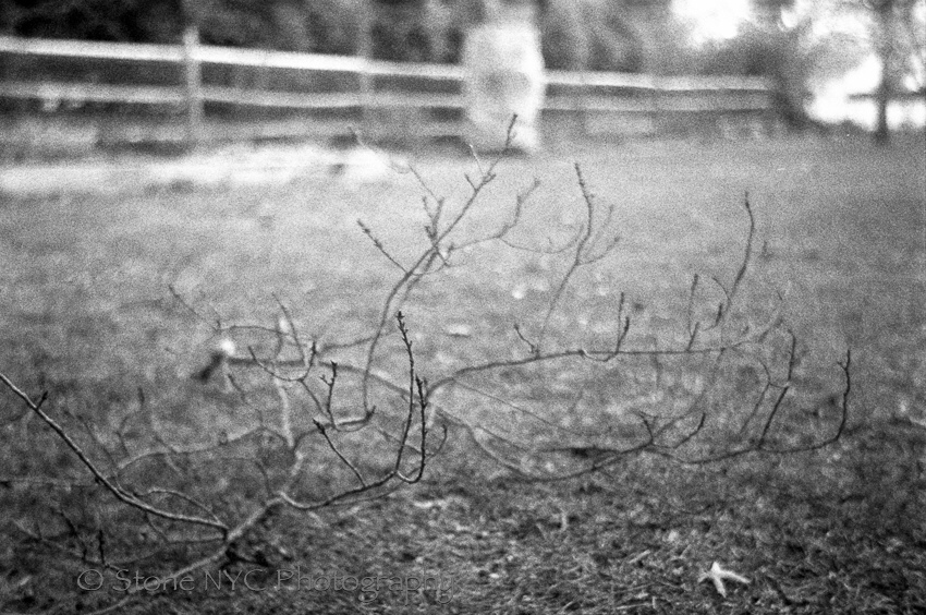

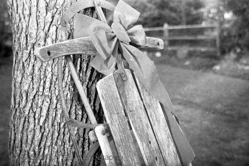

Gold200 in my stand developed Rodinal 1:100
I figured actual examples would help you instead of a bunch of random suggestions.
Ignore the perf holes, it's not bromide drag it's the film gate of the contex contamatic being off center.

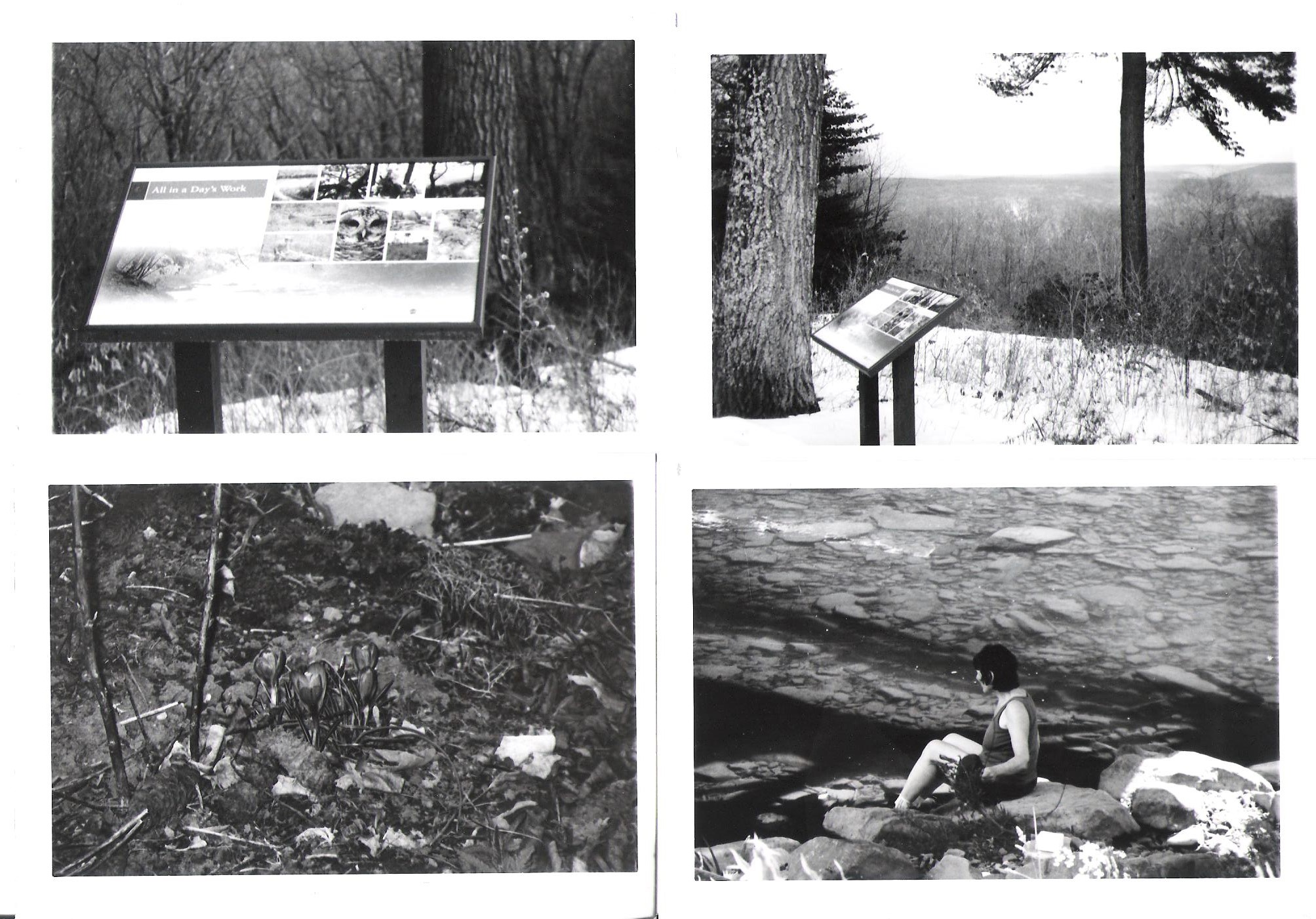

These are random images from the film left in an Olympus mju. I don't know how old it is, one shot was from me finishing the roll. Film developed in D-76 1+3-30 min. stand 20c, 30 second initial agitation no more after that. Prints are on Kodabrome F5 paper developed in LPD. I shot one test strip to see if my settings were close enough to make prints, straight scan of prints (4-3.5x5)no manipulation on the enlarger or scanner. I could have used grade 4, but the grade 5 was handy.

Thanks Rick. I had no idea that images would come out so well. I've been hanging on to old exposed rolls of c41 film, not wanting to pay for commercial processing for film that I've forgotten the subject matter of.
