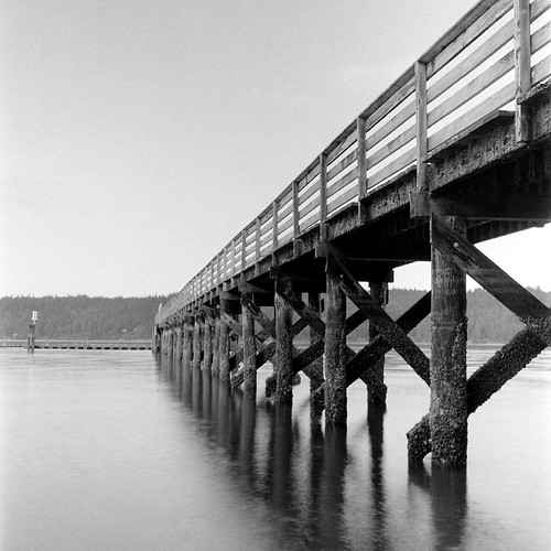

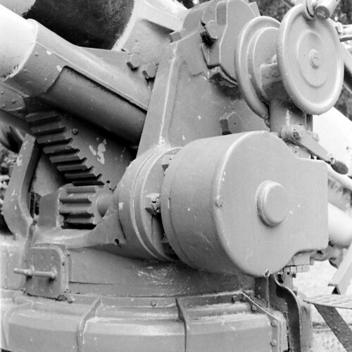

Below are two shots I did on Kodacolor-X that expired in 1973 and developed as black and white. They are 127 film shot in a Baby Rolleiflex. You will probably have more fog on the older photos, the rest will depend on storage of the film. Since the film was opened and exposed to air there will probably be more fog on the edges, mine came from a sealed package. These were developed in beer but any black and white developer will work. I did some digital manipulation to get these images looking like they do now, the negatives will be a bit dark, probably not good for printing but ok for scanning.
Illahee Pier by Bryan Chernick, on Flickr
Gun at Illahee State Park by Bryan Chernick, on Flickr
