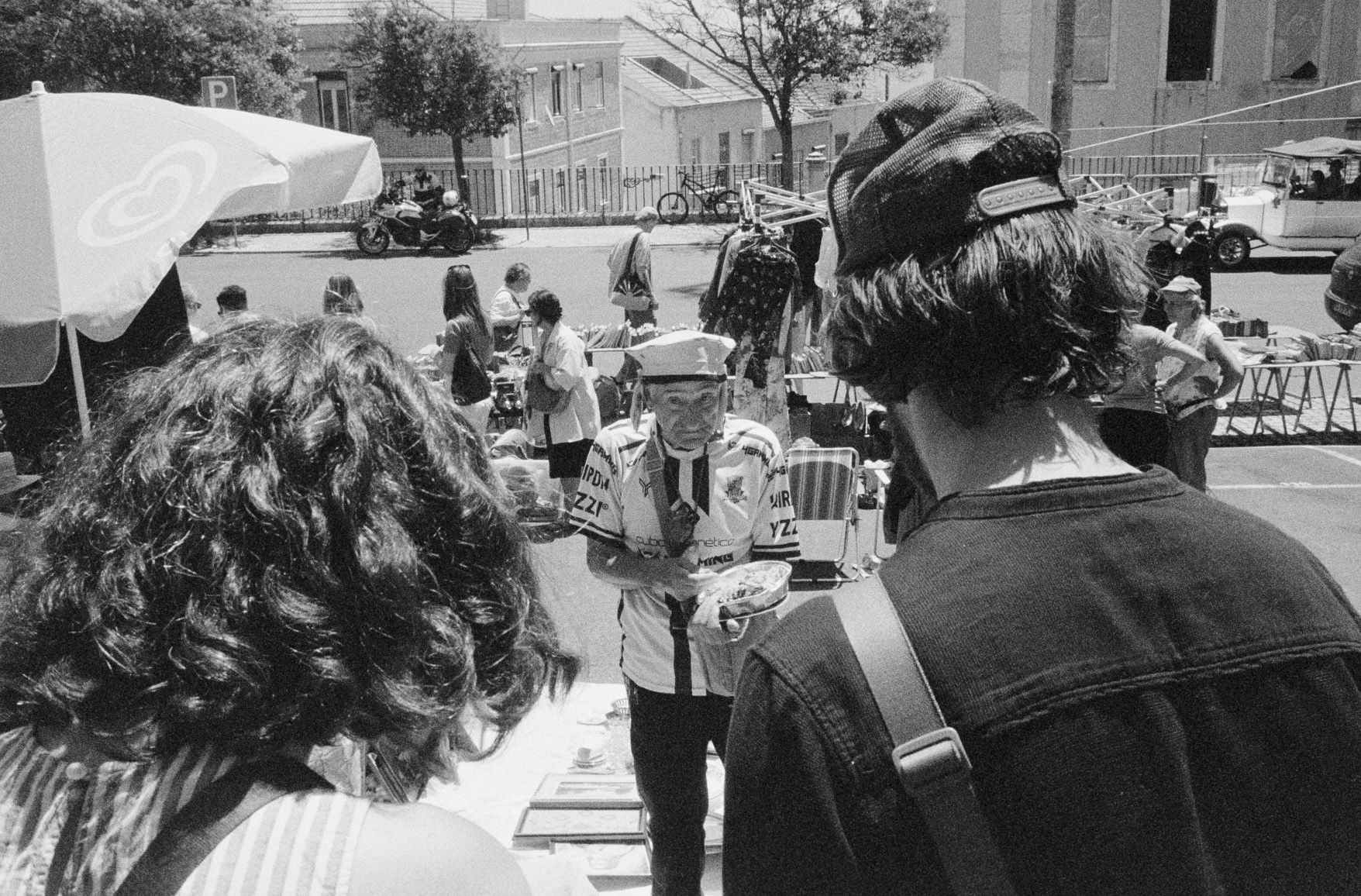

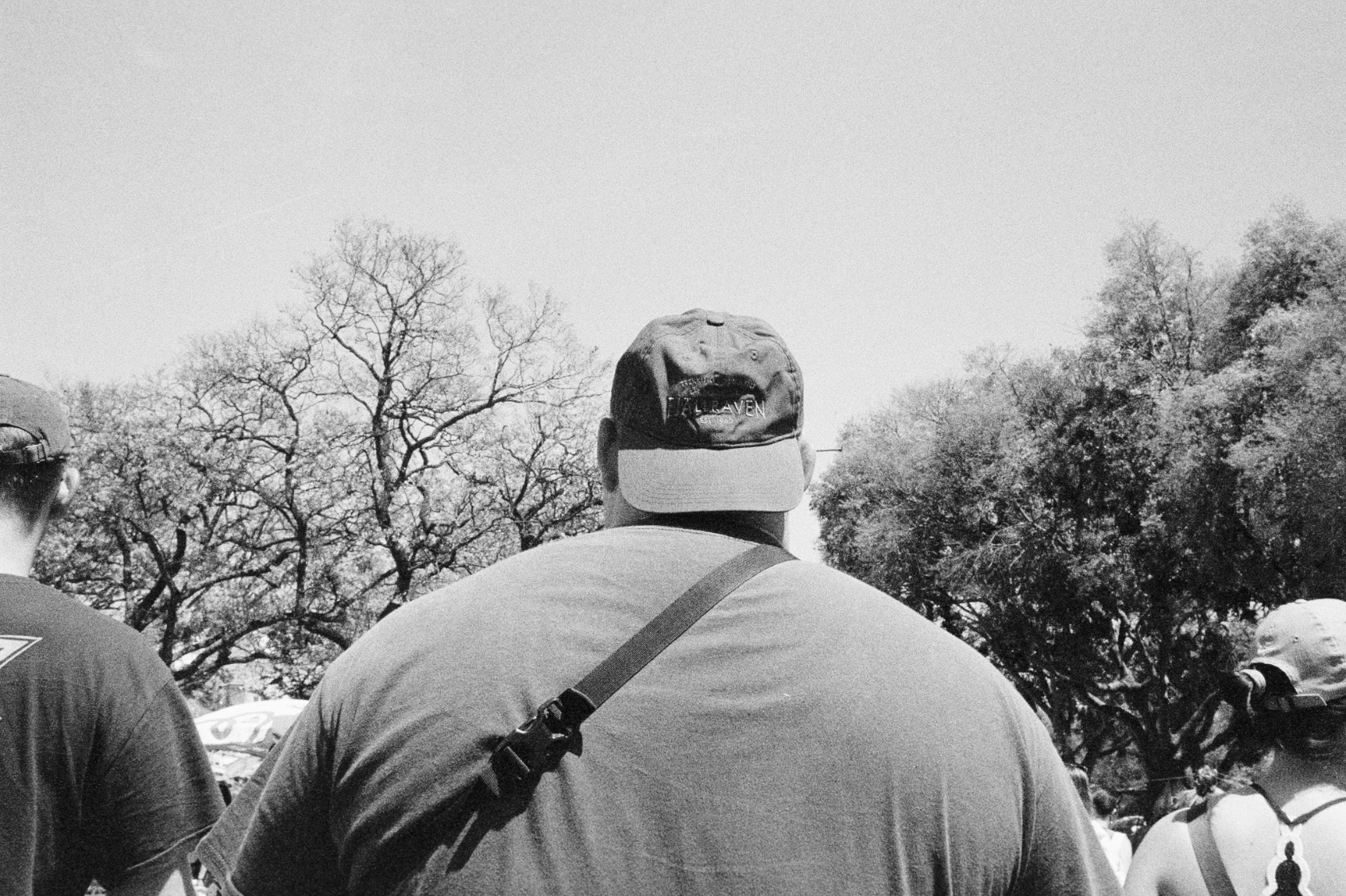

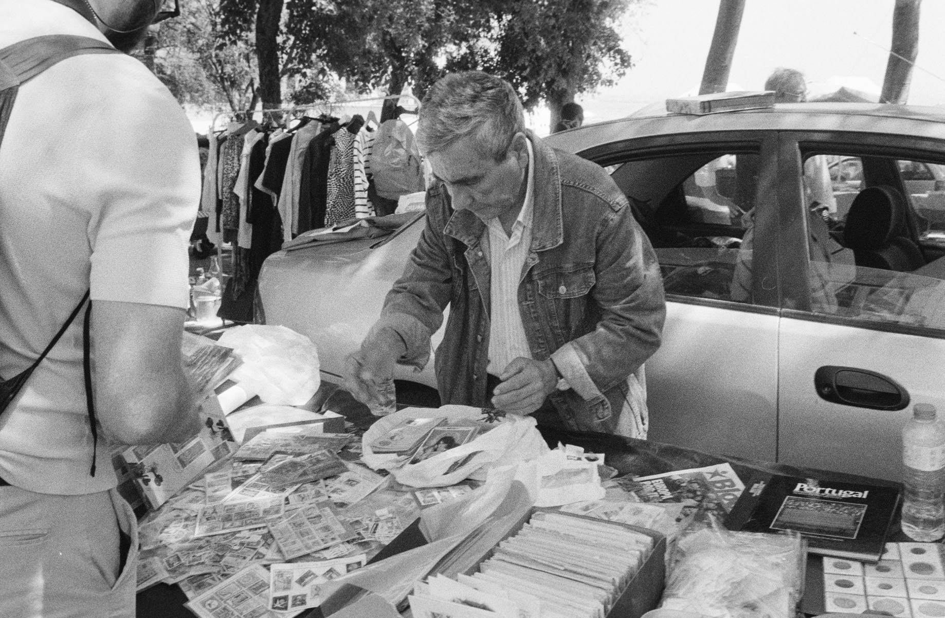

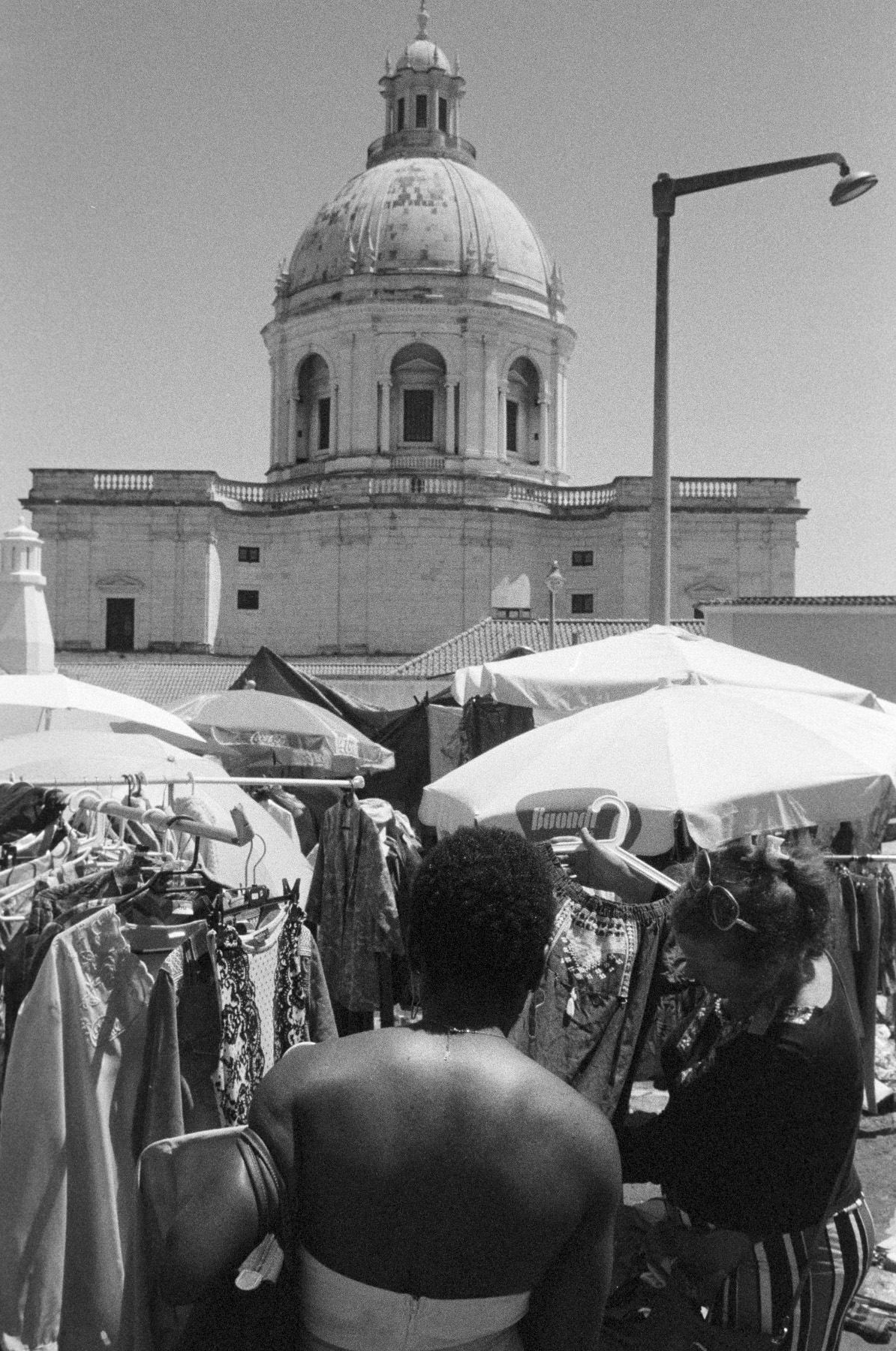

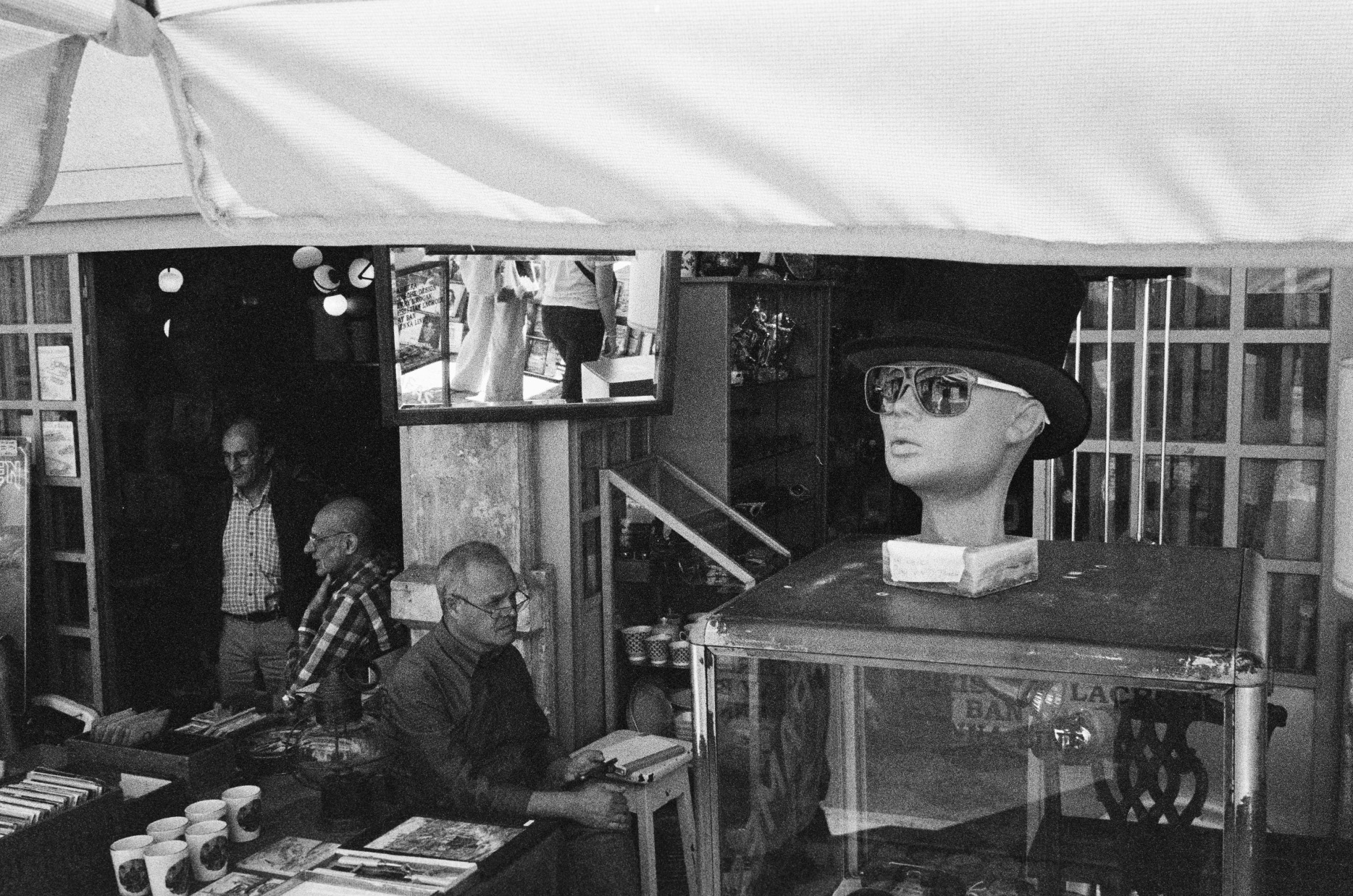

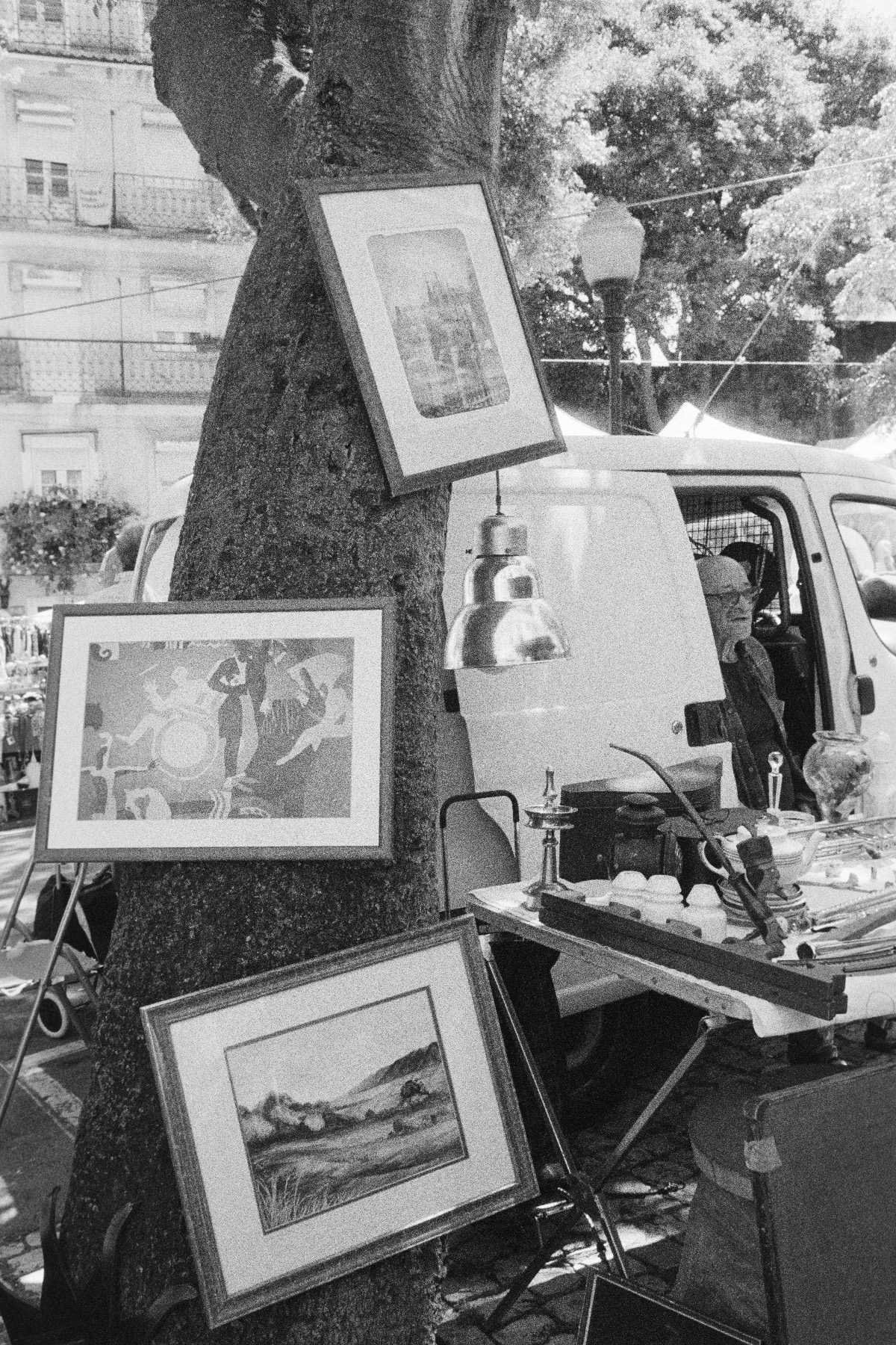

I don't know if I underexposed it, or if this is how it's supposed to be. Since the negatives were quite flat, I had to bump up the contrast significantly. I like the results, it's classic, but if I ever print it in the darkroom, I would probably never be able to achieve this level of contrast. I'll shoot another roll at 800 and push it by 1 stop next time.
I agree it's probably better/cheaper to shoot HP5 at 800 or 1600 for similar results, but I'm testing, learning, and playing.
