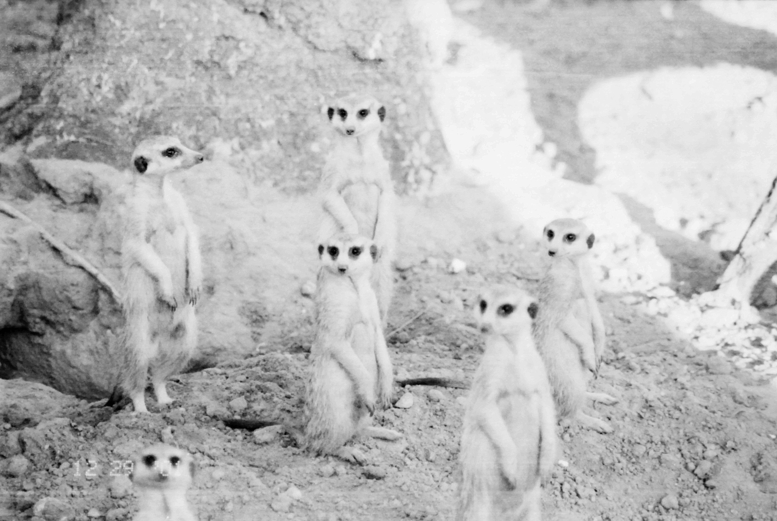

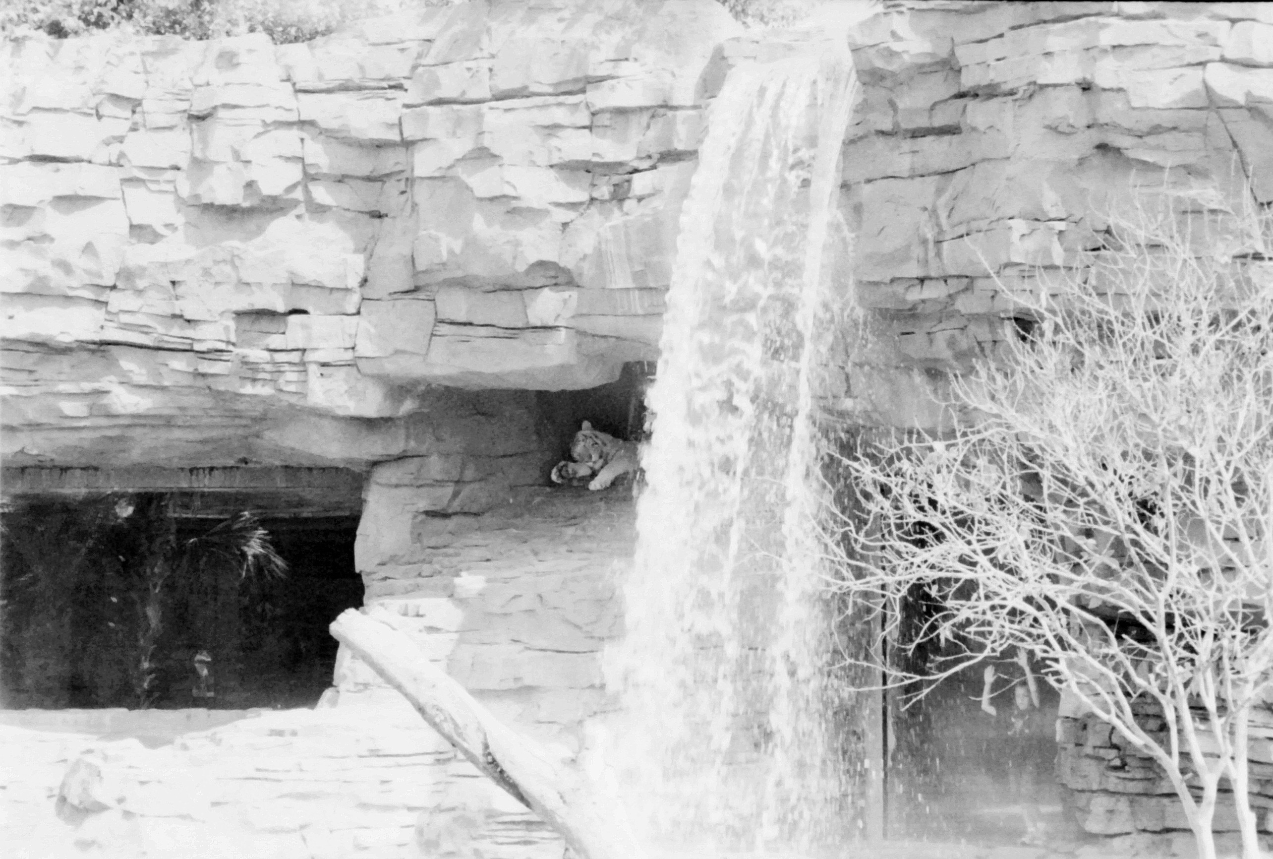

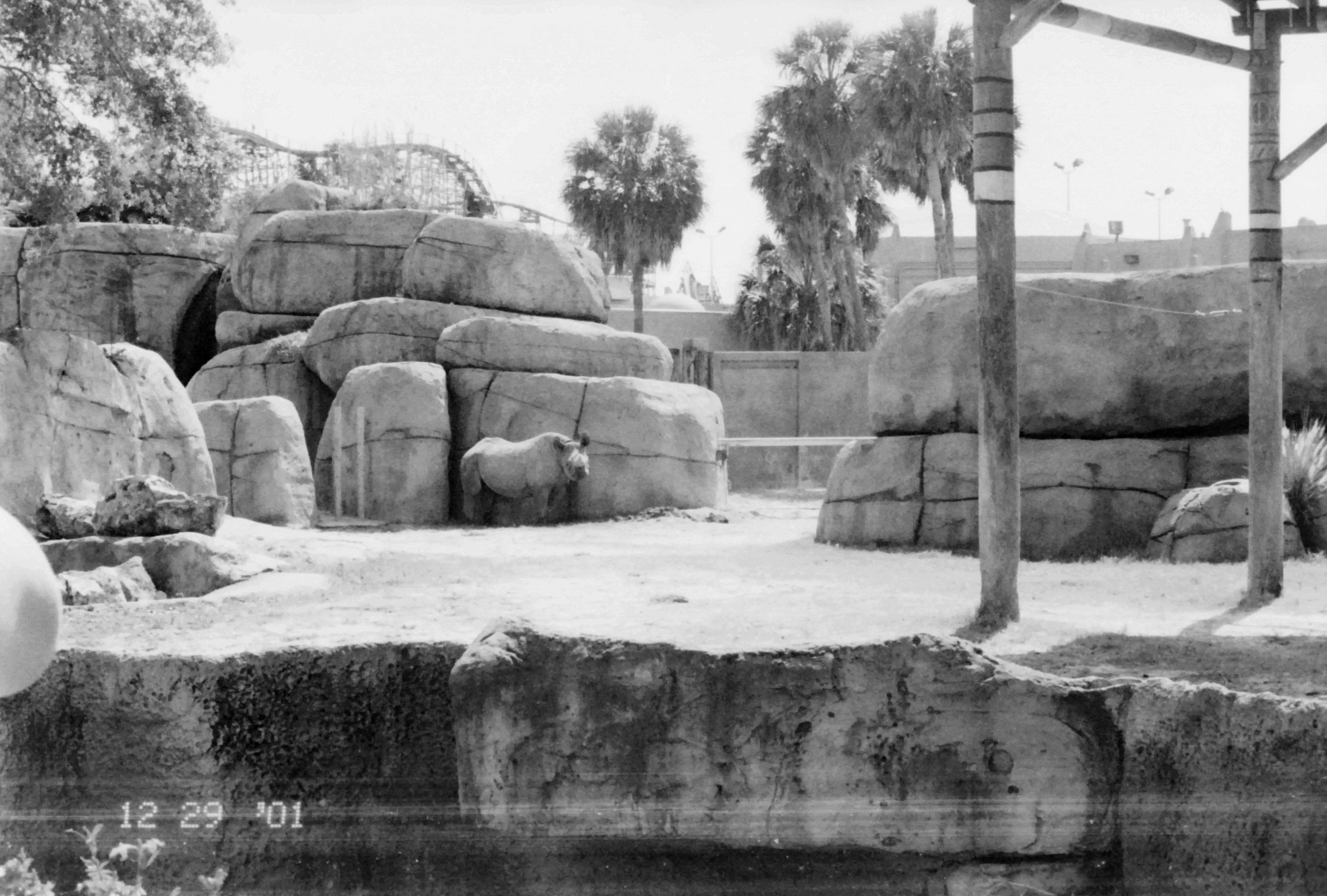

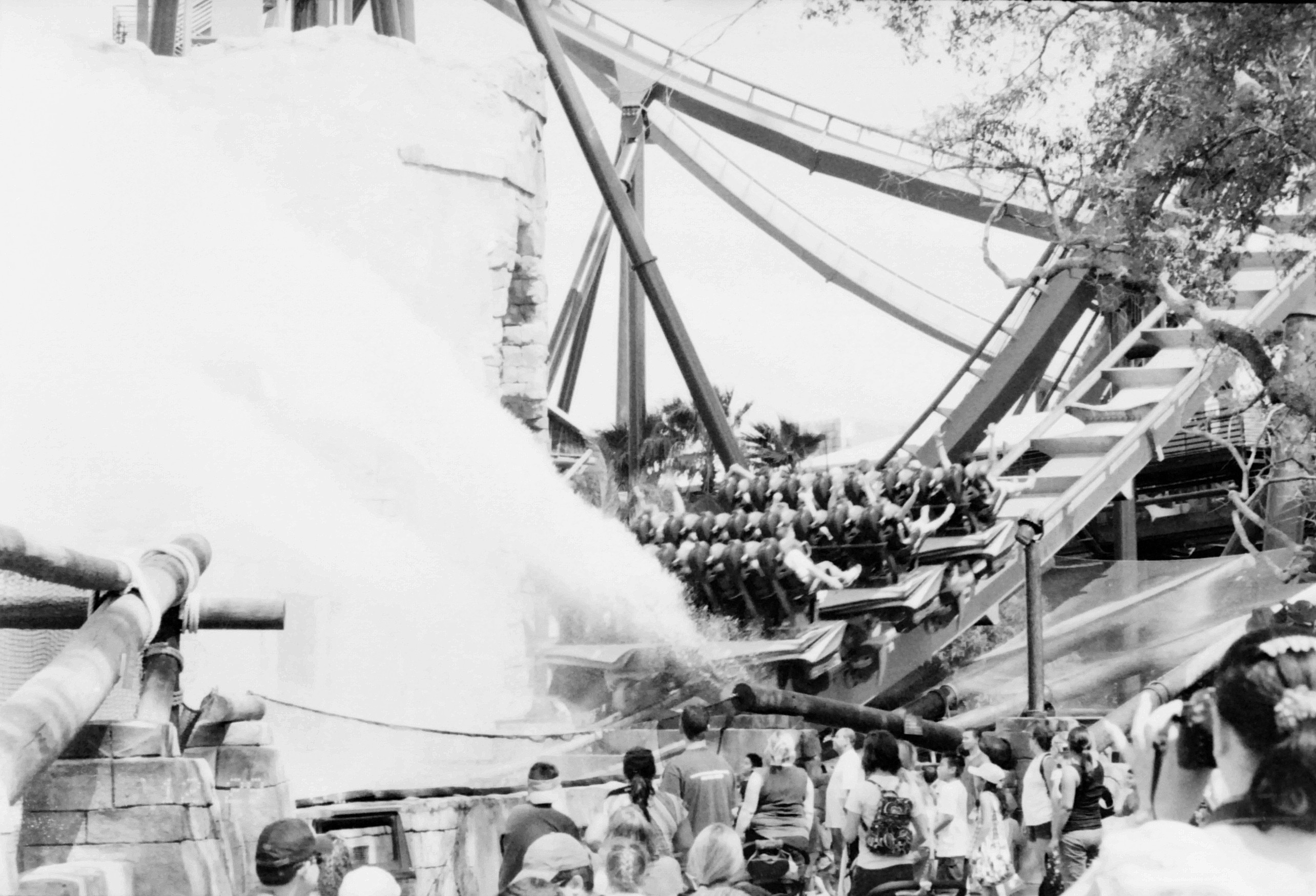

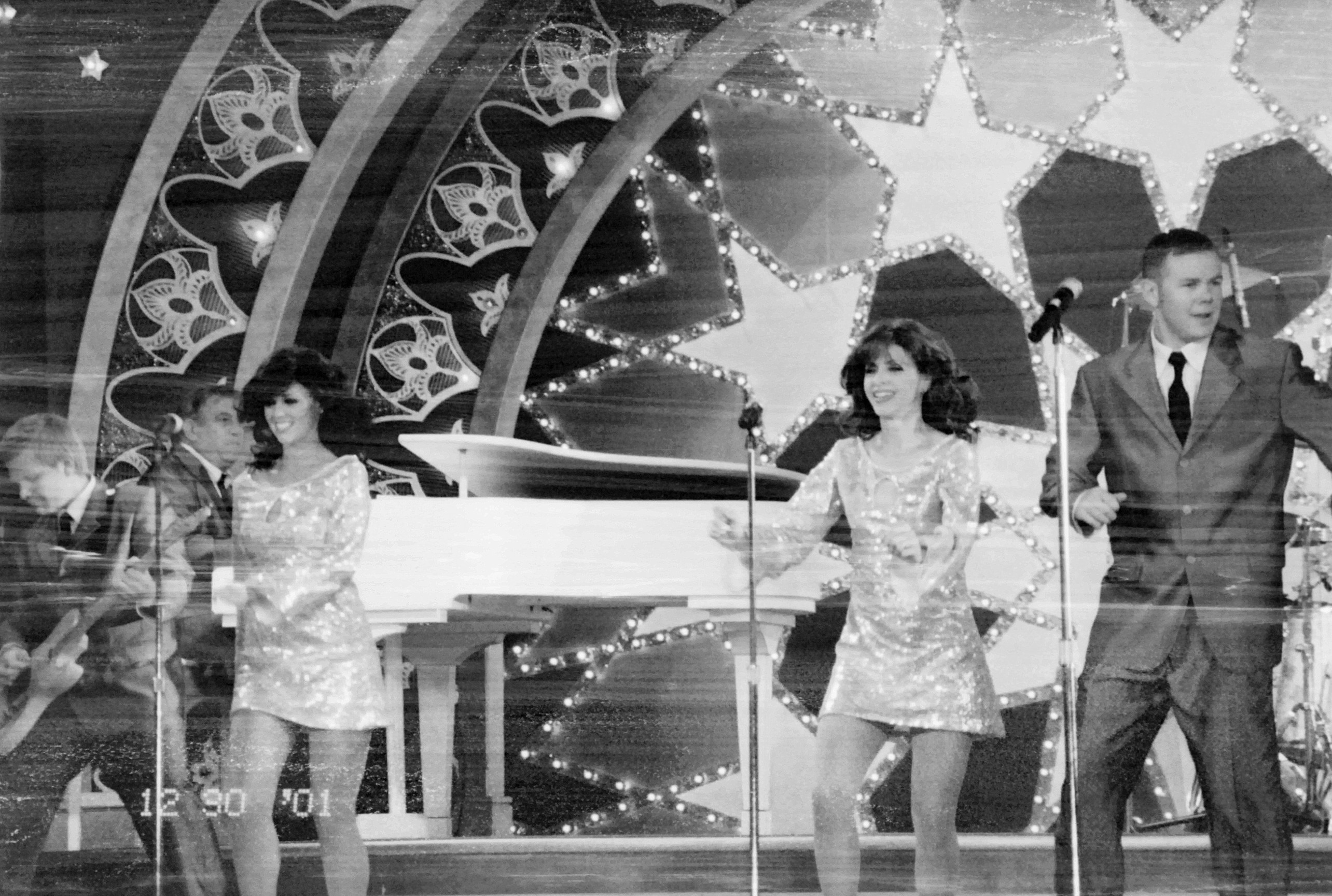

So I went ahead and developed a roll. Kodak Gold 400. Turns out to have been shot Dec 29 & 30, 2001, so 13 years old. Here's what I did;
All temps were at 78°F unless otherwise noted
Pre-rinse/soak for 2 mins
HC-110 Dilution A [1:15] for 12 mins, agitate continuously for first 30 seconds, then agitate for 10 seconds every minute
Stop with tap water acclimated to working temp for 1 minute with continuous agitation
Fixer (Photographer's Formulary TF-5) 1+3, for 5 minutes, continuous agitation for the first 30 seconds, then let it sit
Final Rinse with tap water (about 80°F) for approx 5 minutes, with 2 fill & dumps, and a fill fill & dump with 1 drop dishwashing detergent (Dawn).
At first glance, they looked good. I could see definitive images, and hung them to dry. I don't have a negative squeegee, so I ran the film through my fingers, and went from there. The final results were actually really good IMO.
The roll seems to be from either Busch Gardens Tampa, or one of the Orlando theme parks. There were a few shots that were just taken poorly (flash against glass in a few), but overall, they are decent.
Here are some samples:
I have a question;
When the film was close to dry, I looked at it, and noticed some white spotting or water stains. A quick websearch, and I took a lightly dampened, lint-free microfiber cloth, and gave it a quick and gentle wipe. On the emulsion side, I seem to have wiped off some grey/black stuff. My first thought was that it was the silver, and the image, but the image stayed. What was that stuff? I caught it after wiping only a few frames (the first 3 above were in that group), and only wiped the non-emulsion side after catching that. The last two frames above are from that group, and you can see (especially in the last photo) lots of streaking. I'm thinking I should have wiped both sides of the entire strip.
So what do you all think about my first attempt at C-41 developed with B&W chemistry?
