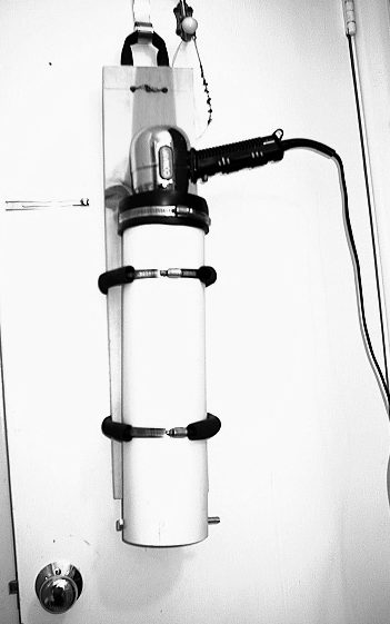

I've been doing darkroomless film processing for several months now, since I'm between darkrooms. My recipe is to use a changing bag to load up, then process in Diafine, do a couple of water rinses, fix (fixer choice is irrelevant, but I use TF-4 'cause I like having an alkali line). I've recently started washing film (there was a url link here which no longer exists), which requires no running water, and it seems to work great.
For drying the film, I use a wetting agent of dilute photo flo with some isopropyl alchohol thrown in and dry my film in the dryer pictured below and described here. It's the most dustless I've been yet. Eventually, when I get back into 4x5, I'll invest in some 4x5 reels solely so I can dry my sheet film in this dryer.
I use diafine because I've yet to find a film that it won't process. As a rule, I run Tri-X exposed at EI 400 (even though the box says 1600 and folks say 1200), but I've run Plus-X, HP5, FP4 and they all use the same development time (I use 4mins each of A and B with a sharp rap of the tank at the start of B followed by a minute of no agitation, but the box says 3min) and temperature isn't important within reason. hell, we even experimented and got some dollar-a-roll cheap color (C-41) film at Walgreens and ran it and got slightly more grainy b&W negs (probably overexposing a stop and shooting at 200 would help there).
Diafine is a use-it-until-it's-sludge-then-use-it-some-more developer. We just keep pouring it back in the bottles, and the only developer that goes away is that which either spills over the top of the tank when filling or soaks into the emulsion when processing. I've read of folks using the same blackened, sludgy diafine for a year or more.
We just keep our processing bottles at the back of a kitchen counter and basically we can process film at the drop of a hat with no darkroom. Next road trip, I'll downsize the setup to a dairy crate and some mason jars and make a mini-dryer that'll only do 3-4 reels (so it doesn't look like i"m sneaking a bazooka into the motel) and I'll be able to process each day's film during the vacation -- maybe even do POP contacts.
