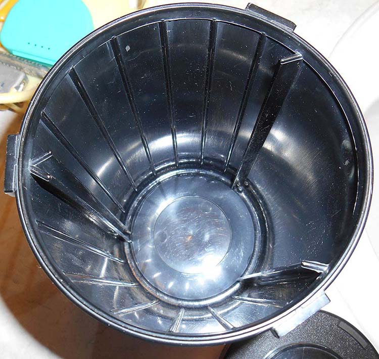

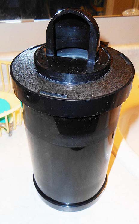

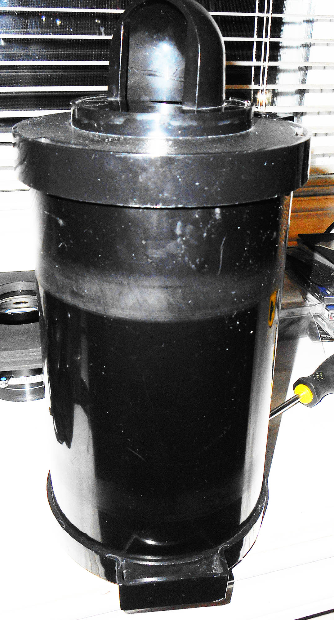

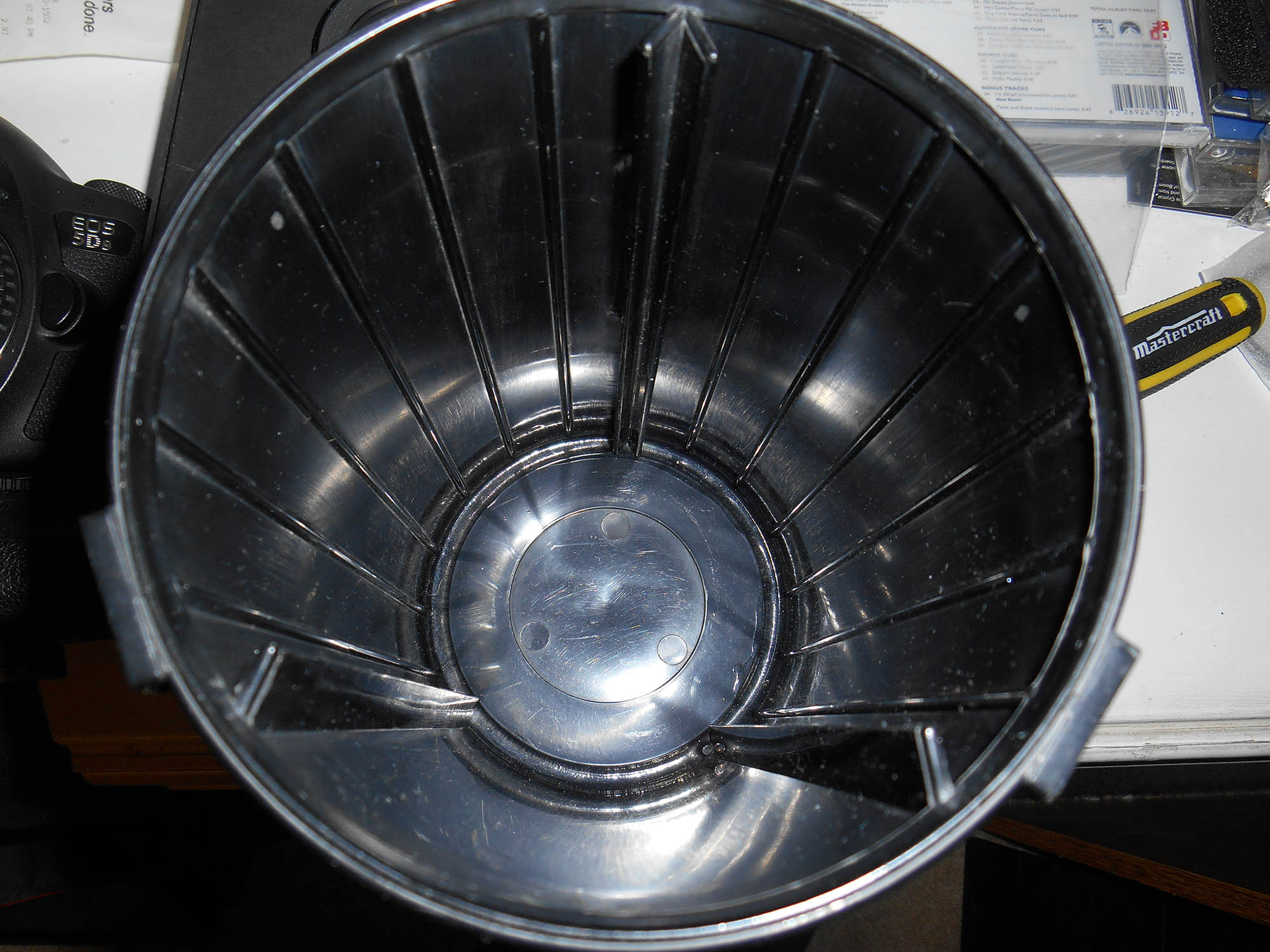

Looking at the pictures of mine, I would assume this tank only holds one sheet of film per development? It only fits in horizontally, and by that method, it looks like only one sheet will fit.
What is the method to developing the film with this drum? How much fluid do I fill it with? I assume you have to keep rolling it during the entire time? The gasket on the lid is a little deformed. Is it still possible to get replacements for it new?

If you load film in the tank use the sections with ribs as they will allow chemicals to both sides of the film. Load with the emulsion toward the center of the tank.
Continuous agitation for color films can be one direction rotation but B&W will require reversing direction at intervals so that an equal number of turns are achieved during the development stage. I use JOBO 25xx with a manual rotary base and reverse direction every minute.
What is the diameter of the tank and what is the distance between the 3 large ribs?

You can develop film, they were designed for amateur color printing in the 70's and 80's. As long as you don't have a temperature issue. Unicolor sold a nice roller that would go back and forth, this avoids streaks. I've used for single sheets of 8x10 film. The gaskets are something you will have to find. They stopped production years ago.

I've used Unicolor drums with the roller base exclusively for my LF film development for ten years or more. They come in several sizes, but the smallest one is the most useful. You can do four 4x5 sheets or two 5x7 sheets or one 8x10. (If you do 4x5 you'll want a little rubber separator to keep the sheets apart--it slides onto the v-shaped standoff in the middle.) They're economical too--you only need 300ml of chemistry. I've never had a problem with coverage and I've found that a minute or so of hot water before the developer warms the drum nicely in a cool room. I always do one-shot developing when processing b&w; I reuse C-41 developer for color work. I should say that I tend to prefer HC-110, R09 and Unicolor or FPP C-41 chems. I haven't experimented with many other developers or processes in these drums, but for conventional sheet-film development they're excellent.

I use 8x10 size Unicolor drums for processing my sheet film. I can run 4-4x5's or 2-5x7's at a time, and obviously only one 8x10. I run them on a self reversing motor base, very handy.
