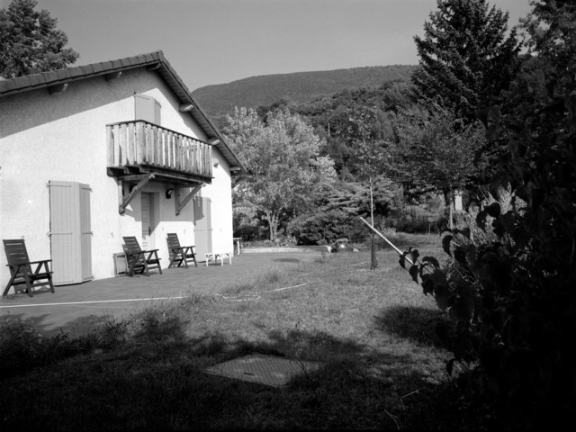

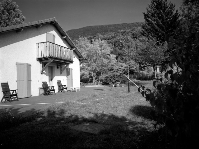

I am about to take some Rollei Infrared "400" (==Aviphot 200) with on vacation, and made some tests beforehand. I found this post
interesting (among other interesting suggestions in the same long thread) because it showed actual pictures with vegetation, sky, and clouds...
So I made myself some metaborate, then some Barry Thorton 2-Bath developer, and exposed some '645' frames 2 days ago. As I was about to proceed with developing, I noticed nice cumulus in the sky that had been blue for days (remember Aviator, when Howard Hughes is desperately waiting for "interesting" skies?) So I shot an extra 2 frames.
Exposures
What I label "Base" exposure was obtained by setting my Sekonic 308 to 100ISO, and measuring incident light from the sun. 125/11+ is my shorthand for 1/125s, f/11 closed down 1/2 stop (halfway to f/16)
1 <no filter> "Base" exposure 125/11+
2 <no filter> Base + 1 60/11+
3 Orange filter Heliopan Base + 1 60/11+
4 Orange filter Heliopan Base + 2 60/8+
5 IR filter B+W 092 Base + 4 30/5.6+
6 IR filter B+W 092 Base + 5 15/5.6+
7 Orange filter Heliopan Base + 2 60/8+
8 IR filter B+W 092 Base + 4 30/5.6+
Note that frame #5 exposure corresponds to dialing 6 ISO on the hand-held meter. Fully equivalent to
have generally incident metered at 400 iso and added 6 stops
where the "400" is just nominal, or fictional, or Rollei marketing.
Also note that with the orange filter I increased the exposure by 1 or 2 stops, definitely not the three stops engraved on the filter rim. I had already noted that with FP4 (real panchro, but not IR) 2 stops over was often too much.
Results
The film was developed in Barry Thornton's 2 bath 4+4 mins, 20.5°C. Details see

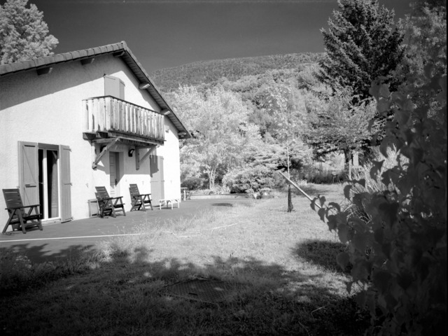

Frame 1 <no filter> "Base" exposure
Frame 2 <no filter> Base + 1

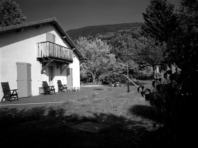

Frame 3 Orange filter Base + 1
Frame 4 Orange filter Base + 2

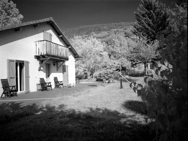

Frame 5 IR B+W 092 Base + 4
Frame 6 IR B+W 092 Base + 5
Interim conclusions.
  • For filterless exposure, 100 ISO, incident metering seems OK if there are no important shadow details to be preserved.
  • For orange filter, +1EV is appropriate with this film
  • For B+W 092 filter, +4EV (ISO 6 on hand held meter) is appropriate
  • Disclaimer: Snow or beach scenes may need less exposure

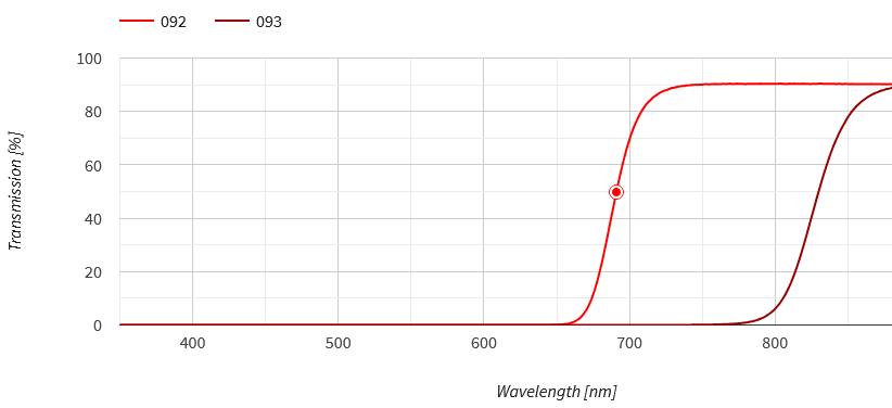

Appendix : transmission curve of B+W 092, nominally 695nm cutoff

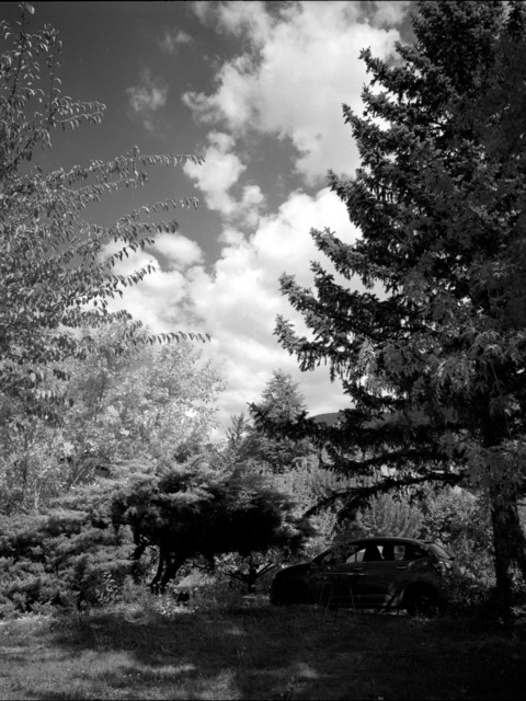

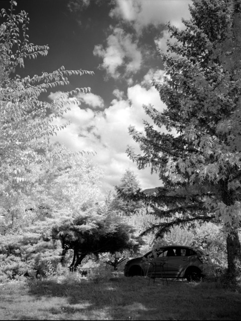

Extra exposures with clouds (and foliage)
Frame 7 Orange filter Base + 2 (should have chosen +1)
Frame 8 B+W 092 Base + 4
See how open shadows are more "open" with the IR filter than with the orange filter. Caution: that might be true only with clouds in the sky, not under pure blue sky.

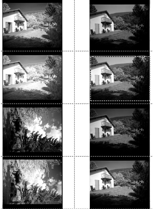

An overview of the 8 frames from the Preview screen of vuescan, intended to show the relative darkness/lightness of frames, without the individual auto-adjustment of black and white points (1% and 0.5% of histogram, respectively). Consecutive frames are top to bottom and right to left
