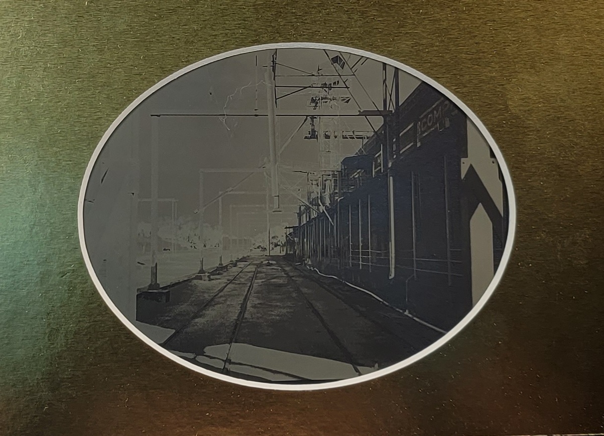

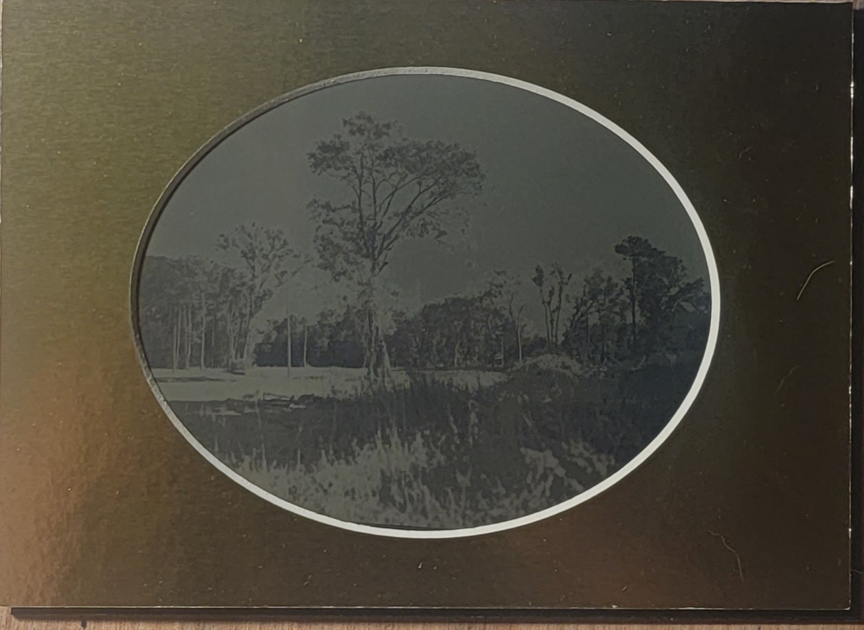

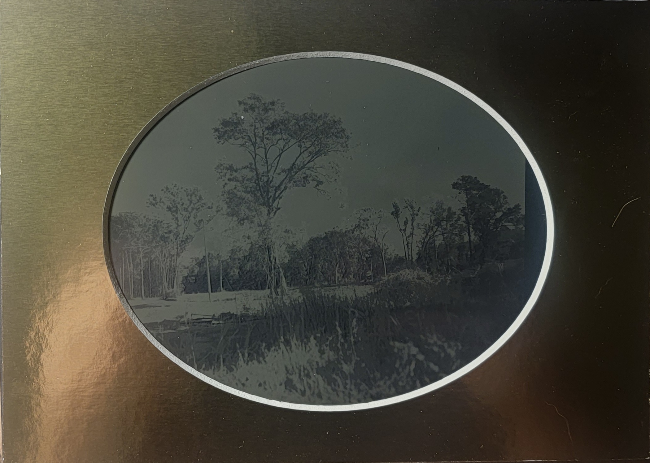

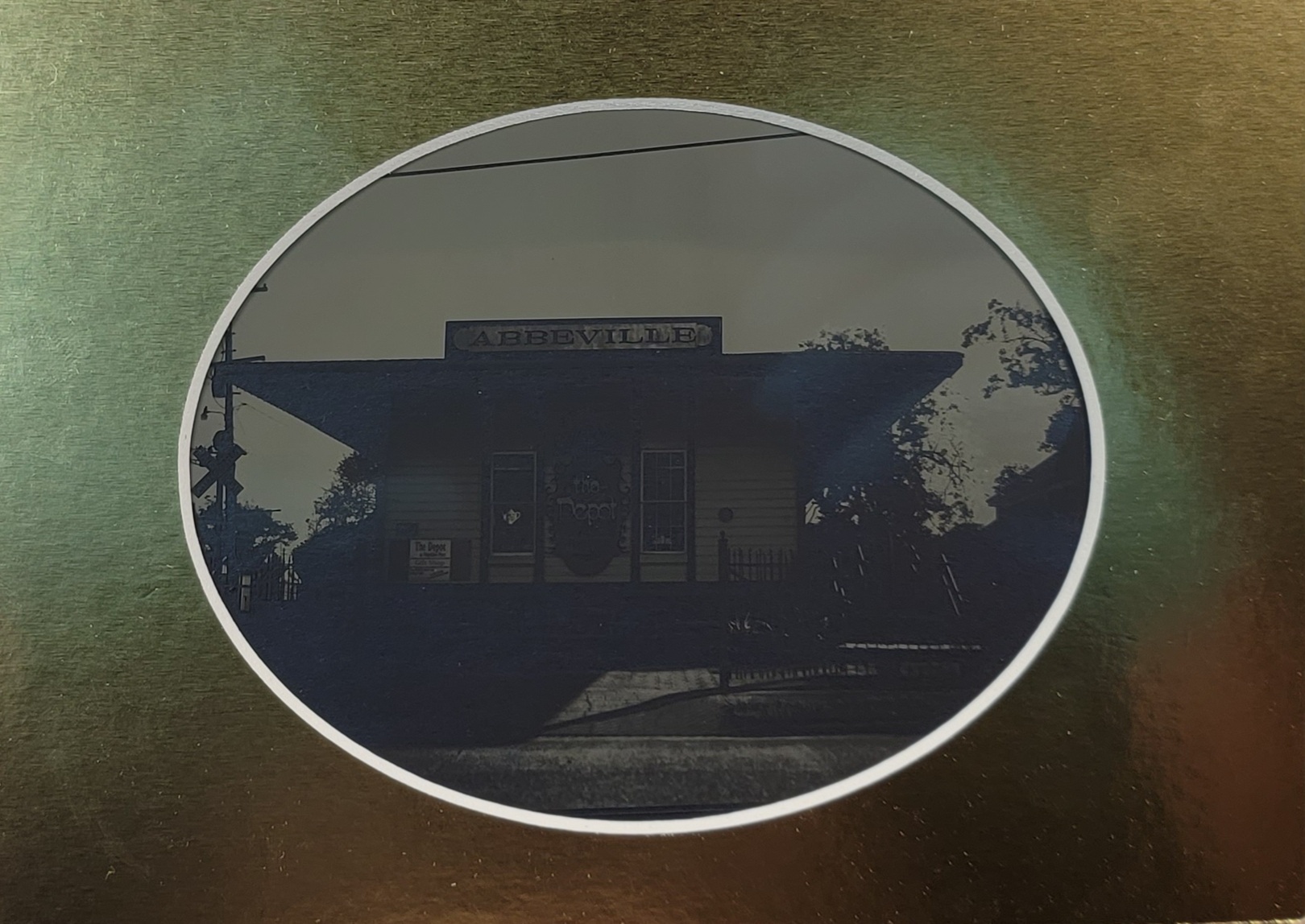

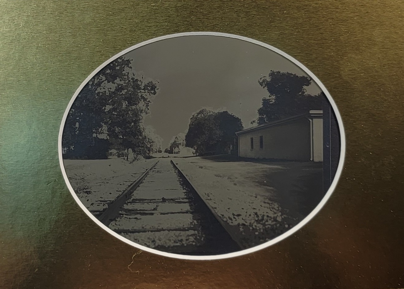

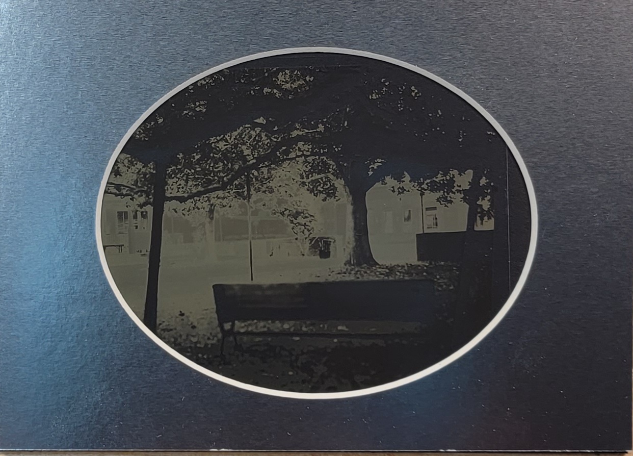

So I know... from what I read ortho lith is notorious fickle. Ive been using a crown graflex and a dark yellow filter, treating it like ISO 1 or 2. I feel like this is helping me start getting more sky detail. Anywho.
The recipe calls for 18 mins in hc110 1+200, 18 min, slight sloshing every 3 mins.
Im using the taco method, L110 (a sort of HC110 clone) 5 ml to 1L, phased out the sloshing, except for a slosh at 9 mins.
Should I start experimenting with shortening my development time? I know the film is super contrasty, but based on this photos below (over black mat) are they over developed?
I know tray developing would let me see the process, but no darkroom available at this moment.

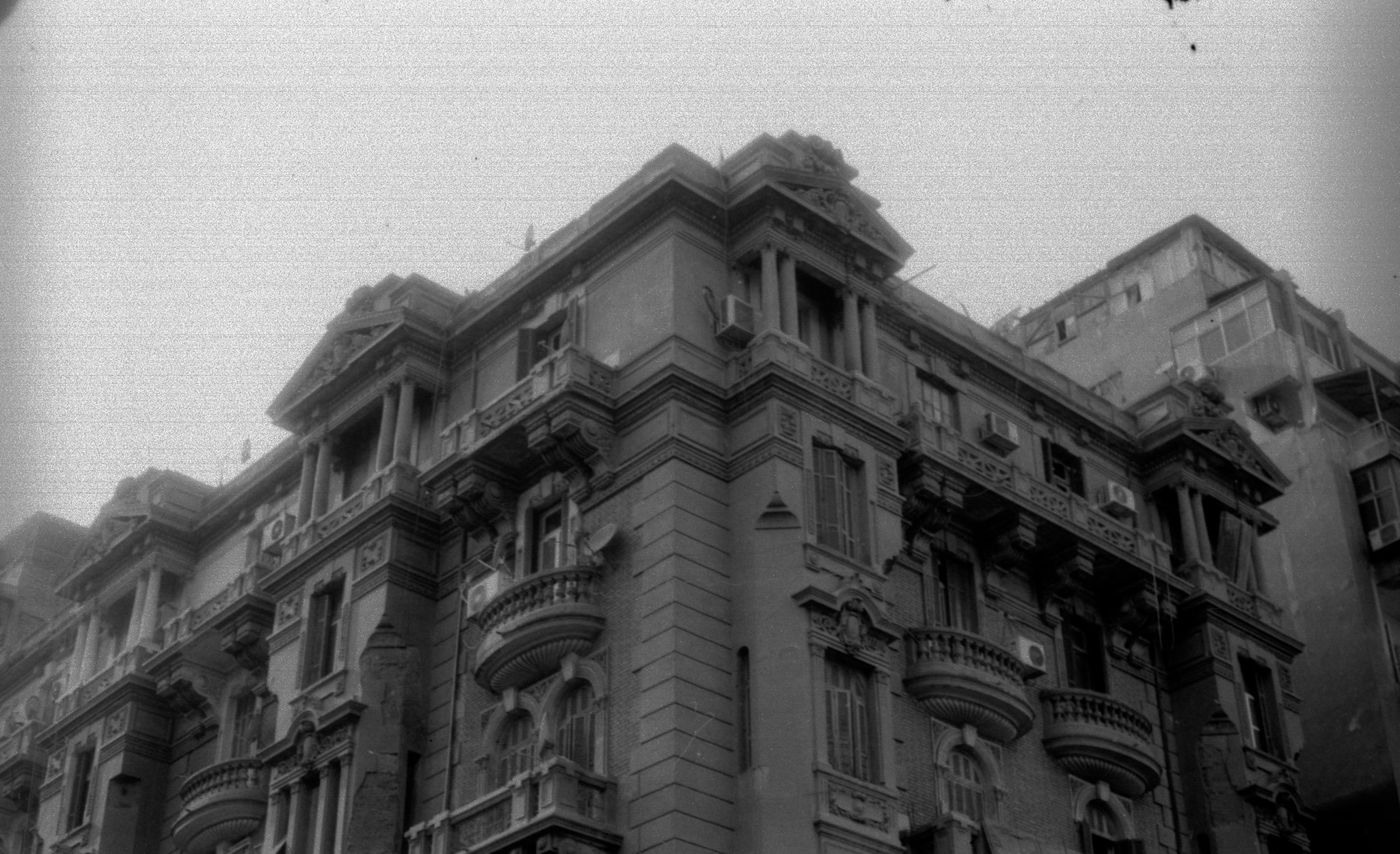

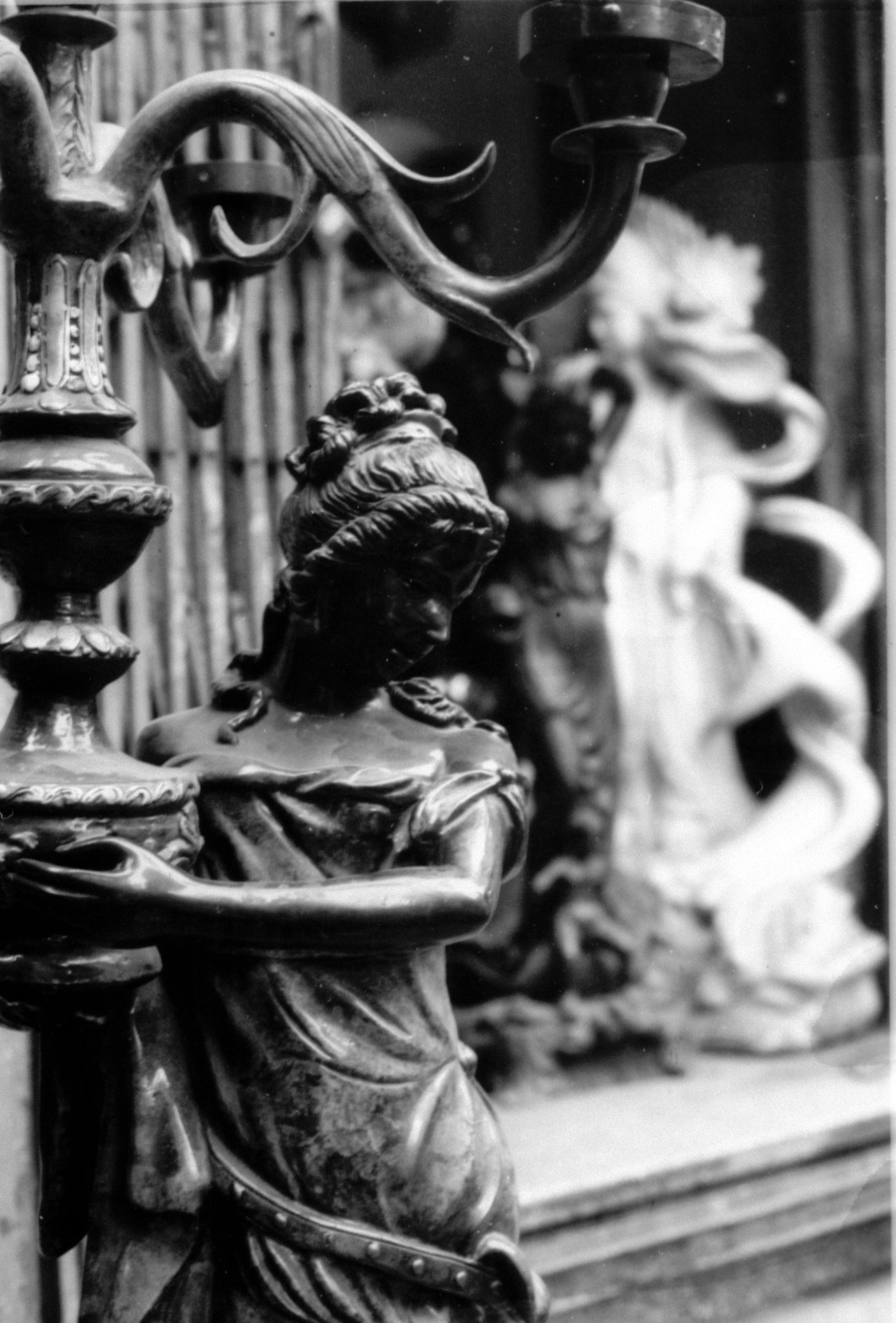

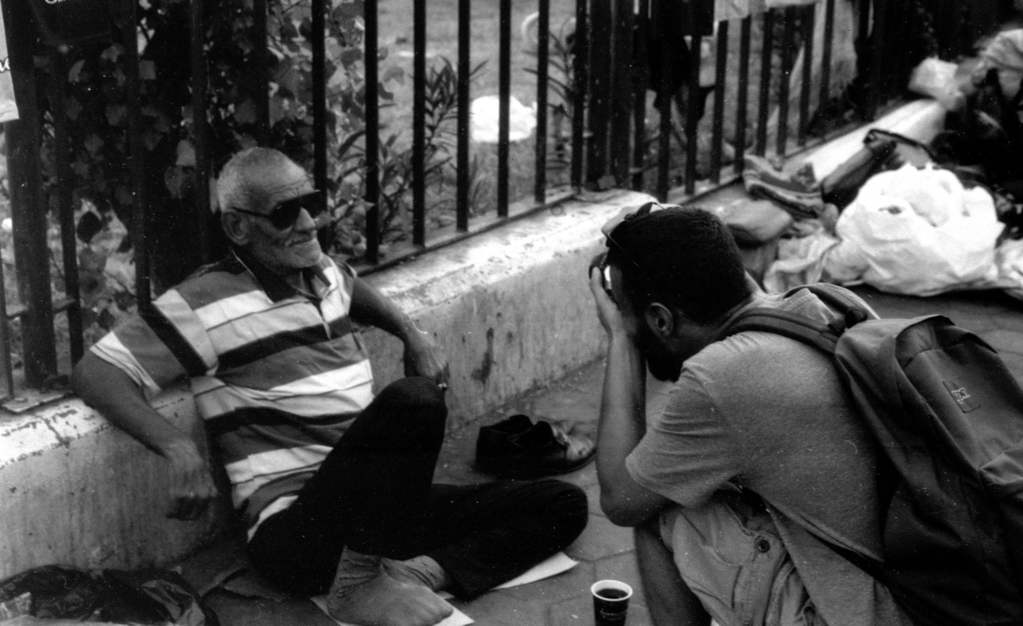

Hi, I have absolutely no experience with this type of film.
I had posted an announcement in the Egyptian analogue photography community that any beginner photographer who succeeds in buying a development tank, I will give him a black and white chemistry sample as a gift,,
He came (a young amateur photographer who is a beginner). He managed to buy a small development tank and came to me happy and brought this tank with him so that I could see it,,
I gave him a small sample from the developer (Kalogen) along with a similar amount of (Fixer), as a kind of gratification for him.
- After a few weeks, I found this young man who published these pictures and wrote in the post phrases in which he thanked me and praised me, and it turned out that the movie is of the type (ORTHO) you are talking about, and he said that he found it by chance and did not know what it was The difference between (ORTHO) and (PAN)
But in the end he got these good pictures.
He soaked the film in distilled water first for 10 minutes.
Dilution ratio 1:100
13 minutes
18°C - Semi-continuous agitation
Developer ( Kalogen )
According to my opinion and according to my point of view which is of no value.
ORTHO movies don't like a five-star developer like HC110 or Rodinal, I guess there's no common understanding between that emulsion and those fancy developers.
I think he prefers only cheap and poor developers.
A poor man does not like to marry a rich woman, there will be no mutual understanding between them.
(I like literary similes sometimes.)

Awesome! Thank you for your response. Im not familiar with other developer, but I have read that people have tried dektol, a paper developer, to moderate success. If i get another developer.. maybe ilford multigrade paper liquid may be the way to experiment?
(Ill look up the one you mentioned and see if its available in the US)

Dektol gives miserable results, unless you deliberately want a blotchy funky look. I've had way better luck with HC-110 diluted 1:7 from stock (which itself is 1:3 from concentrate). Don't know about the very latest version of HC-110. Better yet, use an ordinary pan film! Ortho Litho is a headache for con-tone imaging.
What use is a yellow filter? It's not going to differentiate much, and will mostly just yield longer exposure netural density because otho litho is only blue and green sensitive (about 75% blue sensitive, and 25% green). If you're trying to bring out white clouds against a blue sky, you'd be better off using a deep green filter.

Yup yup its a total headache.. but is there a panchromatic film I can display like an ambrotype?

Why not use the ortho film without a yellow filter? +1 as Drew says, The early plates recorded little to no sky detail.
I use Ilford Ortho, develop it in ID 11 1:1. nit sure if it has the ambrotype look, or could have it, but it is easy to work with.

You can try keep cutting development time - do a sequence of 5, 10, 15 mins and see what happens.
Then you can try cutting dilution and repeating sequence
But I think you are probably just better getting Ilford ortho if you want ortho film. Lot easier than trying to get pictorial contrast out of lith film.
Sounds good. Ill remove the filter. Should I bother fiddling with a green filter?
Ill have to look up ilford ortho. Hopefully the make it to fit 4x5 holders
I did a 9 min, 12 min, 15 min last night. I like the 12 and 15. Here they are below

Those examples above don't look like con-tone images at all. An ordinary A&B lith developer could have been used for that kind of look, if that is what you're after.
Do you think I am possibly overdeveloping or underdeveloping?

Yes, Ilford makes it in 4 by 5 (that's what I mostly use). It is hard to get sometimes though, because I think Ilford only makes a run every two years. There seems to be plenty around now.

Hi, I've pretty much written a small book on this topic. See here: https://grainy.vision/blog/ortho-litho-reference
Uneven development is a huge risk with this film, especially with sheet film. Good luck and feel free to ask any question, though I haven't messed with ortho litho very much for in-camera usage in over a year now

Also yes. Here is my best example of this. Exposed in darkroom from slide film, and developed lith printing style probably using a custom developer. It's hard to get a print like this with bright highlights and normal contrast. Also note the actual negative over a lightpad is orange, but when placed over a black sheet will cause an inversion, including that orange color to change to the blue seen here. I did not do any toning
edit: for in camera usage, the biggest problem with lith printing is that it requires a lot of exposure. An image like this would probably require shooting at 0.1 or even slower ISO, with no filtration
