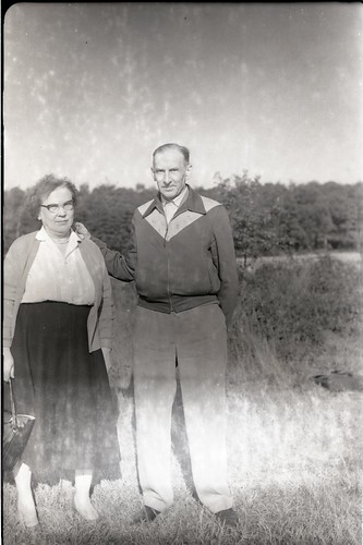

Some years ago I bought an old camera with an exposed roll of Isopan F in it. After researching the subject, I found a recommendation from a German photographer to develop in HC-110 dil. H for 13 minutes. The images I got were OK, and I guessed from the clothing that they were exposed in the late 1950s or early 1960s. I might have got better results with additional chemistry (or a different developer) but I was pretty happy with the images I got:
img637f by terry, on Flickr

This is beautiful! I don’t mind imperfections , mostly looking for the content. Thank you!

Yes, that example is remarkably good,. There is quite some "mottling" due to film-paper interaction, but no fogging as I expected.

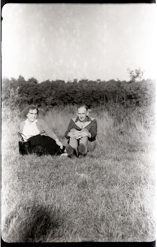

One of the frames that was closer to the spindle of the takeup spool (ie, less exposed to light/air/moisture) came out rather well
img638f by terry, on Flickr

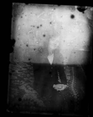

I might suggest that you sacrifice a corner of the roll and do a test before developing the whole roll. You may find that the film has survived well; most black and white films will give you some sort of image even 50 years after they were exposed. I've shot and developed Tri-X from 1972 in 2012. Here's an image from a sheet of some Soviet film in a Fotokor camera I bought on ebay, stand developed in Rodinal 1+100. I've had a lot of fun with found films.
Found in a Fotokor 3 by terry, on Flickr
