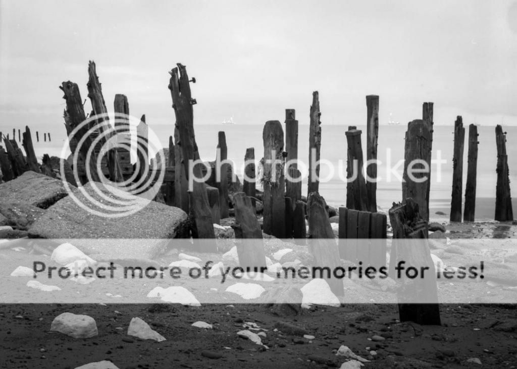

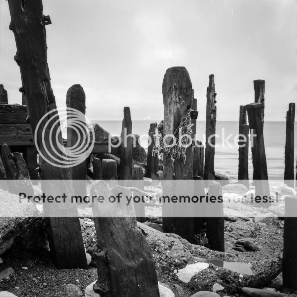

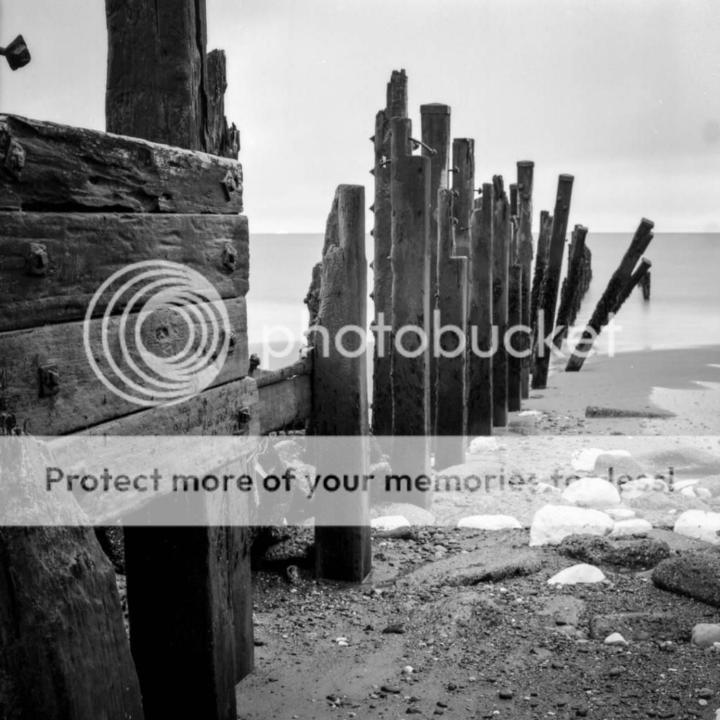

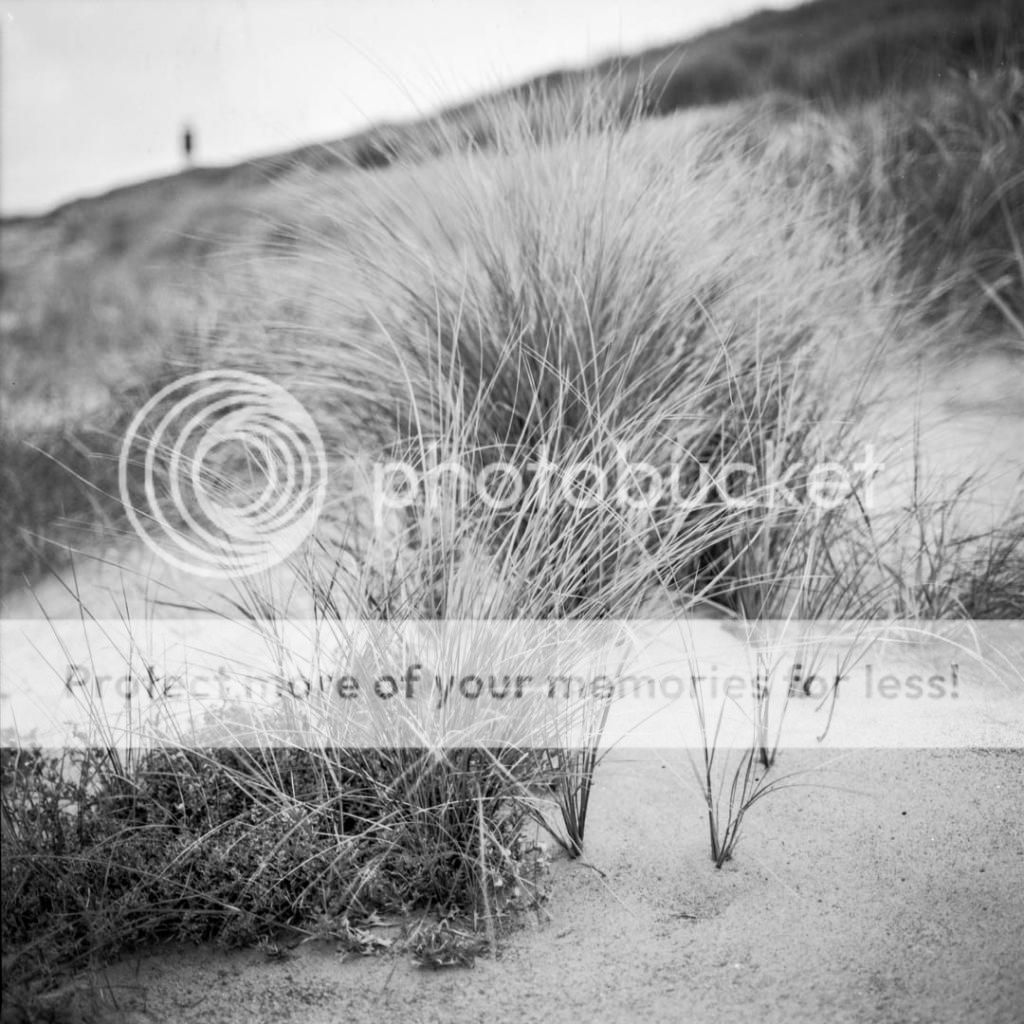

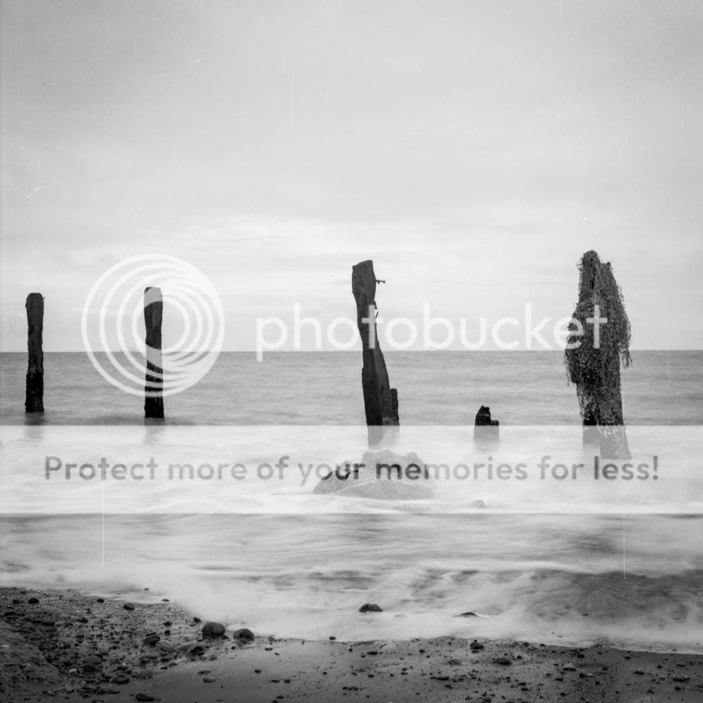

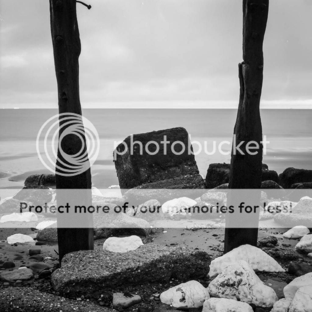

So I tried it at 7.5 min with some good results.
Soak
1+20 7.5min. Adgitate 60sec and then 10 sec every min.
stop/fix/rinse.
Scanned negs (sorry) with minimal PP.
These were all taken at twilight at Spurn Point on the Humber East-Yorkshire.
Their not all great. I'm definitely under exposing some of them and the scanner really dosent like that.

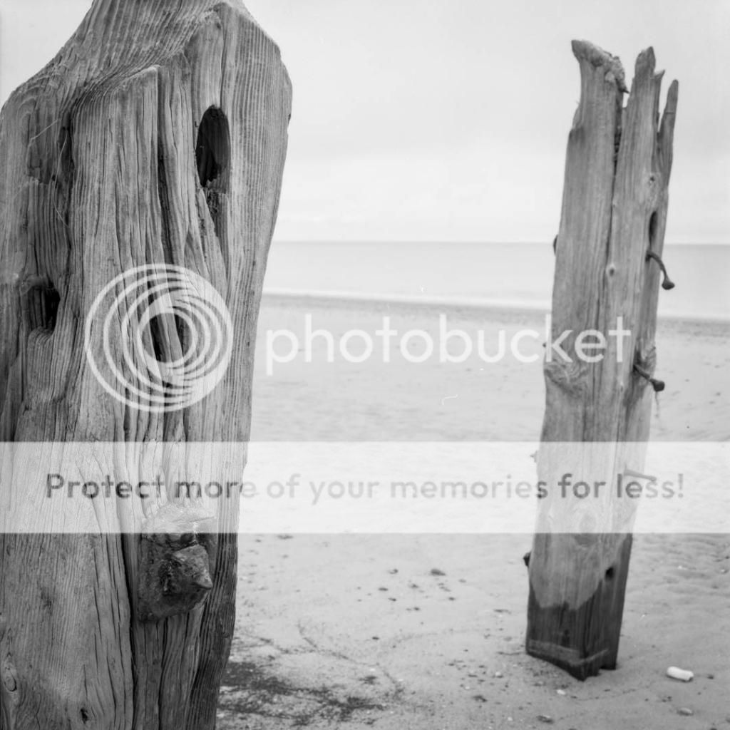

I really like these. Were they made using your Bronica? Did you use a filter such as yellow or orange? I have only used Acros 100 in 35mm, but will be trying it in 120 now.
Alex.
Xtol Replenished, 24 degrees, 6 minutes.
6x7cm (SFW adjustments made :tongue:)
crop

These all need a little more snap, IMHO, and that is going to be difficult given that you're running out of shadow detail on a few. So yes, more exposure is warranted in the future. Even so, I would pump up the contrast on all of them and then add selective burning on the skies if they become too hot as a result.
