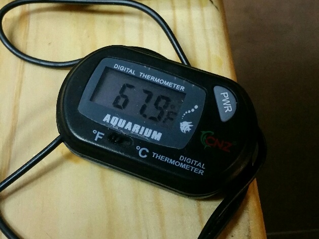

One advantage to living in Iowa
Saturday it was about 90F outdoors, AC set at 75F,
Darkroom water bath see picture. In summer Darkroom is always 66 to 70F. However, if I turn on my Ilford 20" RC print dryer that's a different story. Also even with AC I run a dehumidifier all through warm months. In the winter, solutions are usually about 60 F before I warm them up. Cold tap water summer 58-60, winter 45 to 50F.
Best Mike
