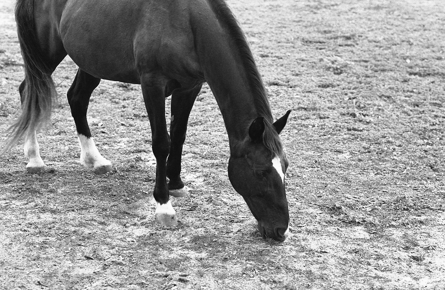

I always used a stop bath. Then I ran out one day and used tap water, and the negs looked exactly the same. So, it's one less thing to deal with. D76 is not necessarily the sharpest developer, but to me it gives the most beautiful tones w/ Tri-X. T-max, HC 110, and Xtol I have never used, so not much help there. If you try Mic-X or Rodinal you can get quite a bit more sharpness that the D76 w/ your Tri-X, but whether or not that results in better negs is a hard call. Acufine will give you hyper sharp, almost grainless negs w/ Tri-X, but the look is a little odd, so I stopped doing that. It looked too digital, if you know what I mean. Well, this is what I mean. Too strangely sharp, and this was with a $40 flatbed scanner! If you click on the horse twice and use the magnifier, the hoofs look painted on because the edges are so sharp.

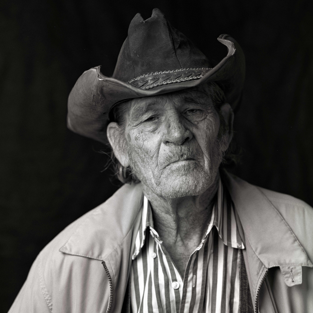

I'm a fan of Xtol 1:1 for portraits.
