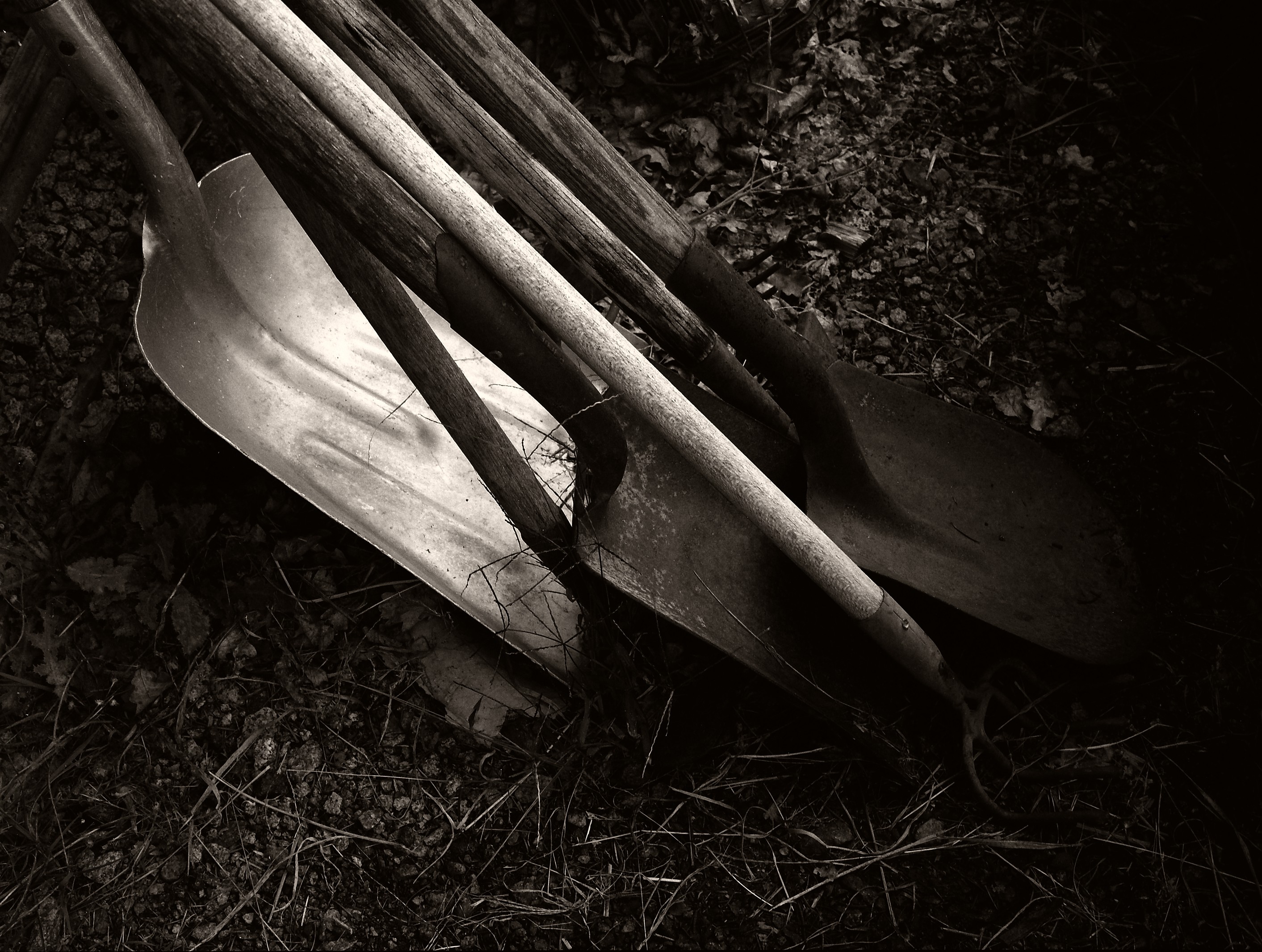

TMY and X-Tol is the best combination I've used in decades of black and white darkroom photography.
Perhaps it can be made to look like digital if you scan it - I don't tend to have that trouble with it.
Optically it is wonderfully flexible and amazingly capable.
You do have to really abuse it though to make 120 grainy. Even 135 isn't particularly grainy, unless you force it.
6x4.5 TMY developed in X-Tol and scanned using an old, relatively inexpensive flatbed scanner that I paid $100 for.
